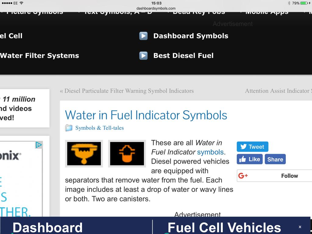

Was not either of those...it looked like an engine with a fan inside and wiggles for water under the fan! Made worse by the fact I had carefully stowed the manual in the back of the van so could not look in there either!
Sounds like water in fuel filter signal.on the bottom of fuel filter there's a tap to drain filter ,slacken off let it run out for a short period then retighten ,no bleeding of system required ,done with engine not running ,I will post sign and see if it is it
Water in fuel
Was this like itIMG_0335.jpg if it's this no probs to continue to drive it may go off on cornering etc
