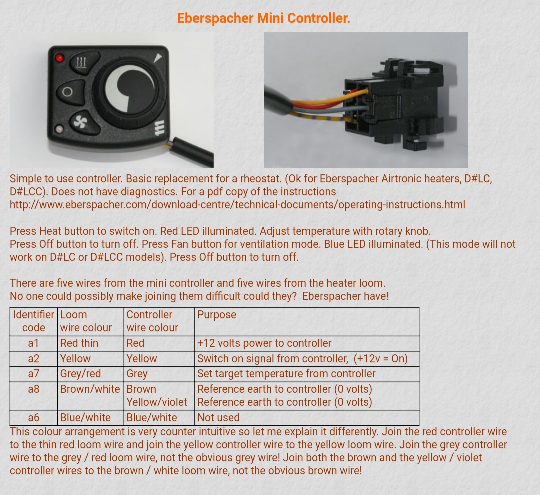

The chinese controller appears to have a 3 wire connection as againt the 4 wire eberspacher.

So now you want the pin outs from the controller your planning on using.
Looks like you just need 3 wires to start and stop it.

The Chinese Heaters are look-a-likies to the Eberspacher to fool people they are getting an Aitrtronic for under a hundred quid - the electronics are not interchangable.
There are also different looms for different controllers. The most common controller is the colourful LCD panels showing different functions of the heater but there are at least 4 other controllers, some of which can be swapped from one to the other, but a couple of others which cannot.
So my take on this would be:
a) no, they are not; and
b) why would you want to anyway?

Eberspachers purchased for stand alone installations don't care where they are installed. OEM installations are generally integrated into the climate control system and have a controller designed to suit the manufacturer. These often can't be removed and used as a stand alone device.
Just by the correct controller as long as it's not an OEM.
