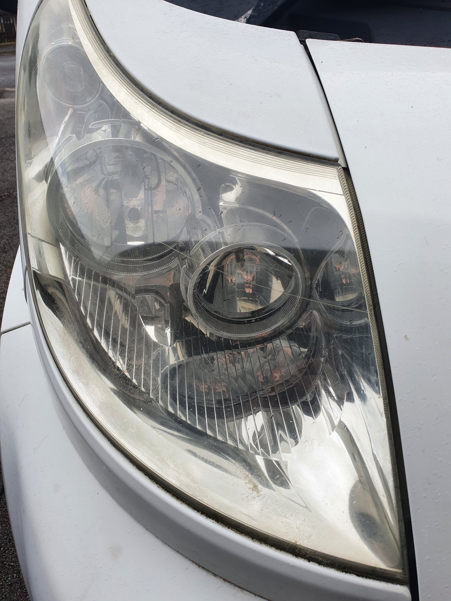

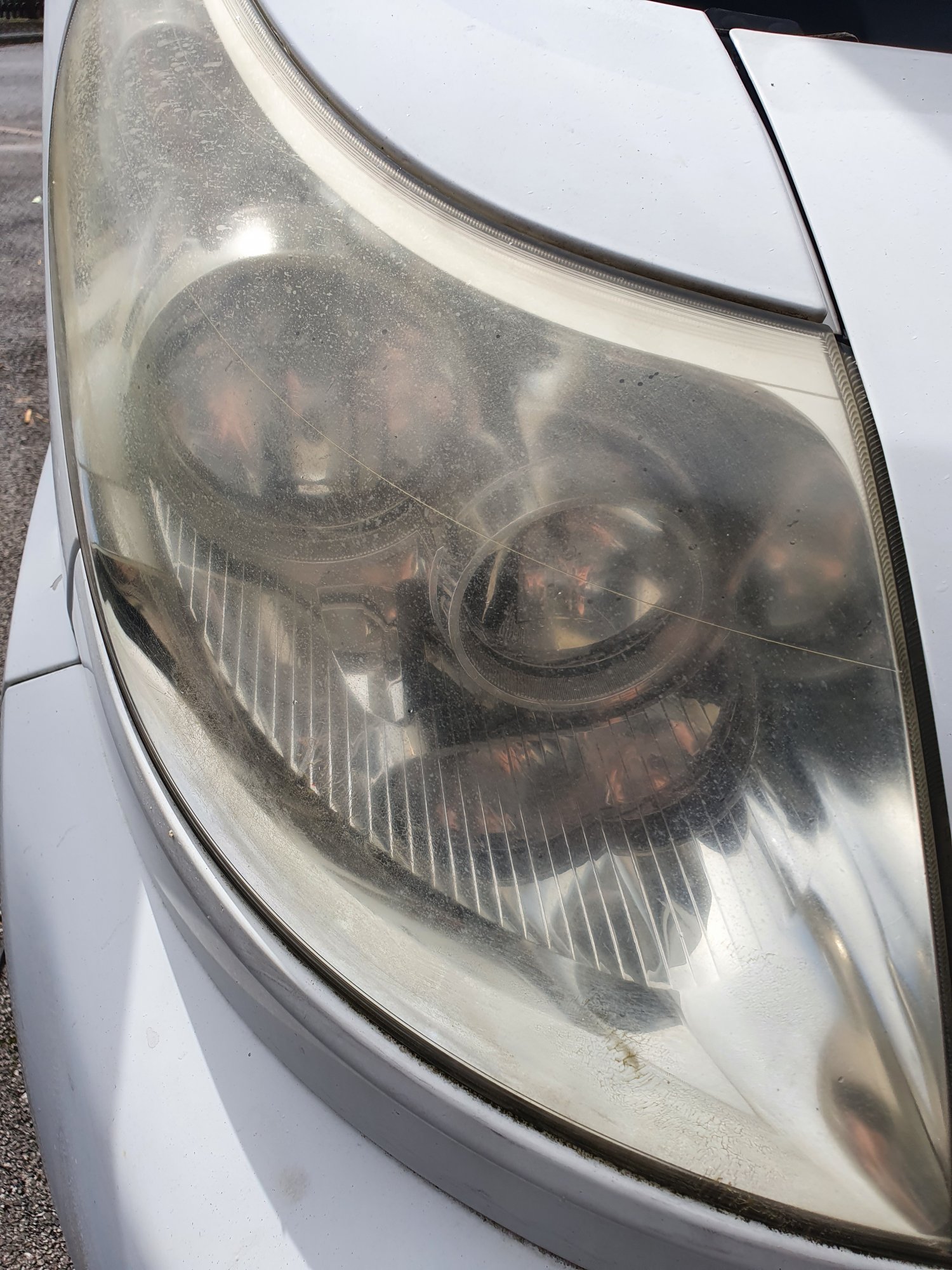

The sun came put so I had a go, but it started to rain hard so this is only 4 FOUR minutes work.
The 4 minutes included cleaning the lens, opening the tub and going to the tap to wet the cloth, and cleaning the lens with tissue afterwards so really only 2-3 minutes actually polishing it, no machines, no sanding etc.
WE can clearly see the differance, thank you for sheeding some light on the subject, shine on big boy.
