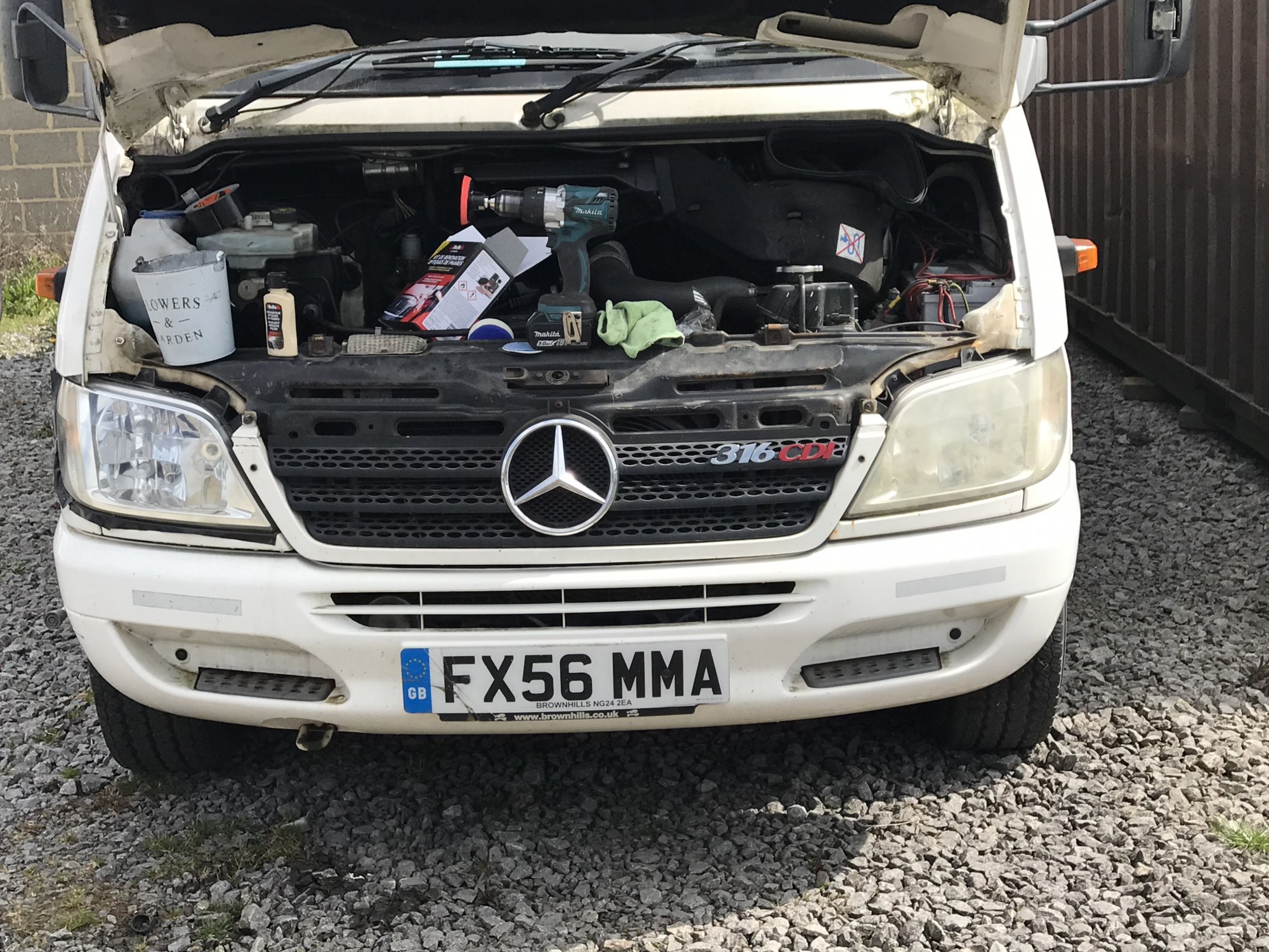

I posted on my 2023 "what have you planned" thread on Motorhomer my own headlight renovation
This is a before (left) and after (right) photo, using 3M perfect-it products and 3M plastic restorer and polish products
2008 Ducato Light Refurb
by David, on Flickr
