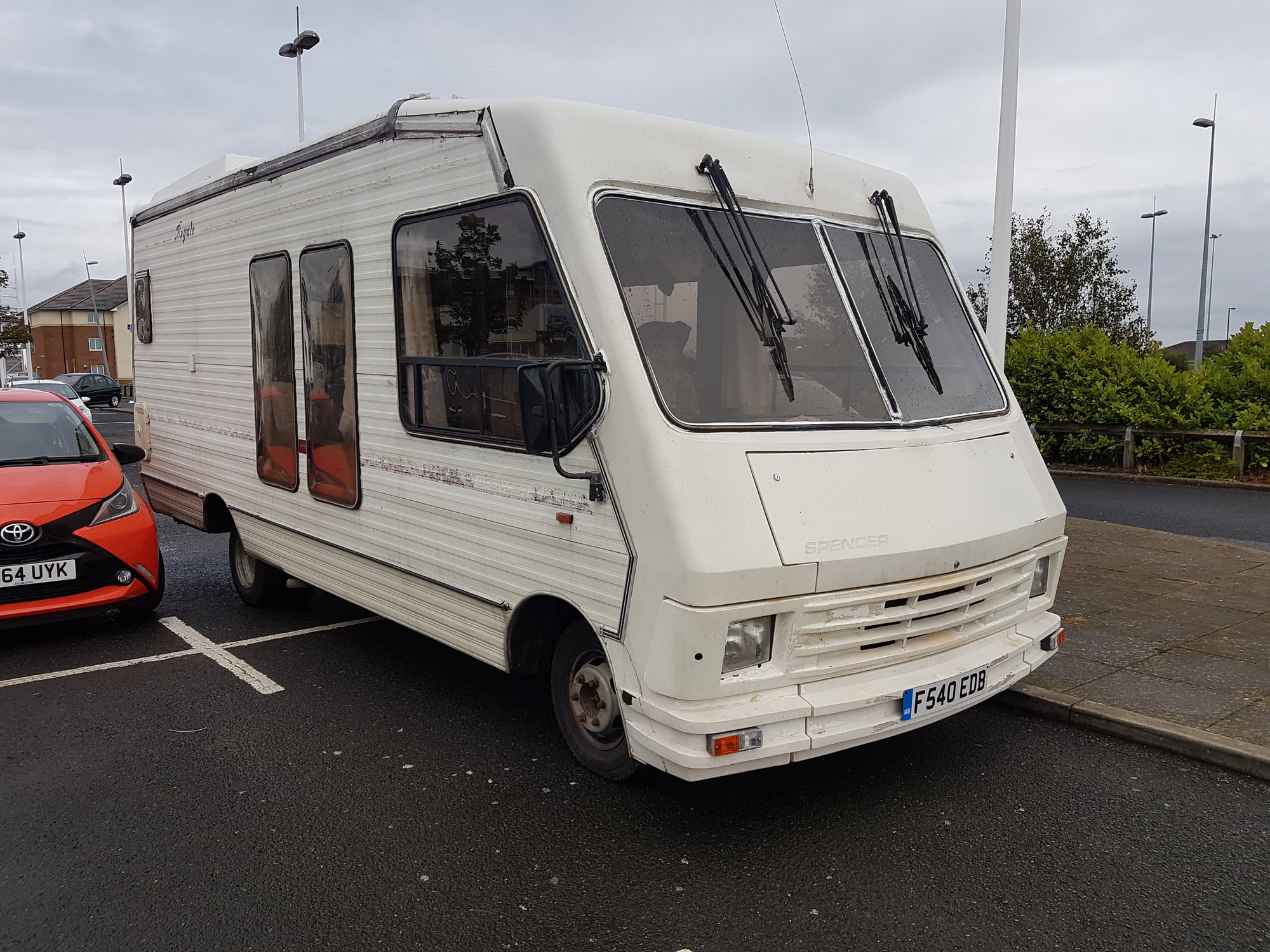

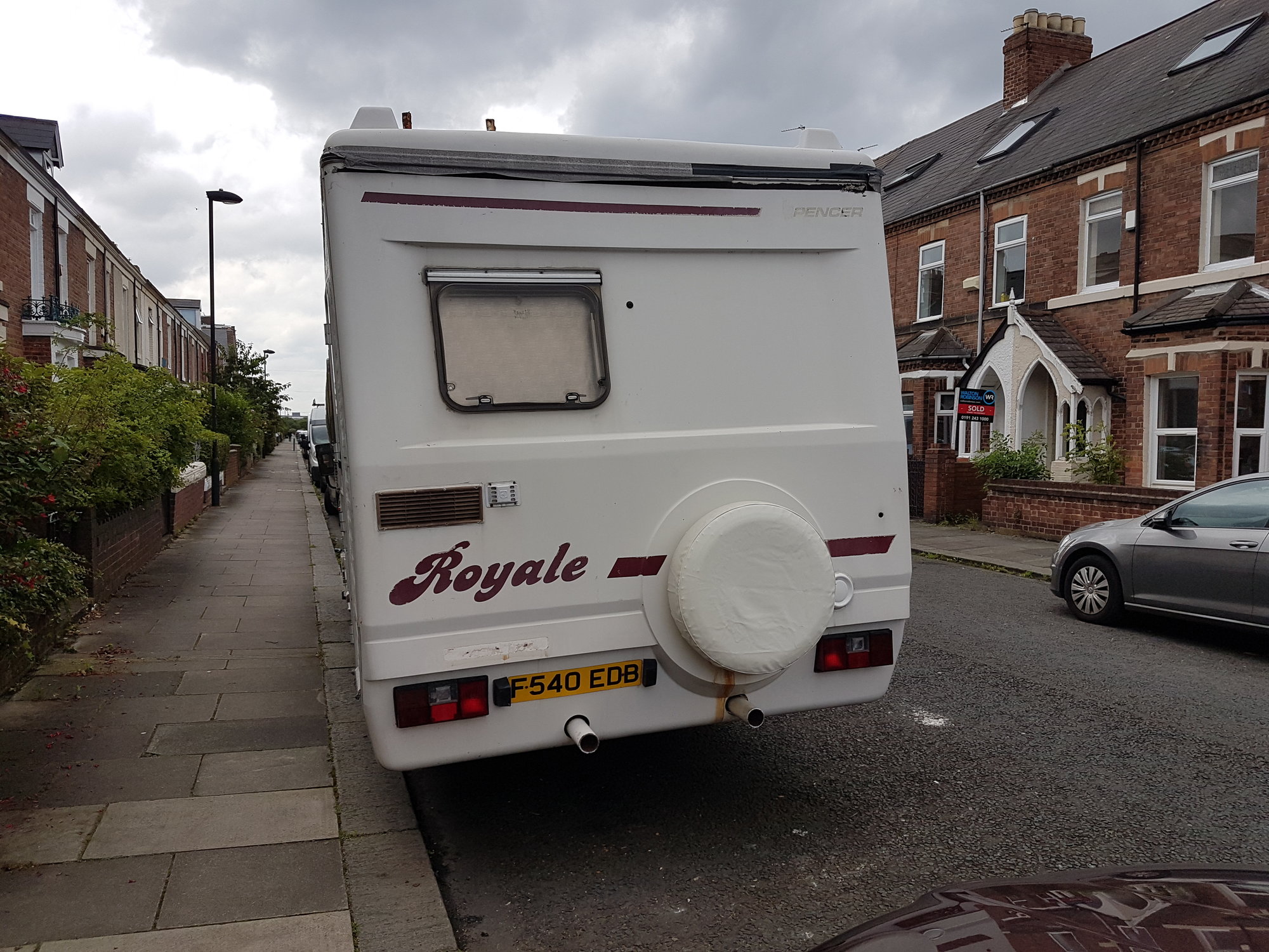

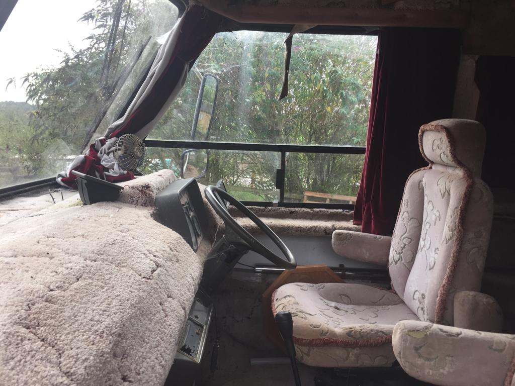

Does anyone else have a Spencer royale?

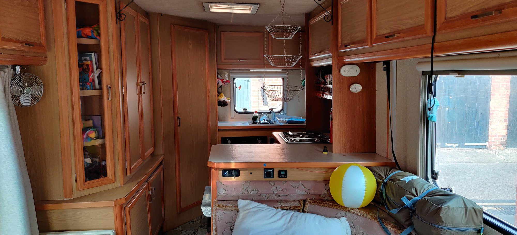

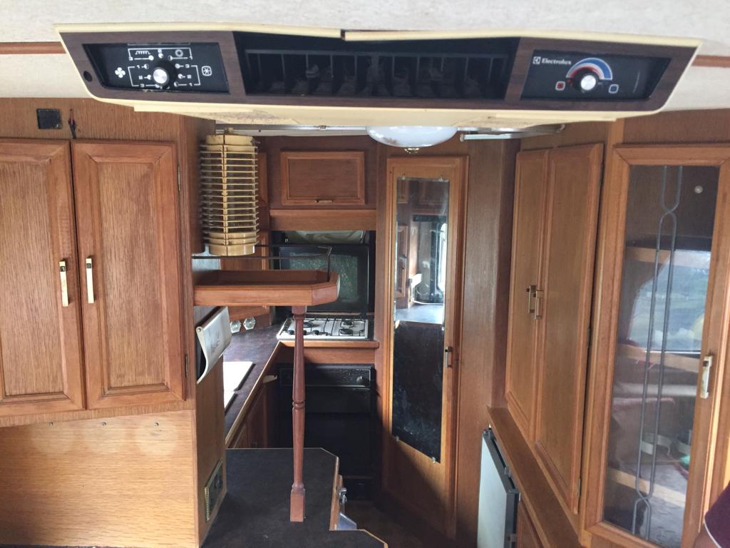

A few interior pics, I've tried to keep it as original as possible, keeping all the 80s fabric. There's some new additions here but hopefully they still look original.
Lovely looking camper. I would have that over some of the modern offerings no problem.

Hey fellow Spencer owner. Reckon we prob the only two in the country by the seems of it!!

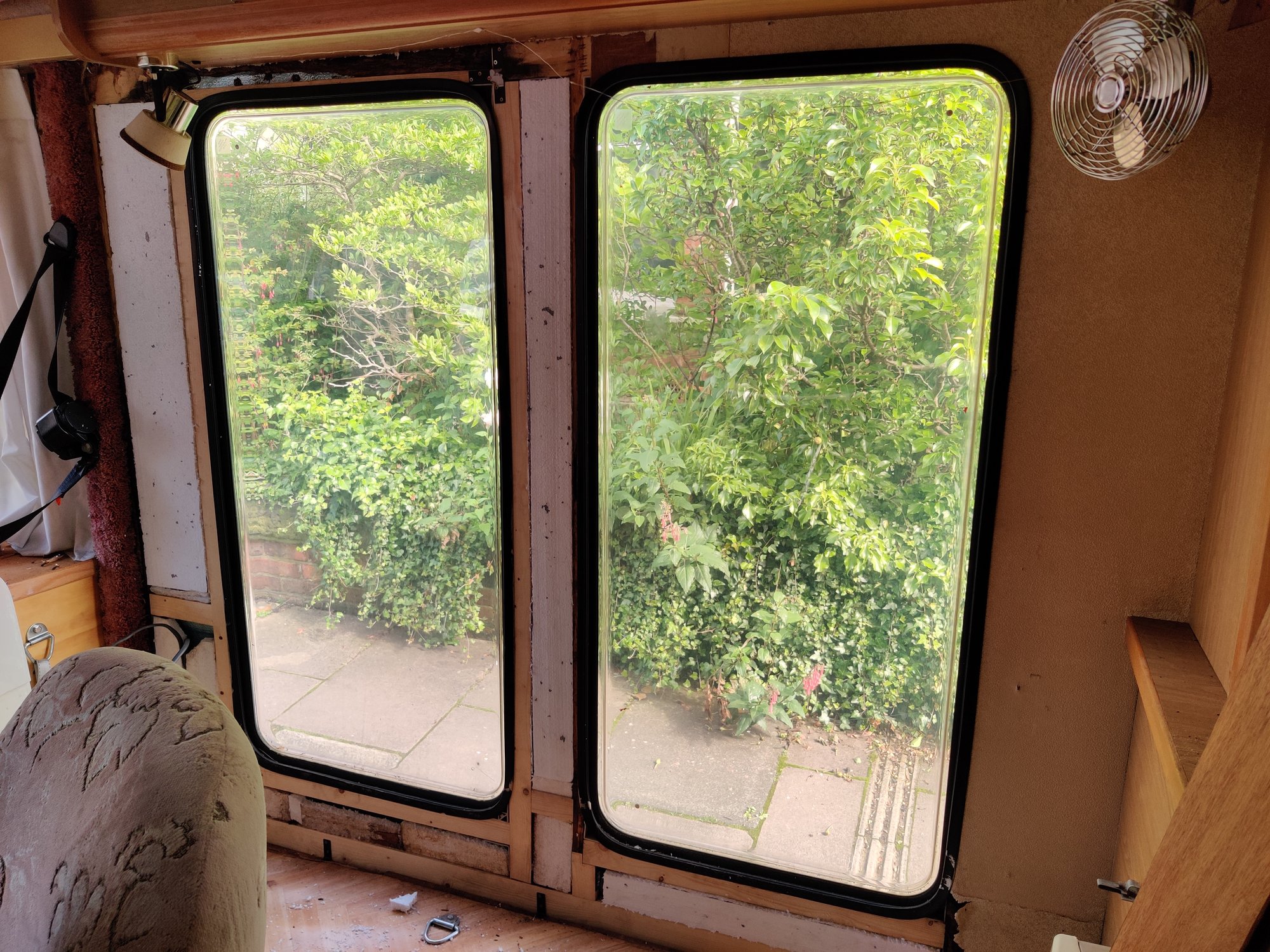

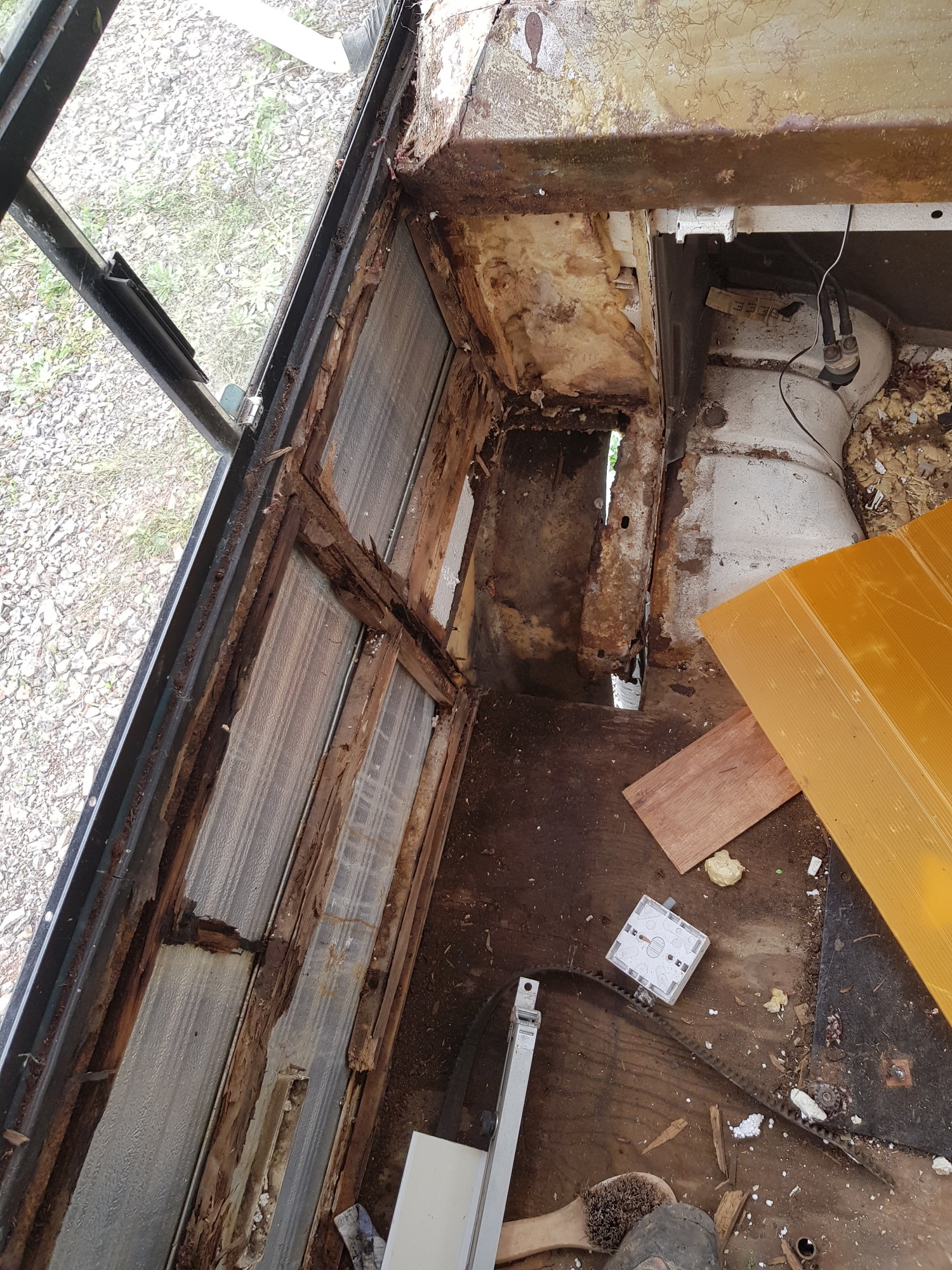

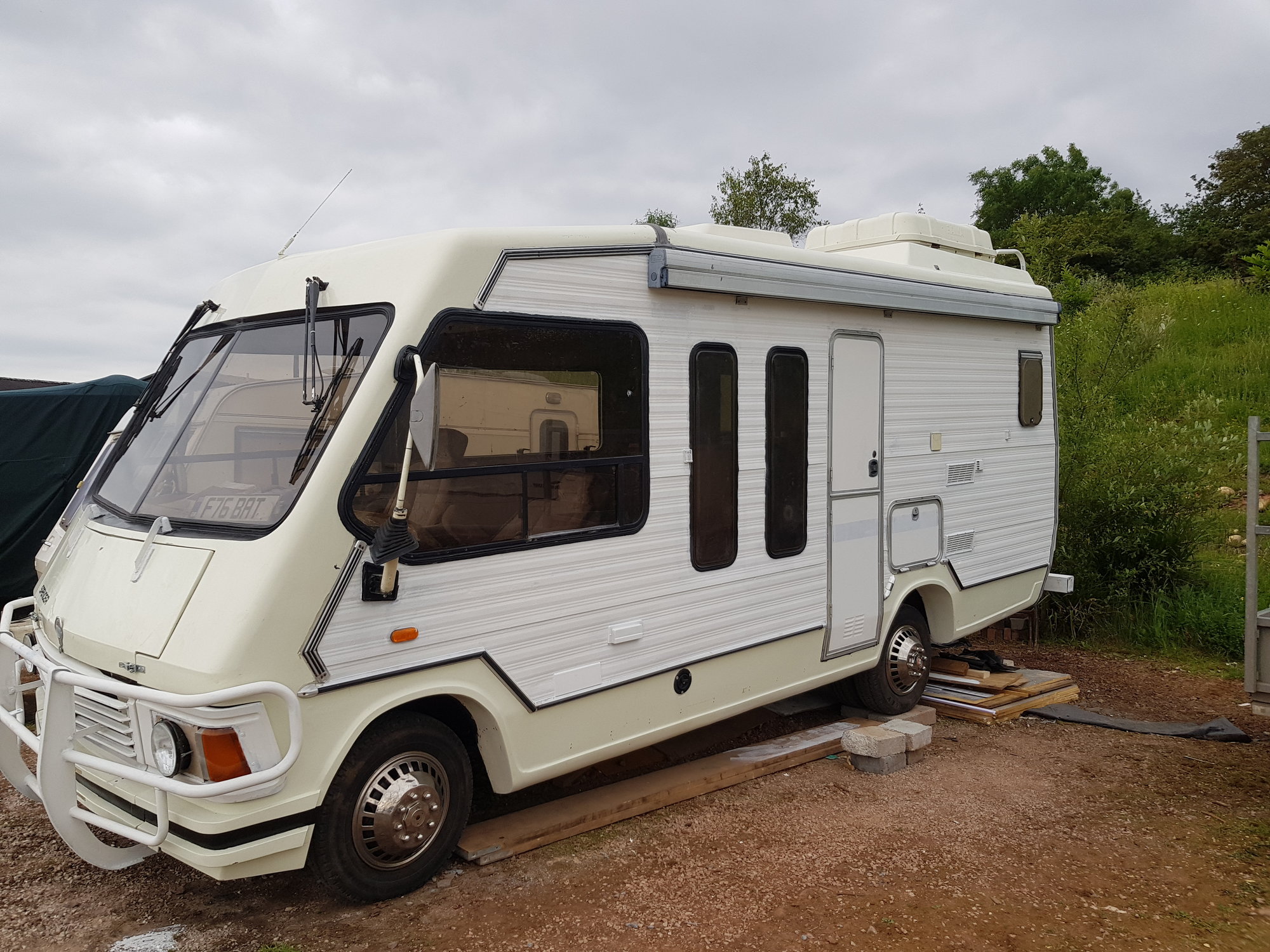

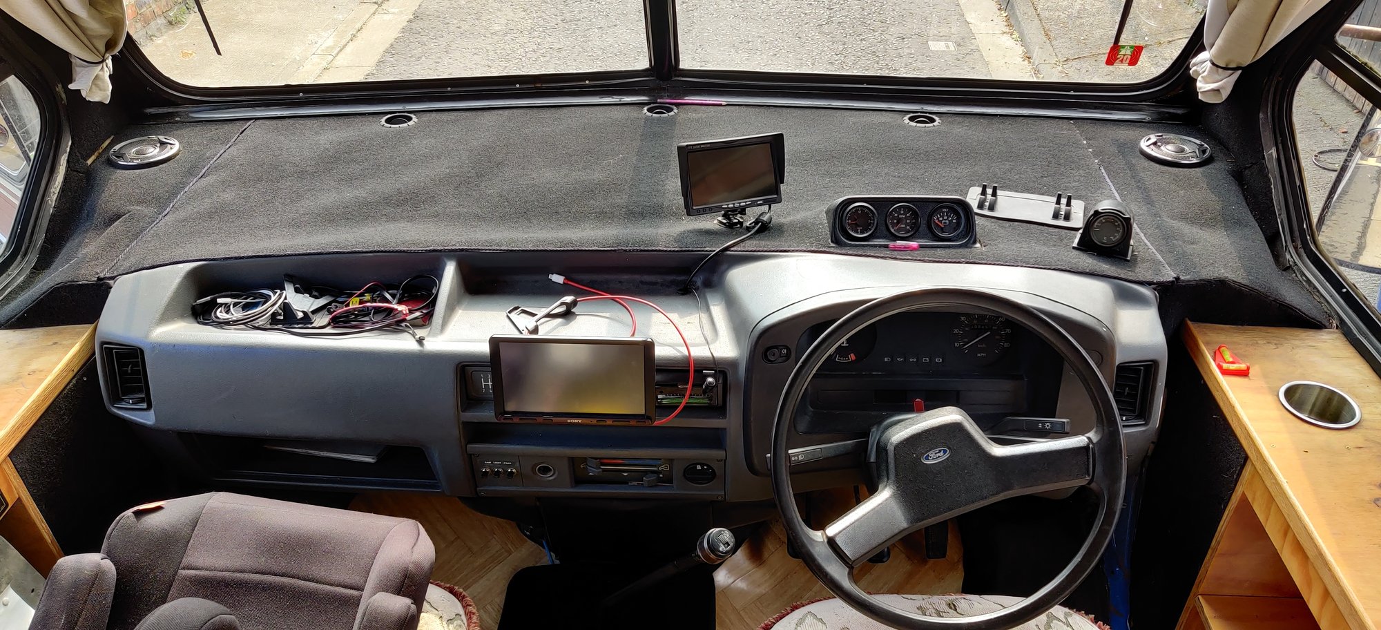

Mine coming on ok too, thanks. It's on an Iveco Daily 45.10 chassis. When I first aquired it it had more leaks than a Welsh allotment! Windscreen and aliminium trims were the bigest culprits! After thinking, for a few naive moments, that a bit of sealant here n there would do the trick I eventualy just had to bite the bullet n rip out n reinstall all the windows n door too. This wasnt too bad a job considering that upon inspection almost every panel of the walls needed the rotten woodwork to be replaced! If I had anticipated all of this I would have thought twice about buying it. However, now, I would not part with it for the world!! As it stands it is now watertight, roadworthy n has running hot n cold water... I also got all the solar panels n batteries etc all ready to go in when I next get the chance to give it some more love! Regarding the drop down bed I know what you mean! Have attached a few photos that should give an overview of what I've been through! Would love to see some more photos of yours, inside and out, as it looks very original.

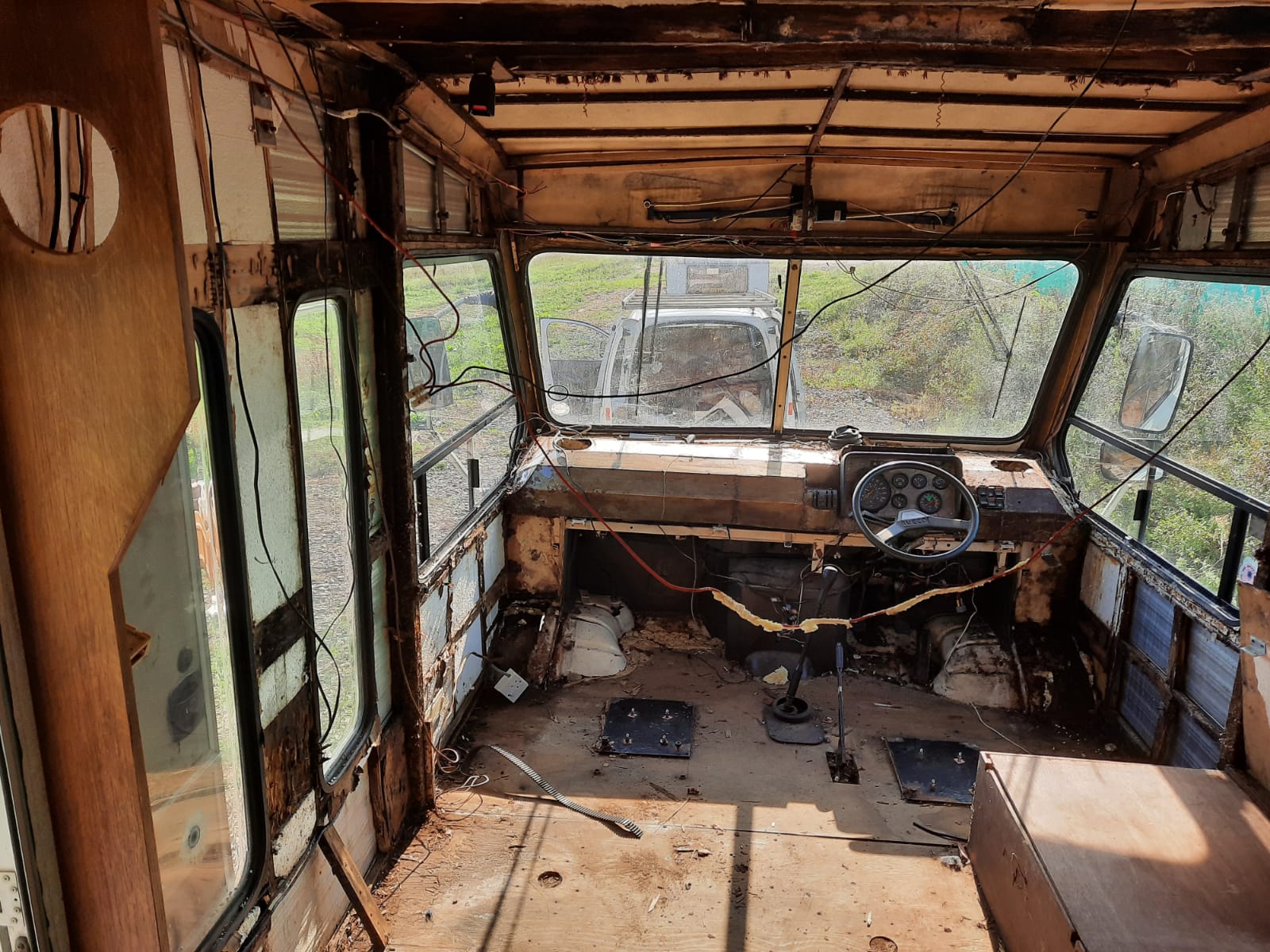

I didn't know they did an Iveco base, should be easy to get parts for that? Mine was much the same as yours, leaks everywhere, I started same as you trying to fix with sealant. It worked for a bit but after a few tours it always failed, I discovered in the end that the rotten wooden frame was affecting the structural integrity so the thing was basically vibrating itself apart. Unlike you I wasn't brave enough to strip the whole van and do it properly all at once, so have been just tackling individual areas one at a time, gradually replacing the timber. The windscreen was the same, it turned out to be vibrating too much to ever stay sealed, after replacing all the wooden frame around the glass and fresh sealant it's now survived a few long trips and not leaking yet. I seem to have loads of photos of nearly finished work, not so many of the original horror story. here's a couple I found. Kept a few original timbers in that weren't so bad as these are connected to the aluminum and kept to hold it all together without new nails. Wish I'd got new insulation now, looks awful!
I've tried to put everything back as I found it, so all the original cabinetry is there and the central living area. Some new bits here and there to improve things. The dropdown bed was a nightmare, so heavy to put up I nearly did my back in using it. I managed to find air struts to replace the springs and although it's not perfect it's so much better now. The best thing is the force is consistent so when it's right up to the ceiling it still holds it well, the springs would stop working near the top just when you needed them most. Do you have the same system? Some new timber here as well!
