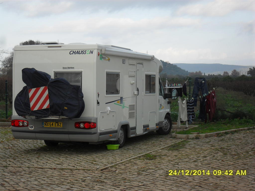

SDC10006.jpg I have a Chausson Alegro 67 love it no trouble in the 3 years I have had it except the fridge stopped working in Portugal but that is Electrolux/ Dometic, not Chausson,I don't like one marque clubs though.

View attachment 30076 I have a Chausson Alegro 67 love it no trouble in the 3 years I have had it except the fridge stopped working in Portugal but that is Electrolux/ Dometic, not Chausson,I don't like one marque clubs though.
