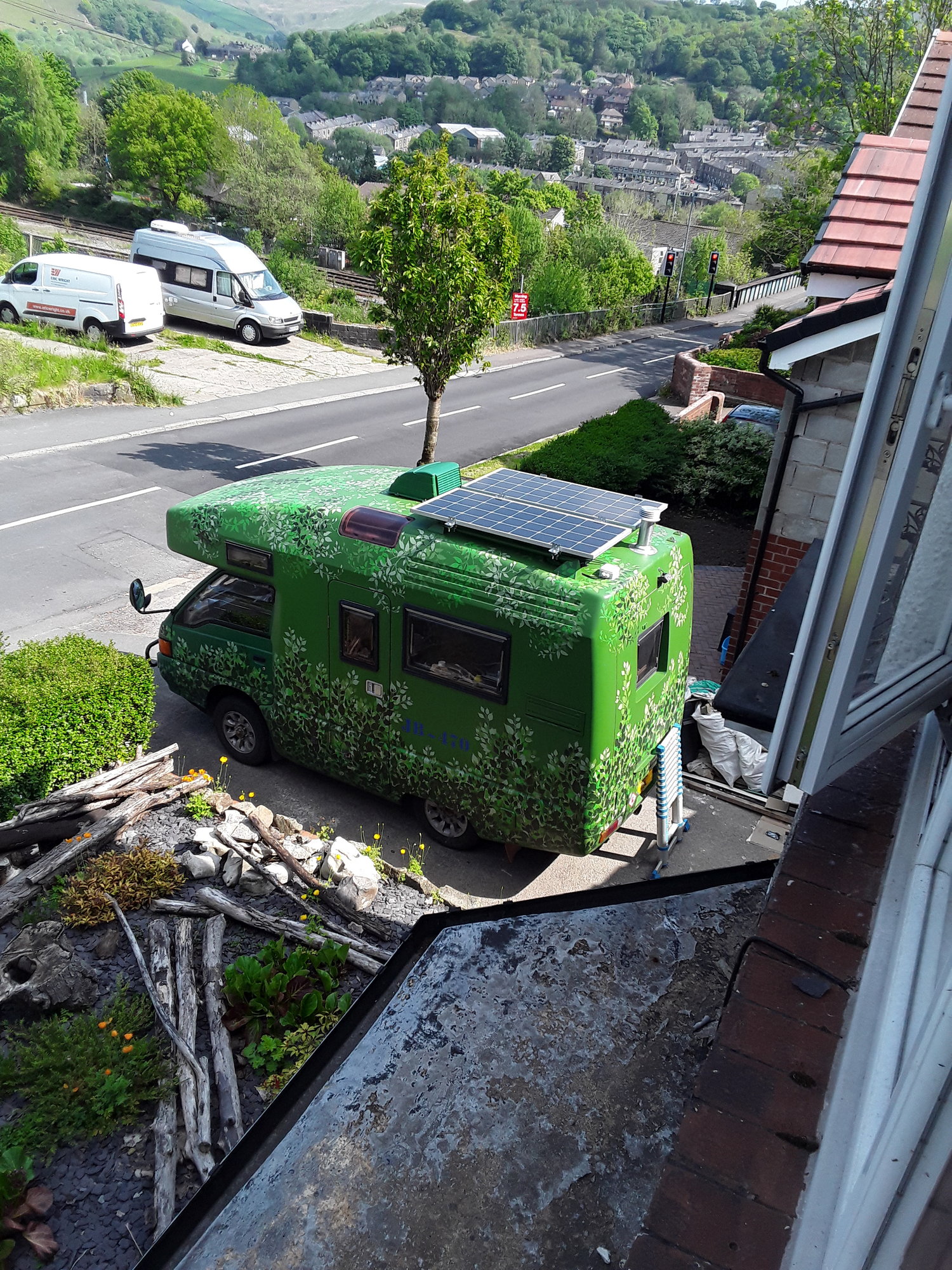

I'm in the two solar seasons 200w panel summer and extra 2 place on top temp over hanging panels in winter if away for a 3day -5day . As I use van as, my go to work van, 300miles a week. why have the extra weight 30kg all year round. ?
Wildebus got me a great victron solar controller. What showed 208 and 197watts from 2x100watt cheap panles once when batteries were very low this year
Only phil needs a min 1700w all year round. But he ant leisure only.
But this is only for my xmas lights
