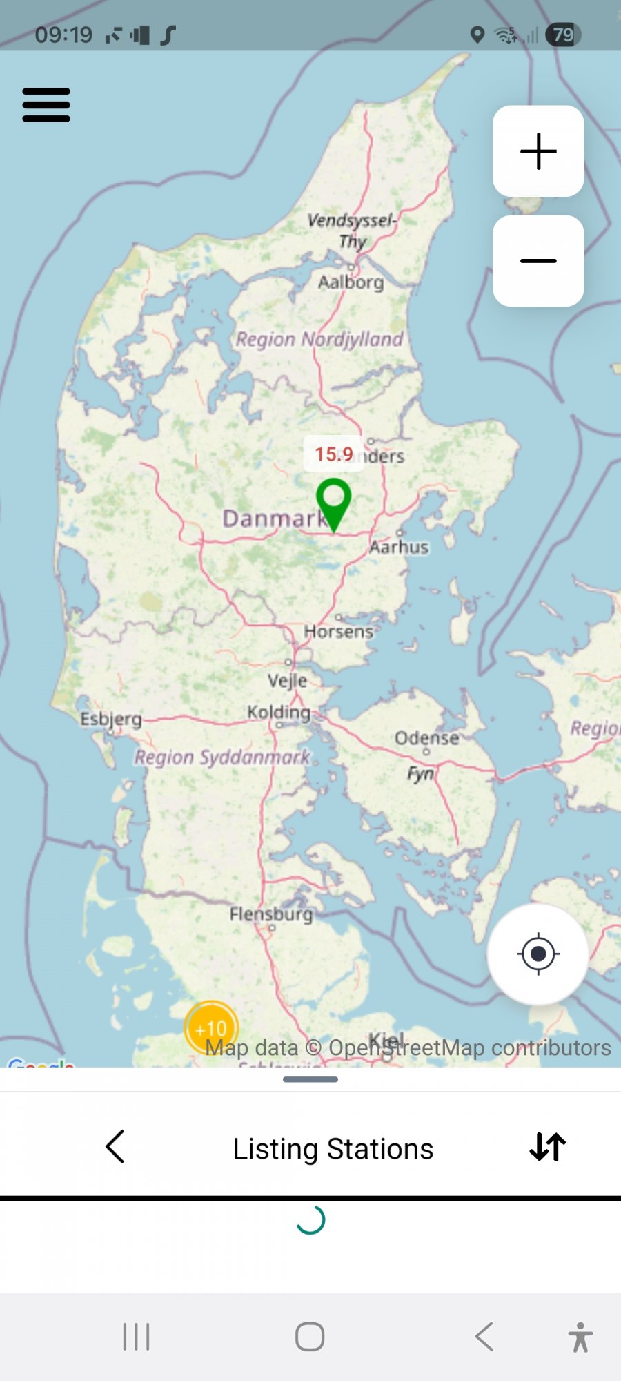

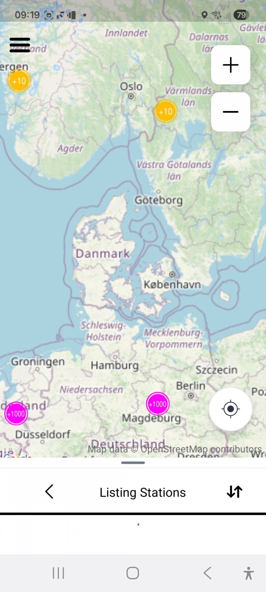

I was on a Pilote FB group earlier and saw a post saying that there are only 5 lpg stations in the whole of Denmark, and they're closed at weekends.
I'm off to check the app now.

Diesel heating definitely looking good if you are intending to stay in Denmark for a while. I'm wondering if there are other countries where lpg is really difficult to get.
