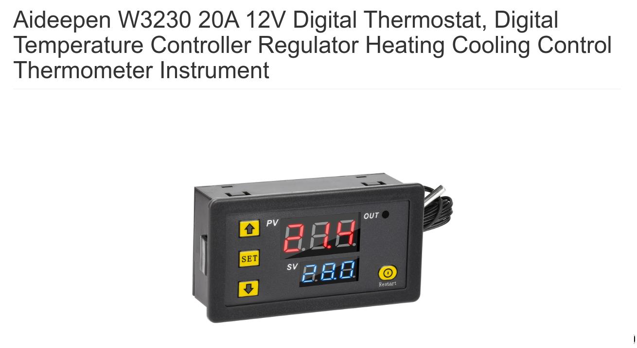

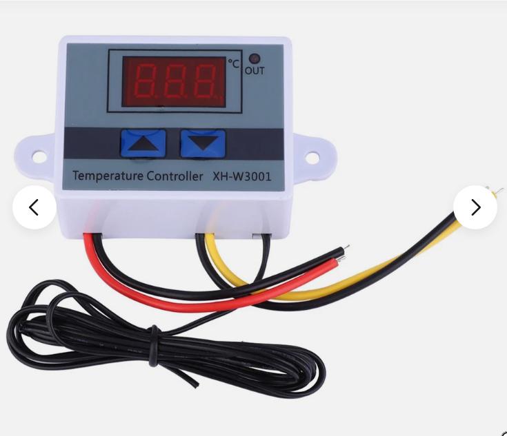

You can use a simple thermostat in the positive feed wire to sort it out, you only have to cut the pos wire and connect either side inside stat, there may also be a requirement to fit a nutral/negitive wire to make it work, wildbus im sure could help on this mater.If it's hot in the van when I go to bed, I turn the heater off. Then wake up a few hours later when it gets too cold and turn it on.

It only seems to have on and off. The + and - buttons don't do anything.

That will need to be wired carefully so that it turns the heater off without cutting the power to it, because the heater needs to go through the shutdown cycle when it turns off.You can use a simple thermostat in the positive feed wire to sort it out, you only have to cut the pos wire and connect either side inside stat, there may also be a requirement to fit a nutral/negitive wire to make it work, wildbus im sure could help on this mater.
I may have a look online about this, cost about £7View attachment 147866View attachment 147867
