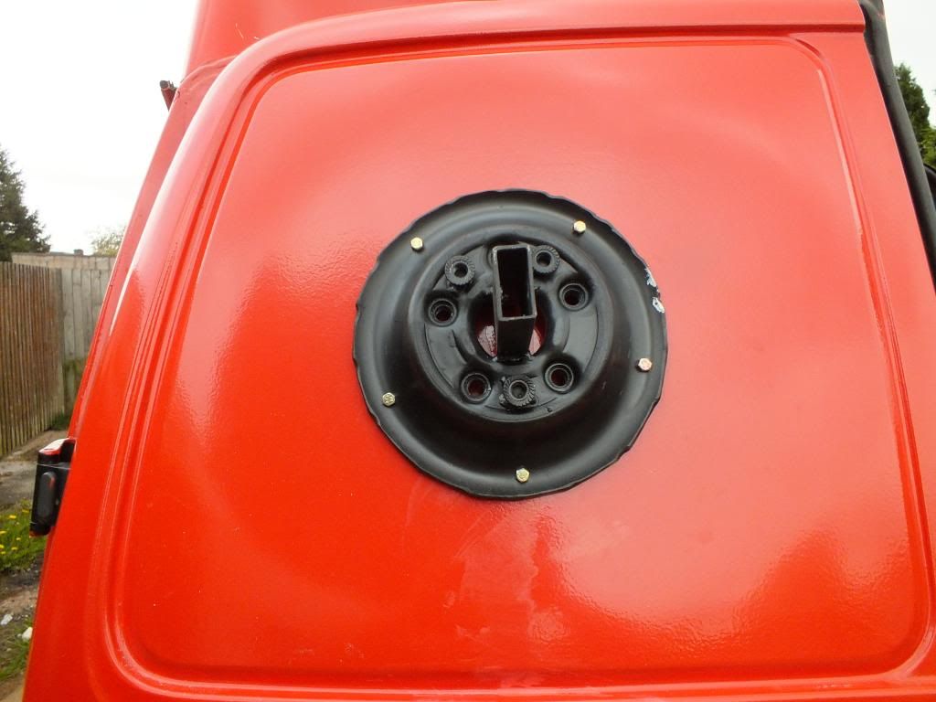

Ref your spare wheel, can't see any photos of your rear end (the delicacar that is!), so not sure what it looks like (is there a rear door there?), but if you could maybe get a mount made for a spare similar to what you see on the rear doors of 4x4s?
Something like this would be pretty simple to do if space and construction allowed (and would be easy enough to tidy up so it looked better!)
This is actually part of a steel wheel with bolts attached. You would put a plate inside for strength and rigidity.
Just a thought to possibly get the spare off the roof and both more accessible and lower the CoG.
At the back of the bus i have a window, two fridge vents and a storage locker where the gas water heater used to be, and as the van body is fibre glass i dont think it is strong enough to hold the weight of a bull bar plus a wheel. A spare wheel at the front would mean that i need 2 parking bays to park in. Also i am trying to bring weight forward rather than add to the weight at the back
