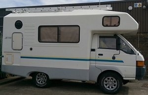

Ho55's van from Delica owners club forum looks very like yours
Delica (P25T) L300 Chassis Cab with a JB 500 Coachbuilt Camper Body, Rear LSD Diff, Front Locker.jpg
Photo tag is:
"(P25T) L300 Chassis Cab with a JB 500 Coachbuilt Camper Body, Rear LSD Diff, Front Locker diff, Lesjofors Rear Springs, Pajero GenII rims".
