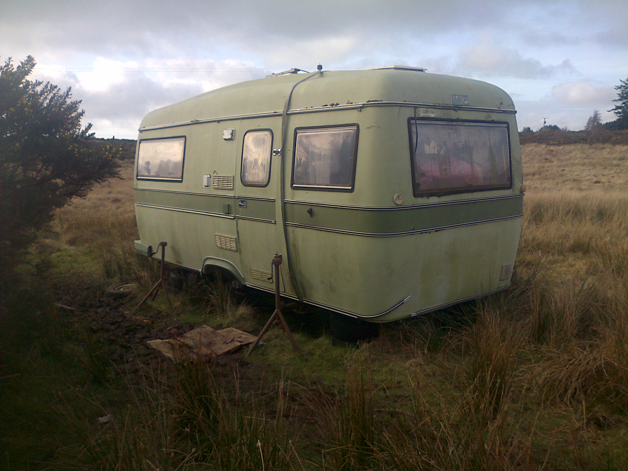

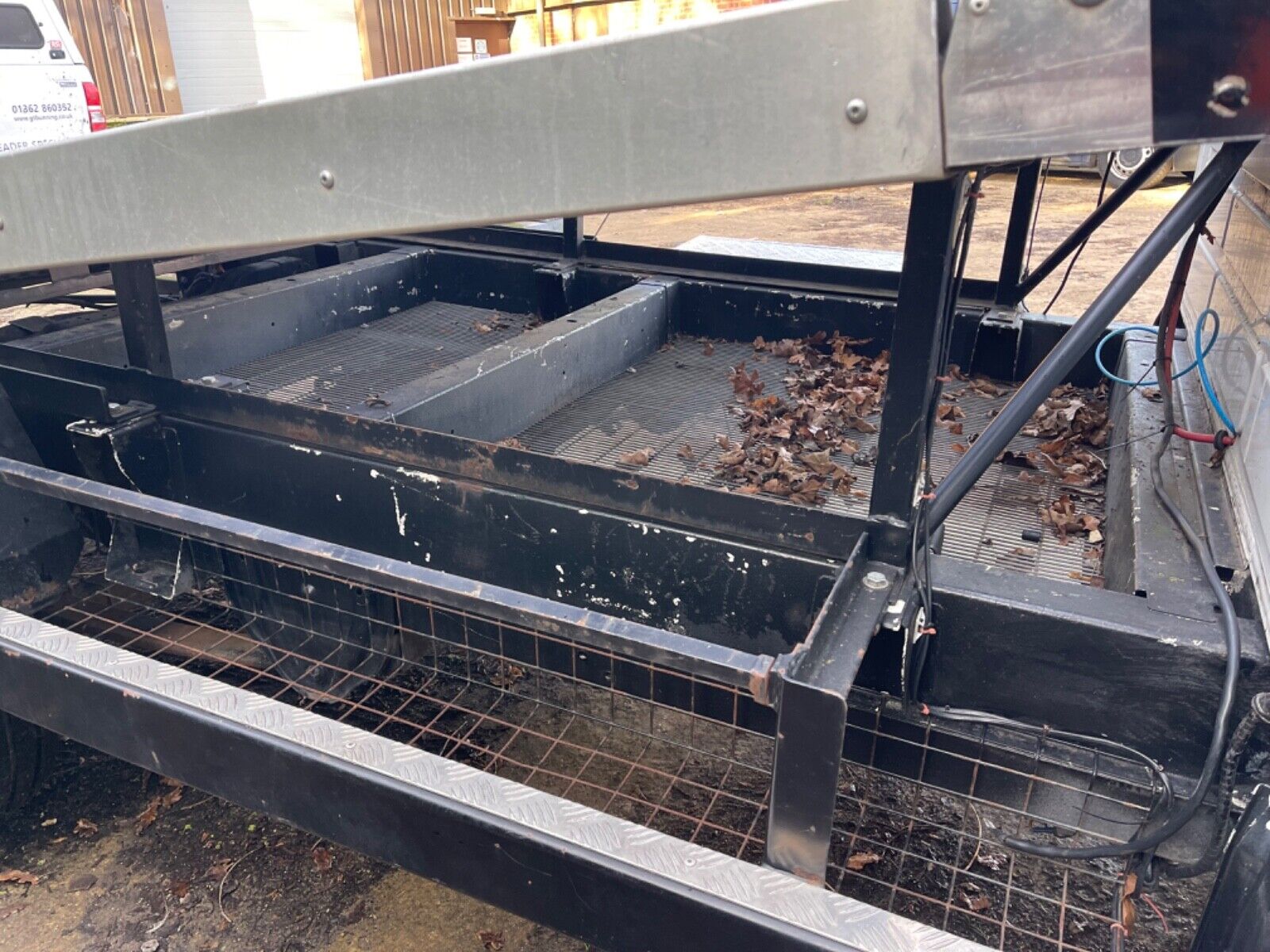

Well, for those interested in this method of undertaking a camper/motorhome conversion, things are happenning. We purchased a 2012 Fiat Ducato crew-cab recovery truck as a base vehicle. It is a little oder than I wanted but with only 50-odd thousand miles on the clock I decided to buy it anyway. It goes like stink and is great on fuel. I used to transport two scrap vehicles to make room for the Ducato before removing the decking. The bed-frame is now being levelled off and extended to accomadate the MKP caravan body and I hope to have it fitted within a week or so, although I'm not quite sure which method we'll use to life it high enough for the truck to revers underneath it.

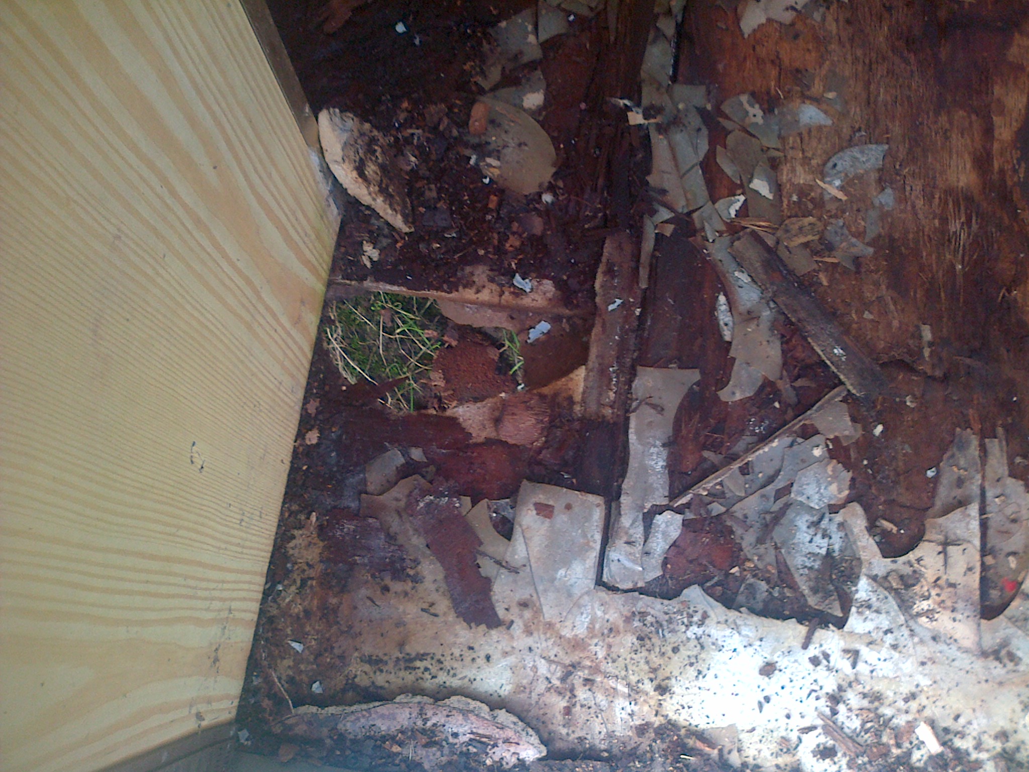

Once the above is completed, the whole thing is going to a motorhome workshop to have the insulated floor repaired/replaced, and other quite major work undertaken. We decided in teh end to spend money on restoring the MKP body that I ifitted to the Citroen recovery truck (see above post) as opposed to buying a newer caravan and then throwing the running gear away. This decision was my wife's but I think a good one. The MKP body, being shaped like a loaf of bread, is more 'motorhome looking' and also just a little quirky and different. Updates to follow. See pictures below.
