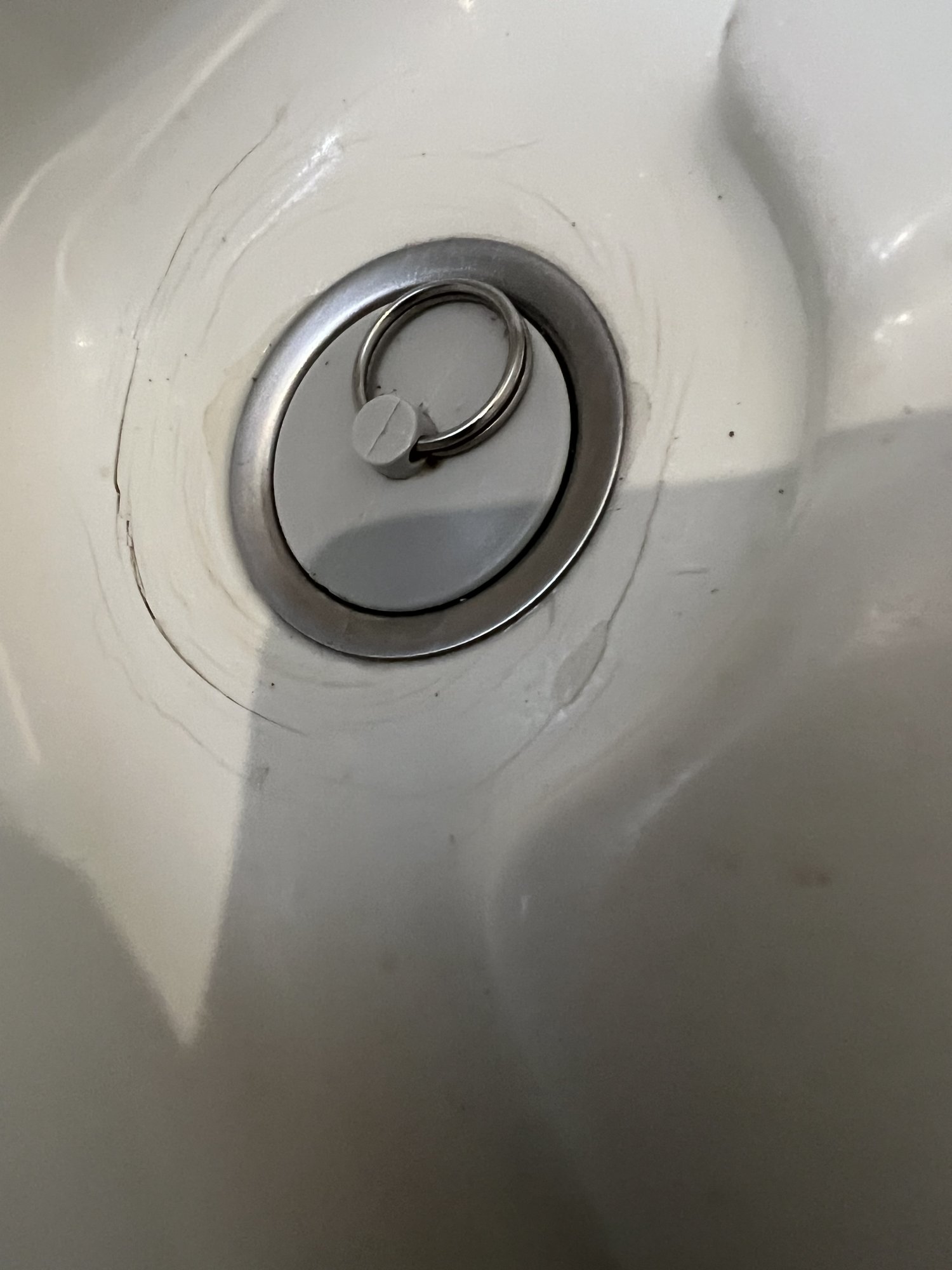

We’ve got concentric cracks part way round the outlet from our shower tray on RT Pegaso 590. Apart from the eye watering cost and delay of a new one from Italy, replacing it thanks to the order in which RT have assembled it, it would require dismantling the entire shower, plumbing, washbasin, screen and bathroom cupboards to replace it.
Does anyone have experience of a specialist who could effect a repair in situ? And what they may charge?

This is the problem. I’ve used Milliput before for
other things, but I don’t think it would work for this cluster of very fine cracks.
Captain Tolleys Creeping Crack Cure didn’t work either. The larger crack shows some flexing, which shows just how flimsy these shower trays are.

My shower tray was done by Speedboat before I bought it in 2018 and still going strong. Looking how yours has cracked though it may be whatever is supposed to be supporting under the outlet has gone. I would think Speedboat would tell you though as if they thought that they wouldn't do the work just coating it.
Shower tray cracking is often due to issues with lack of adequate support; when Speedcoating mine, Edwards pumped in expanding foam beneath the shower tray to provide more support.
Ah great, I didn't know if they did anything other than apply the coating so that would sort it out ok :)

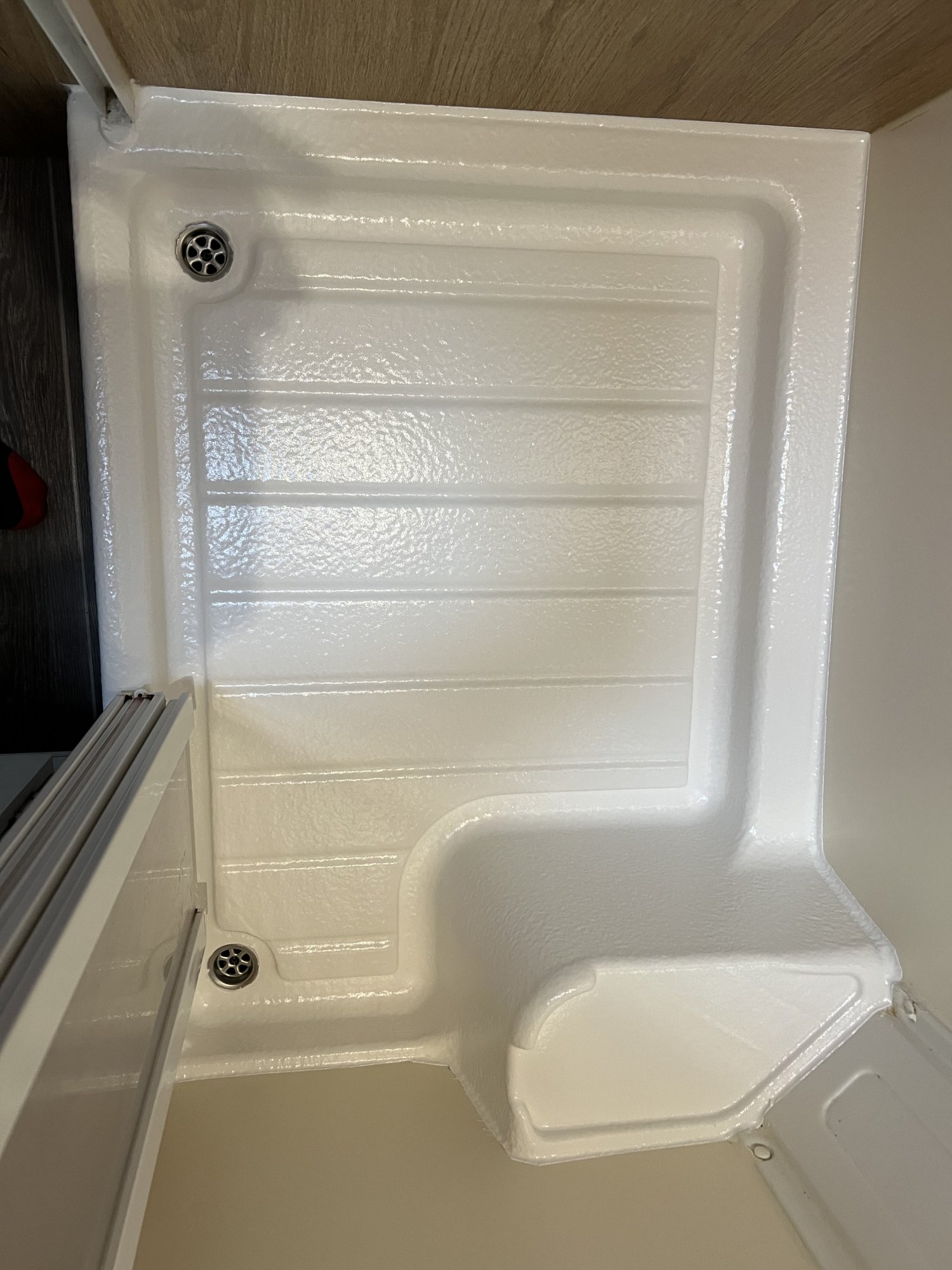

I repaired mine in 2021 and it is good, see -
