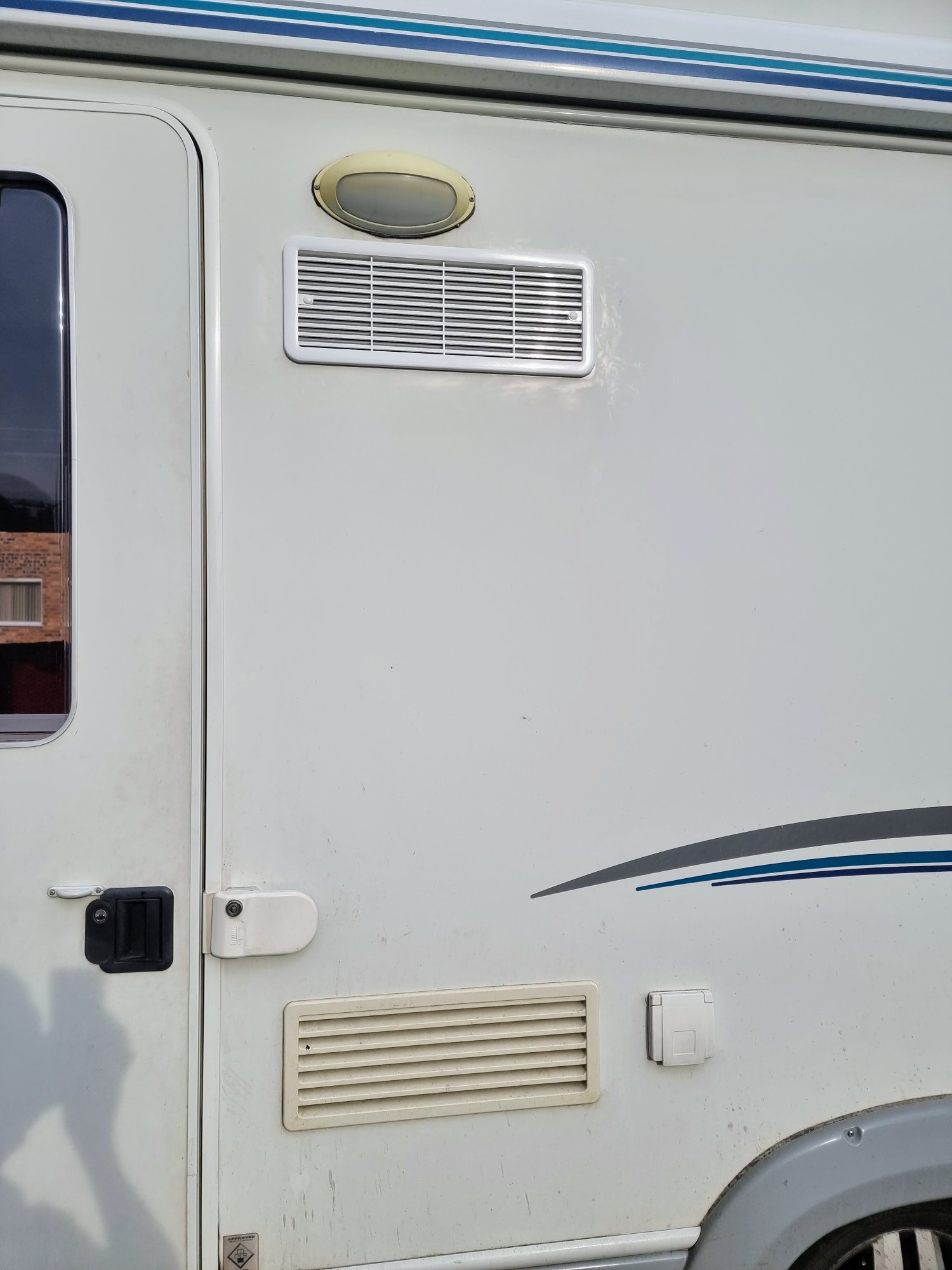

I've just installed this:
https://www.amazon.co.uk/dp/B0F93WRP9D?ref=ppx_pop_mob_ap_share
It's well made, good value and works well. It fits exactly where the original frame and vent was installed.
The hole positions don't match those in the Thetford installation and I needed to remove and replace the fans in the new installation to route the wires to the rear.
I have fitted a remote control switch so I can disable the fans if required.
Recommended.
Completed installation.

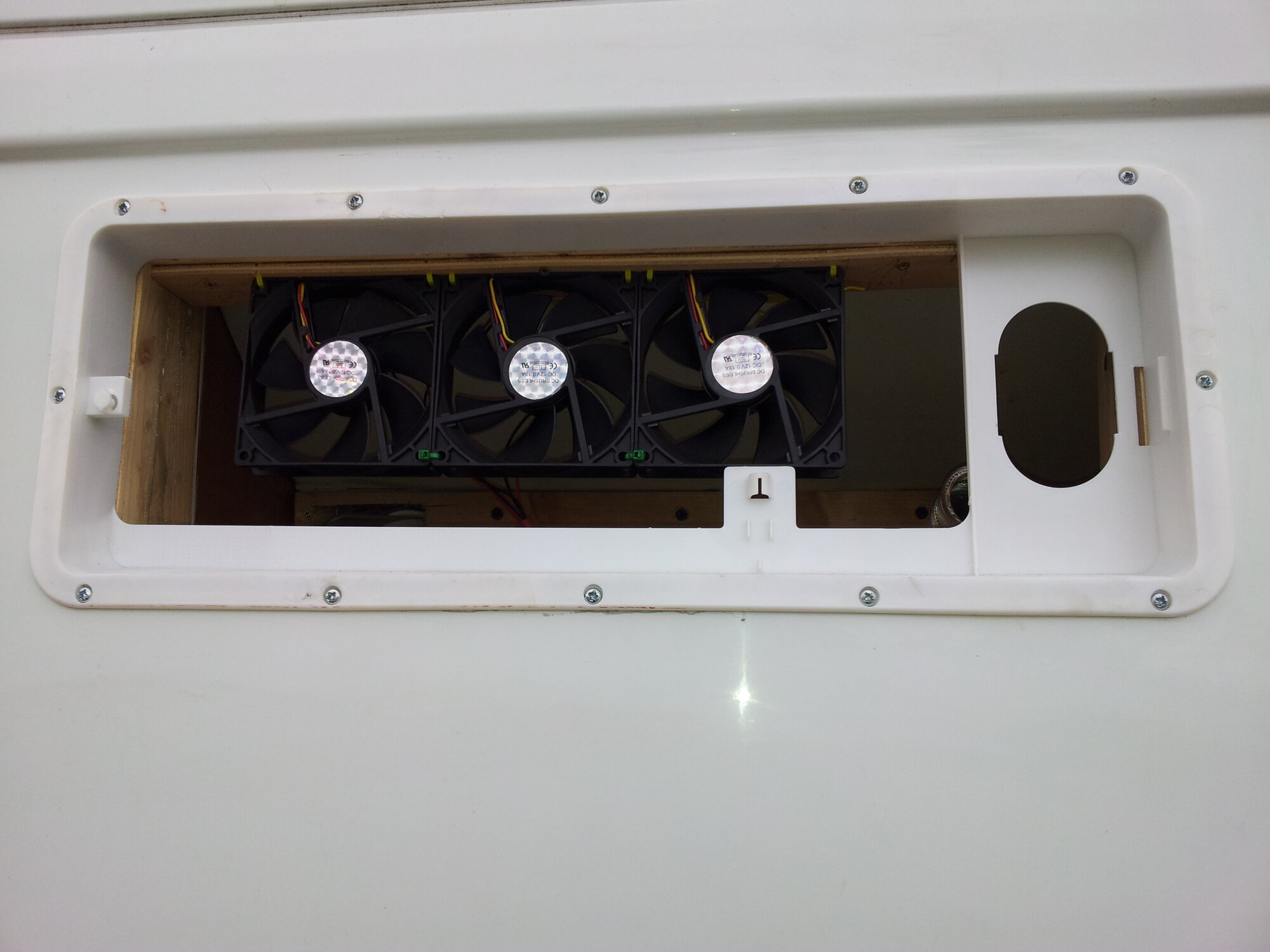

About 10 years ago I installed two 12v PC cooling fans fixed to the vent with cables ties as a proof of concept to see if the idea worked.
Still in use and still effective
Recommended.
Looks good. I haven't seen an "off the shelf" kit like that which is ready to fit.

I have three fans fitted in the vent on my fridge, unlike other comments on here I found that the fridge is significantly cooler in hot weather. In the South of France/Spain in July and September my fridge was useless before I fitted the fans, with the fans I could make ice cubes and keep frozen food safely.
If there are any gaps around the fans they don't work efficiently, so the ones pictured in the OP should give an improvement but I am sure Chris will give us an update
