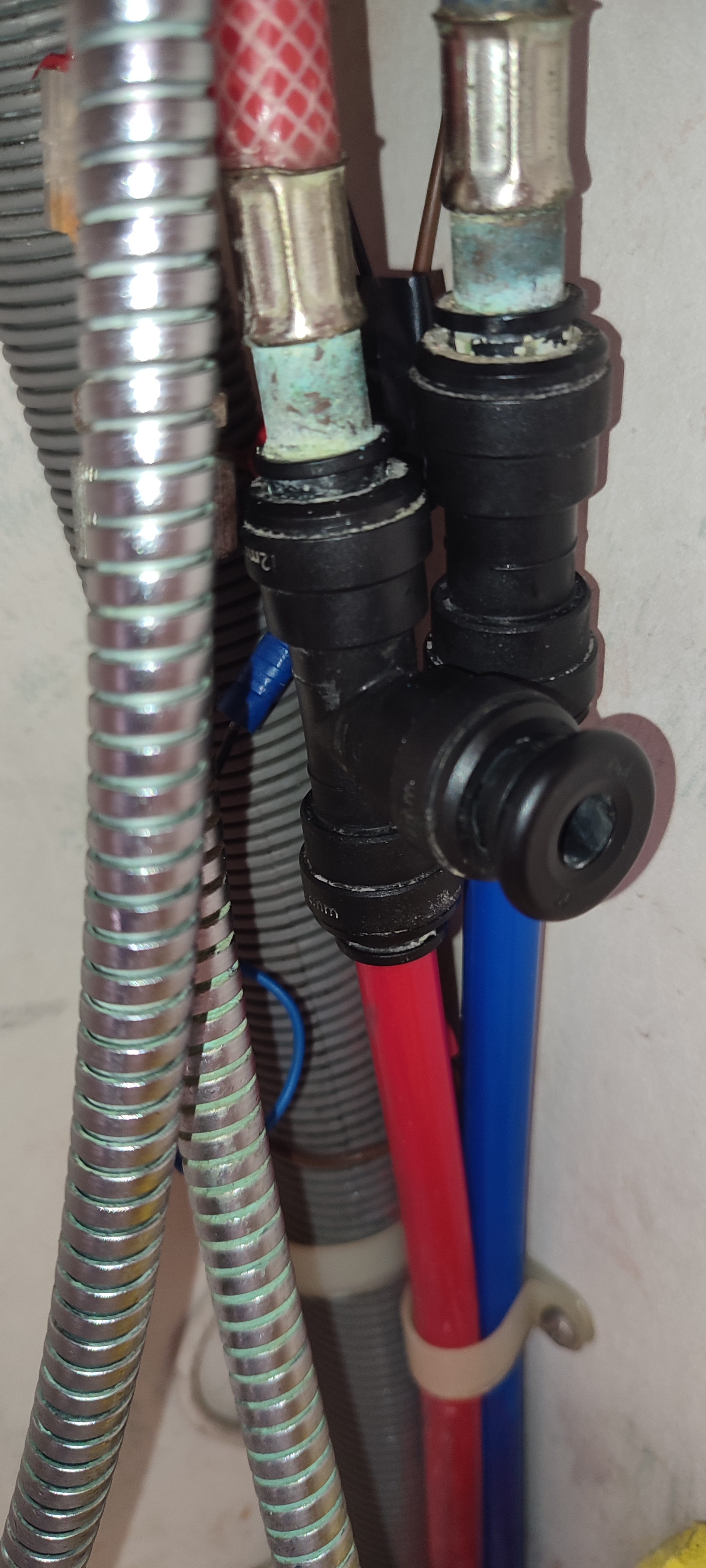

Although I drained the water tank, I have frost damage at the tap due to the water residue there. When the tap is run, the leak is from the region of the base of the tap.
Having undone the back nut under the basin, in order to lift it out I need to disconnect the tails from where they connect to the system. The problem is that I don't know what type of joint I'm looking at. It looks like it might be a John Guest push fit, if is that it is seized with limescale or similar. I'm hoping that somebody here will recognise the fitting and can tell me. I'm also puzzled as to why the hot water fitting is different with the button on it

Yes, same as John guest speedfit. You need to push the collar into the fitting side pull the pipe at the same time. Twisting may help.
Thanks. I'll give it a going over with some limescale remover tomorrow, I think the collar might move a bit easier then!

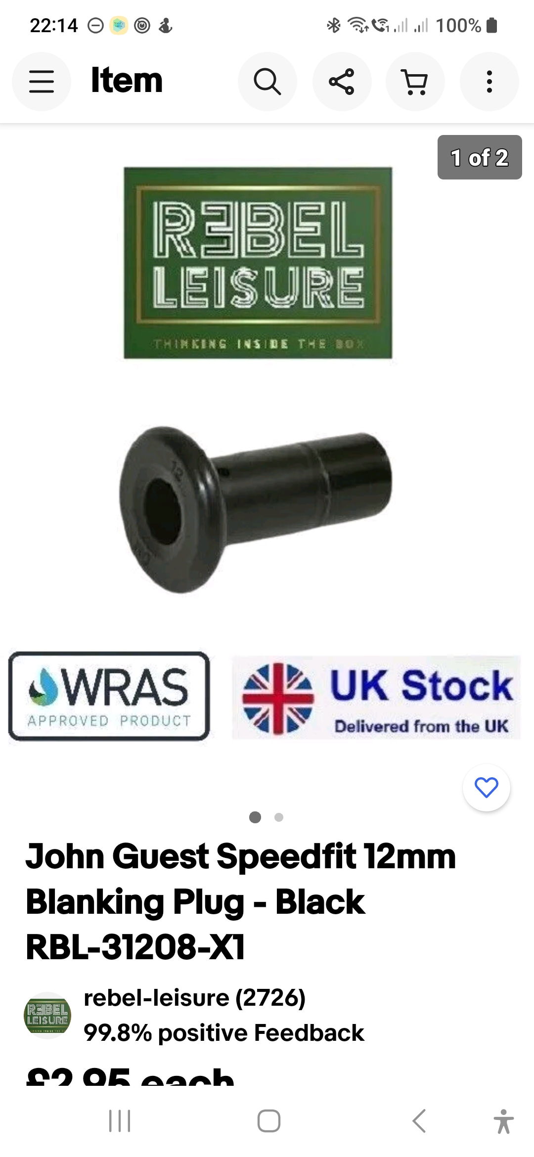

Without doubt its a John guest fitting, and as st3v3 says the collar has to be depressed and the tail pulled out. The button looks to be a plug that closes off another orifice. It seems that the originater of fitting the tap ran out of straight connectors and used a "T" piece and a plug. Phil

Thanks again for your help, after a struggle I managed to release the fitting after dissolving the limescale. It did involve a lot of twisting and turning, the collar kept coming up with the pipe. The good news is that on inspection it appears that the ice pushed out the hoses a little way, past the pin that holds them. Having pushed the pin out, they went fully in with the help of a smear of silicone grease. I haven't refitted them back to the basin yet, but they're air tight so I'm confident they're water tight.
