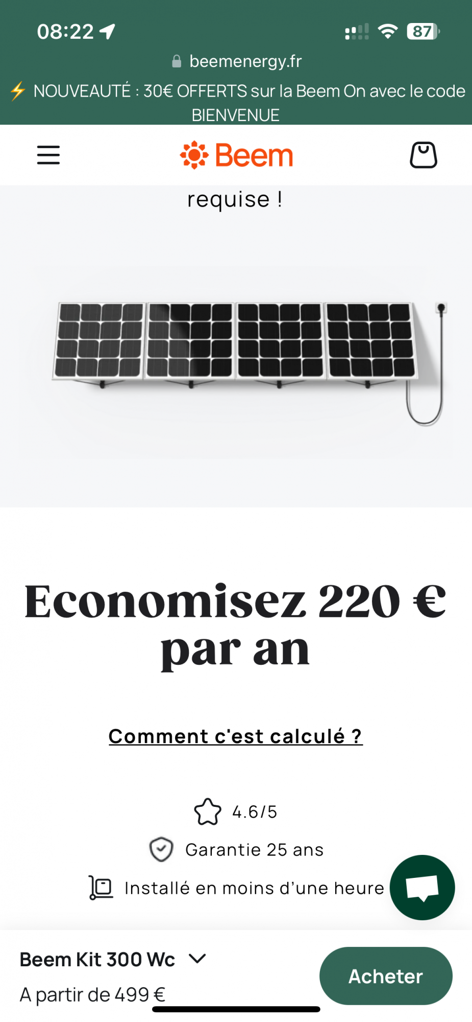

This is the system I have. Beemenergy.fr
As I live in France it is worth the saving for quite a small outlay.
