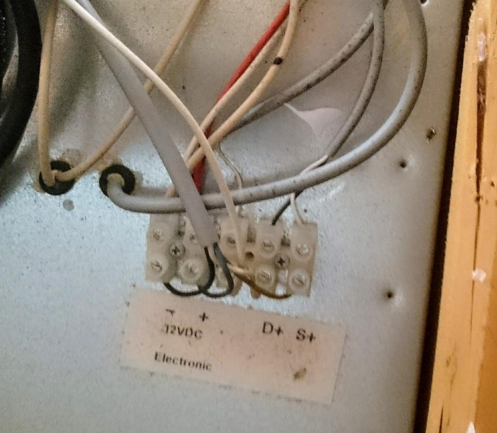

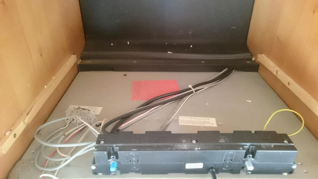

View attachment 61970View attachment 61971View attachment 61972 these three pictures show the top of my Dometic fridge with the internal fridge wiring, I tapped into the 12 volt as marked. My temperature control I mounted on the front fascia on the left and a rocket switch on the right to isolate the fans. I clipped temperature probe to the radiator fins at the rear of the fridge.

No there is a permanent 12 v feed for the igniter, separate to how you are thinking
