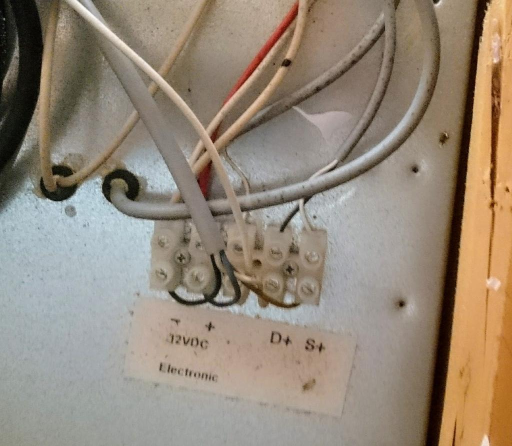

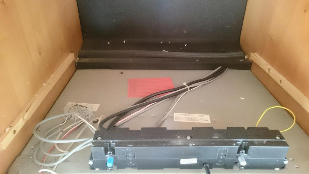

We’ve got a domestic three way fridge and want to connect a fridge fan. What is the best place to make the electrical connections to?

What a long way round to do things,12v behind switch at fridge which is about 1ft away.
On our last van the fridge was next to the settee with leisure batteries beneath and I found it quite easy to wire up.
John.
I have three behind the top vent so extracting the air from behind the fridge. Some of the fans can be a bit noisy when run on 12v so I have the option to switch in a resistor to reduce the voltage which makes them much quieter.
DSC_0466.jpgDSC_0470.jpgDSC_0465.jpg these three pictures show the top of my Dometic fridge with the internal fridge wiring, I tapped into the 12 volt as marked. My temperature control I mounted on the front fascia on the left and a rocket switch on the right to isolate the fans. I clipped temperature probe to the radiator fins at the rear of the fridge.
