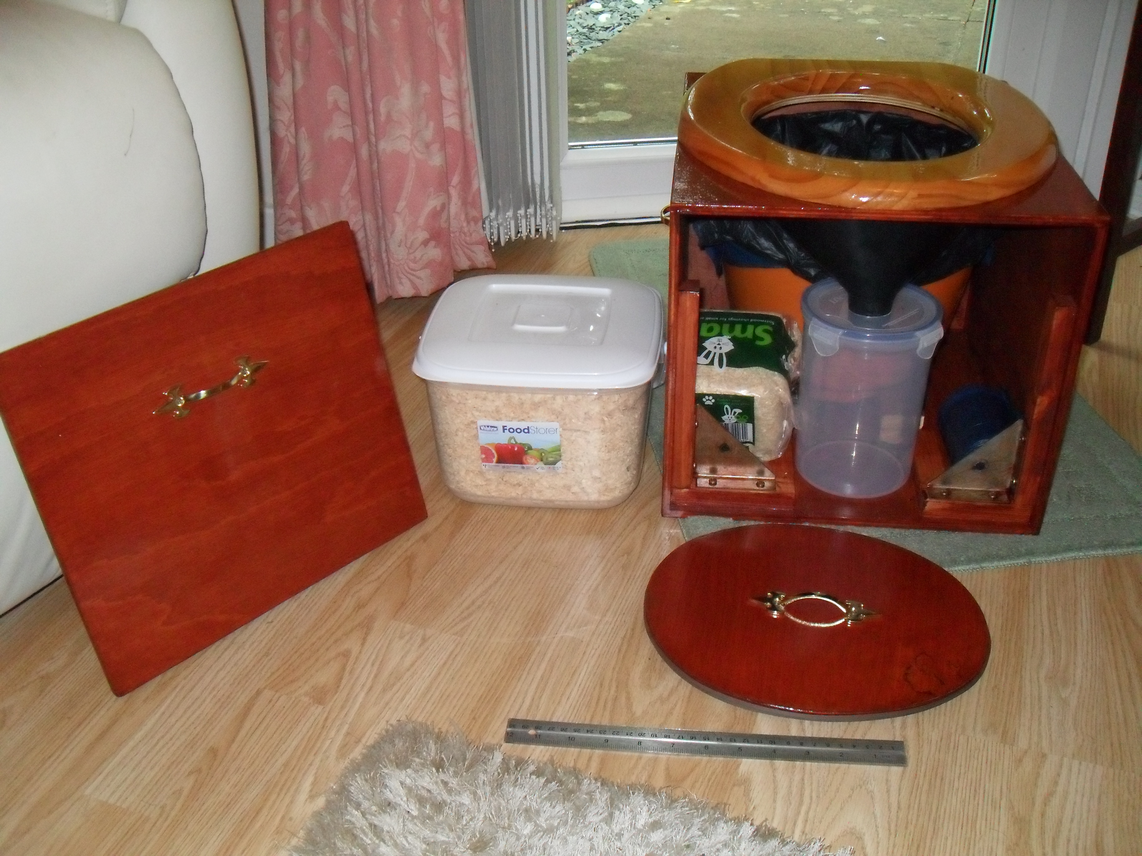

I have one, built it myself, been using it for about a year, and would never go back to a standard camper toilet. I definitely do not miss going to the elsan emptying point...yuk.
Love all the positives.👌 Great to hear them all.🚻
I'm surprised that no one has converted their cassette though.
Everything is there really just a separating seat and a pee tank needed..
I'd put money on some of the top of the market builders offering composting toilets within 5 years.
Good work Debs.... what "soak" material are you using is that sawdust? Have you tried anything else?
