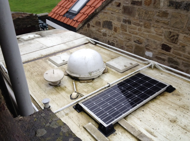

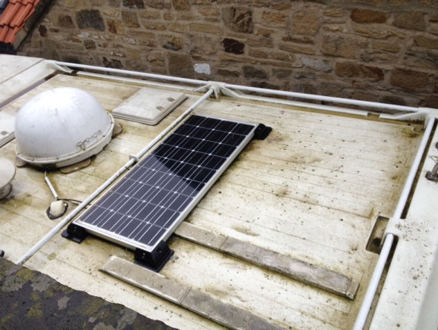

As you can see from the photos below, its pretty grim. Those spots are just impossible to shift but my biggest issue is getting up there and doing it. I might be able to manage to crawl about and spray it as it wont take long but Im officially too heavy to go on the roof (ill just spread out a bit :D ) and my knees are knackered but I think I can manage twenty minutes of spraying.
