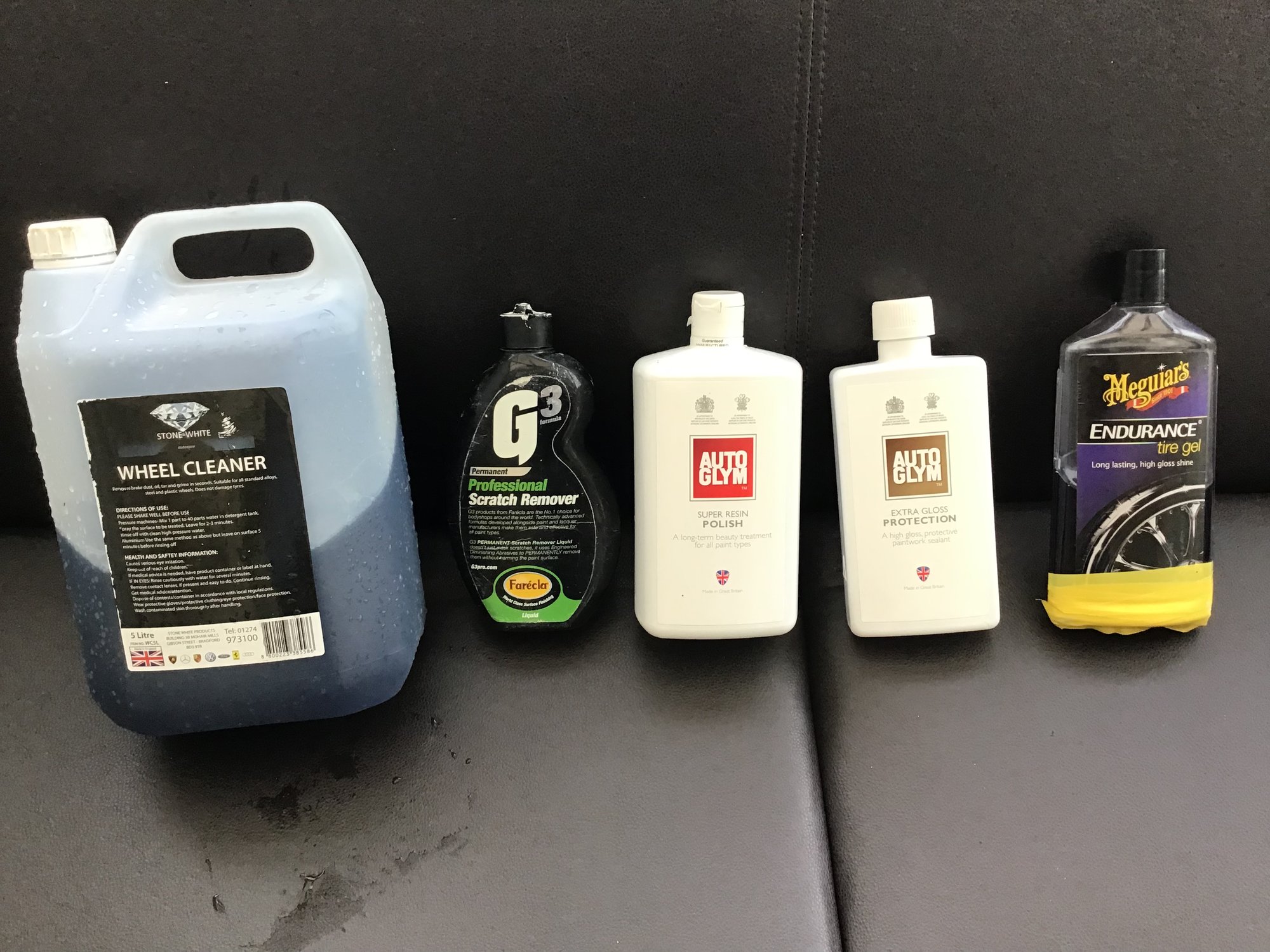

So whilst the wheels were off I decided to give them a good clean and polish,
First I started with a wheel cleaner and small brush, then g3 scratch remover, then polished with autoglym super resin, then sealed with autoglym extra gloss protection and finally a bit of meguiars tire gel.
First I started with a wheel cleaner and small brush, then g3 scratch remover, then polished with auto glam super resin, then sealed with autoglym extra gloss protection and finally a bit of meguiars tire gel.View attachment 73751View attachment 73751View attachment 73752View attachment 73753View attachment 73754View attachment 73755
