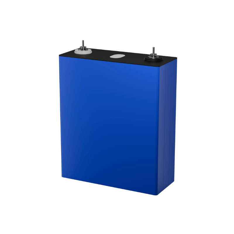

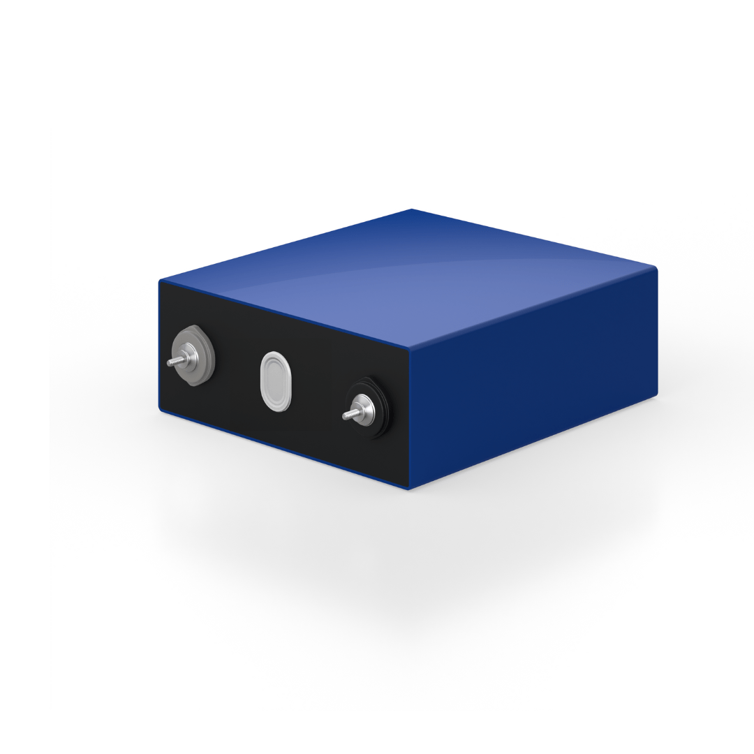

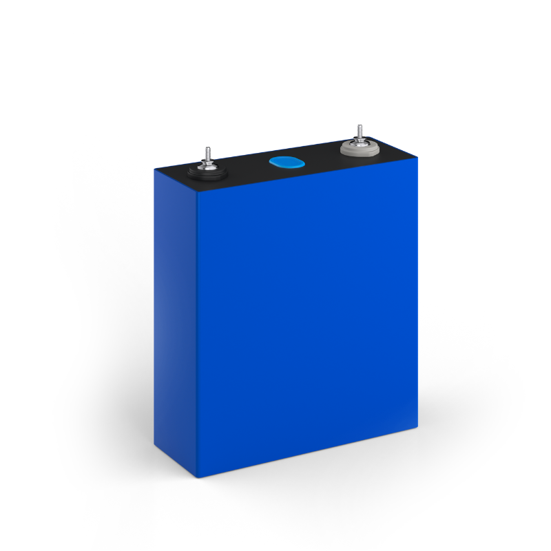

For the DIYers, adventurous and the thrifty, Fogstar have various cells at really competitive prices.
305Ah £70
280Ah £65
A set of 4 to make a 12V Battery comes complete with copper connection bars.
Add a 200A BMS at £100 and you've got a 305Ah battery for less than £400.
They say they are grade b ?? But they state their AH rate and say they supply them matched and give 3500 cycles with a 80% discharge, way more than the average camper will manage in a lifetime.
These are grade B cells which means they will not be as good as grade A cells.
I mentioned they were B grade in the first post Phil but as I said I'm not sure of the real word significance.
1, They are being sold as X Ah so they need to fulfil that description.
2, They are being sold as matched.
In what way and to what extent would you expect them to be inferior to a grade A cell Phill?
If they have the capacity and are matched I can't think of a big issue but would appreciate your input of course.👍
