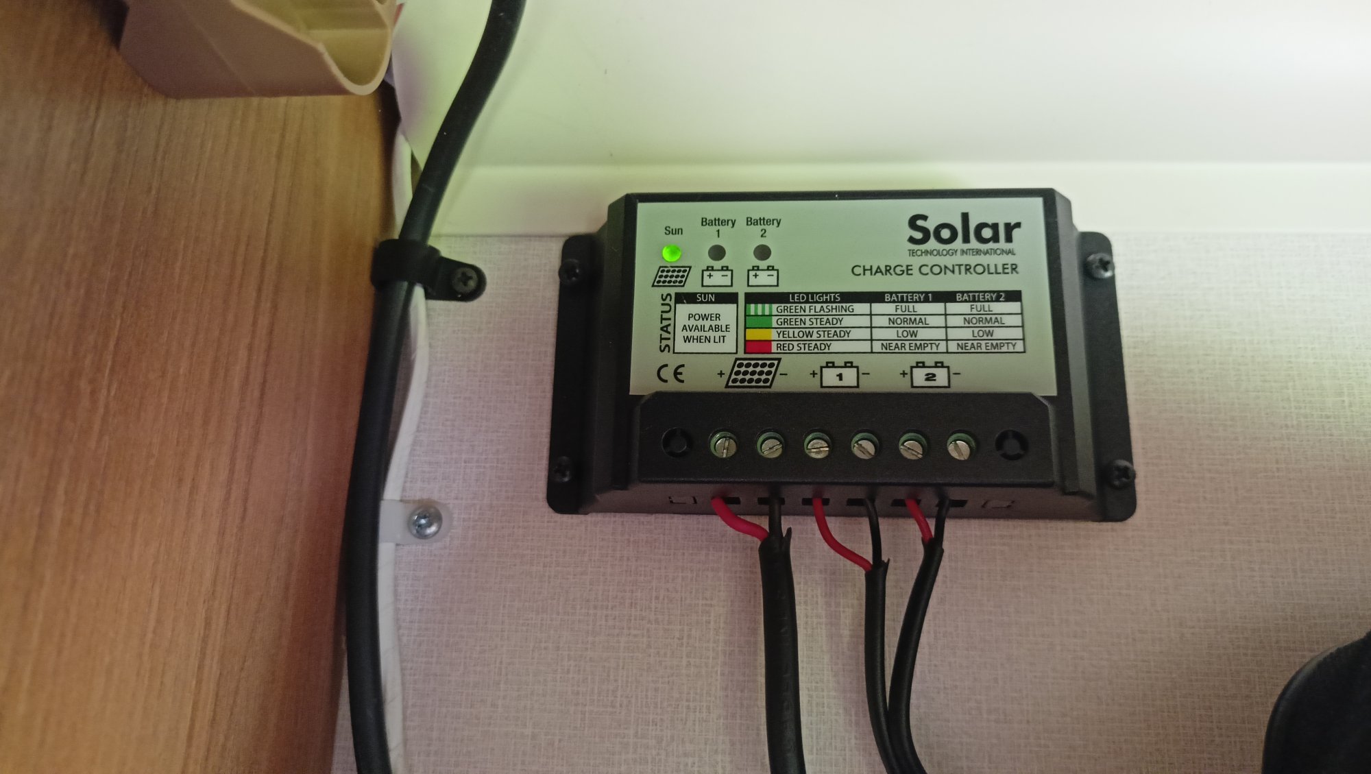

I see. Just a bit of butchering then. I'm going to start a new thread about my solar once I've been off grid a week and confirmed my observations. I don't think I need much more than I have. Jury is out.
Another Bazza thread! You going for total WC nomination?
What solar controller do you have right now?
A shite one by the looks of it. 😁 both those green lights are flashing by the way. I just caught them off on the pic.
As PWM Solar Controllers go, that is in principle quite a nice one.
However (always a 'however' ;) ), if you go by their own installation guidelines, it is essentially unsuitable for a Motorhome with a common -ve between the starter and the leisure battery - which is what you will have as if you didn't the Sargent unit would not work :D
