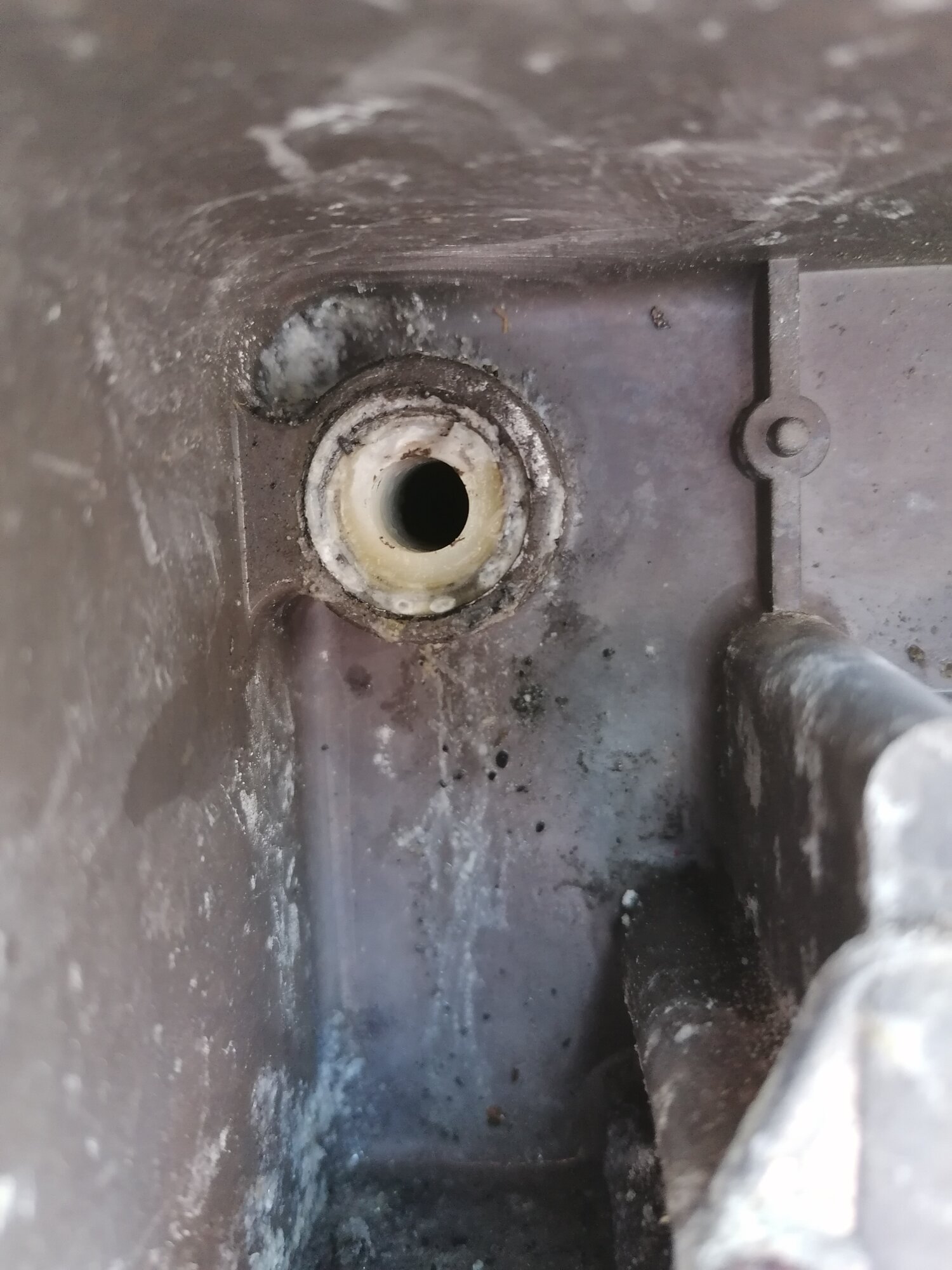

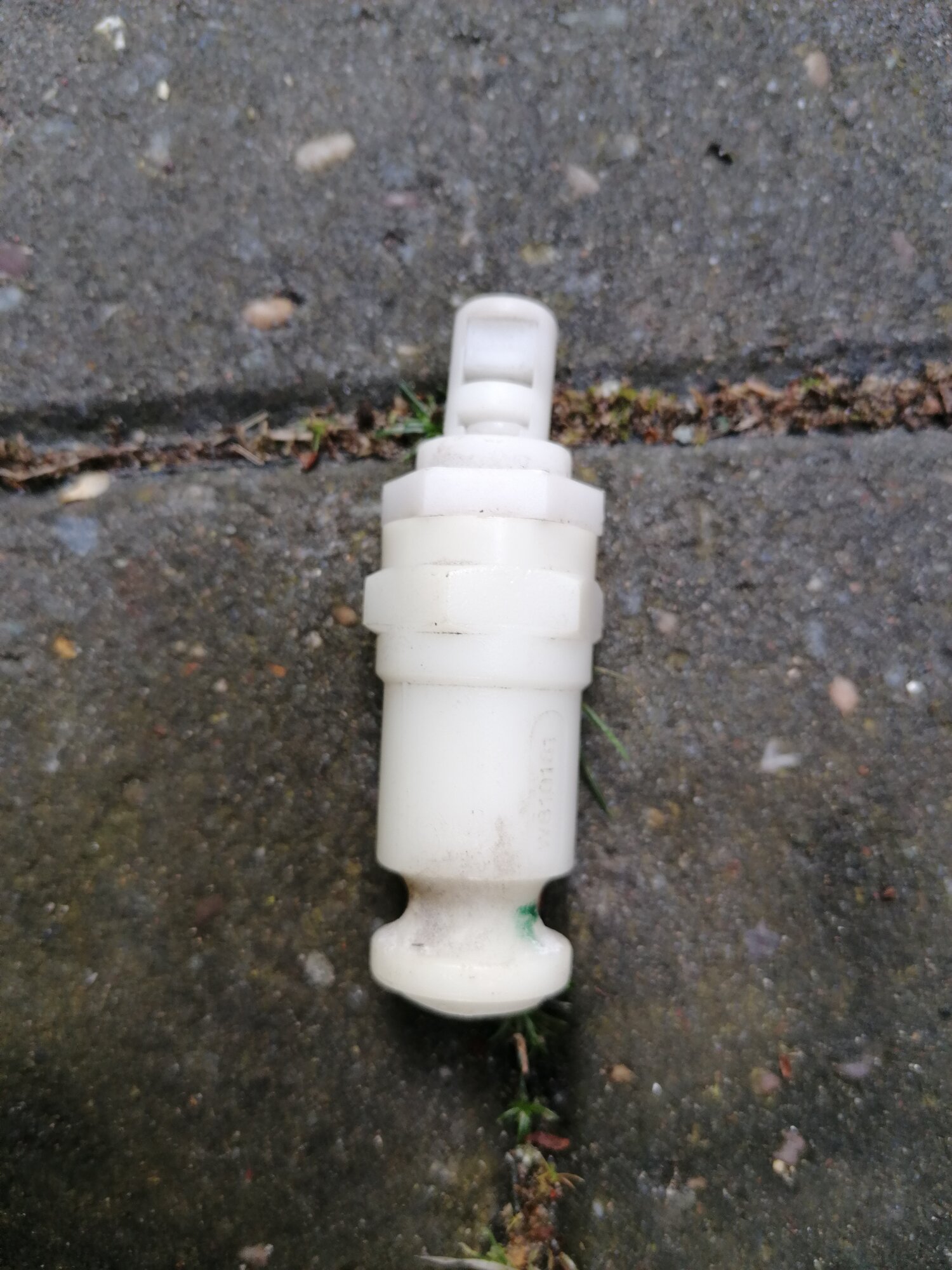

Had water leaking through the exterior vent so removed it for a look see.
The white plastic thing (pressure release valve possibly ???) top left, appeared to be the culprit so I got a spanner to it.
The blasted thing sheared off at the metal housing.
There was no way of removing the section inside the housing that I could think of.
What to do?
After many expletives I came up with a plan that didn't involve twatting it with a hammer. I cut a 1.5" section off the battery vent pipe and with the help of WD40 I managed to force it into the holes. Then it was a case of applying a liberal amount of silicone sealant and sitting out an anxious 48 hours before firing up the pump.
IT WORKED!!!!, 🍾💥💫🤟
Saved myself over £900 plus paying someone to fit it.

I had the same happen to me I drilled it out with a drill bit that just clear the thread then pick the bits out of the threads, then clean out with a bolt same size file two sides flat that will clean the thread out like new
By the way that is a safety valve if the carver gets to hot there is another valve loaded with wax f that go's you can not bodge it
