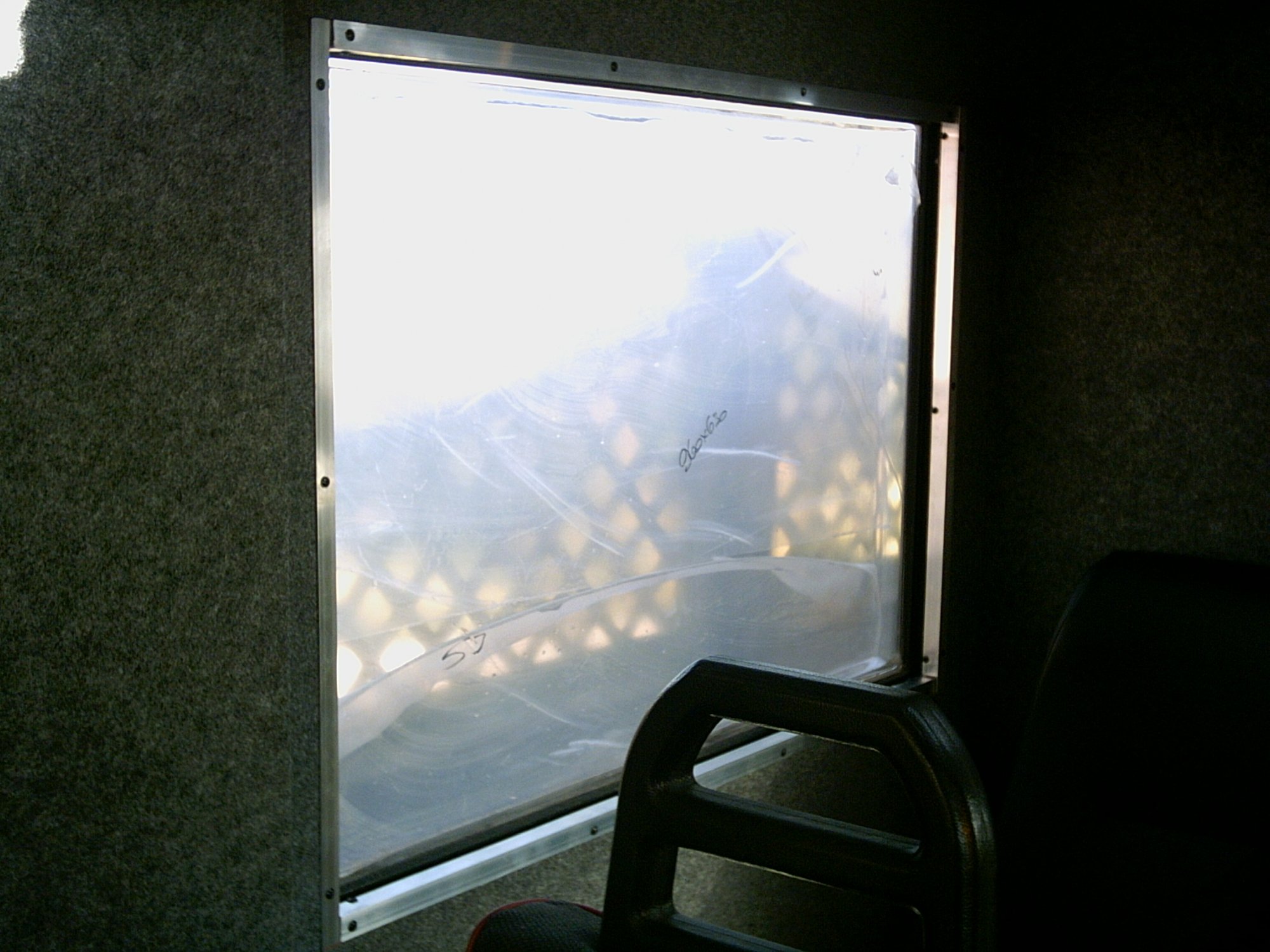

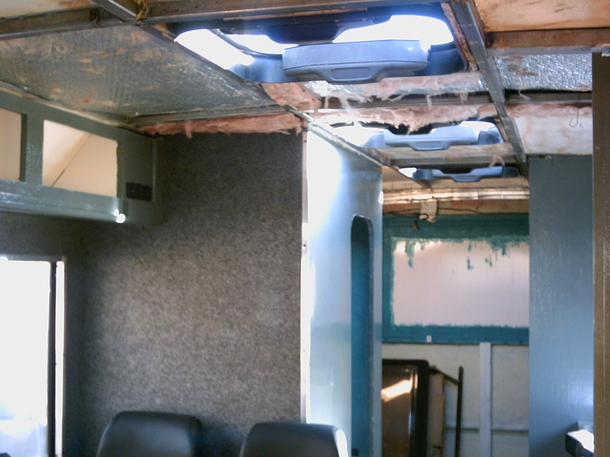

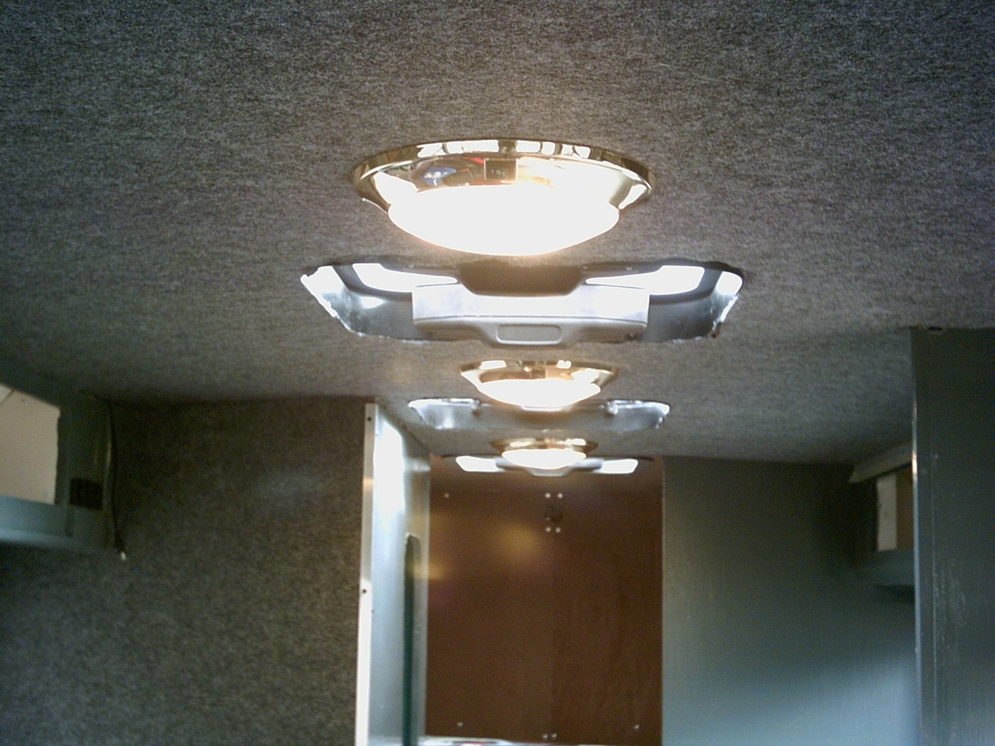

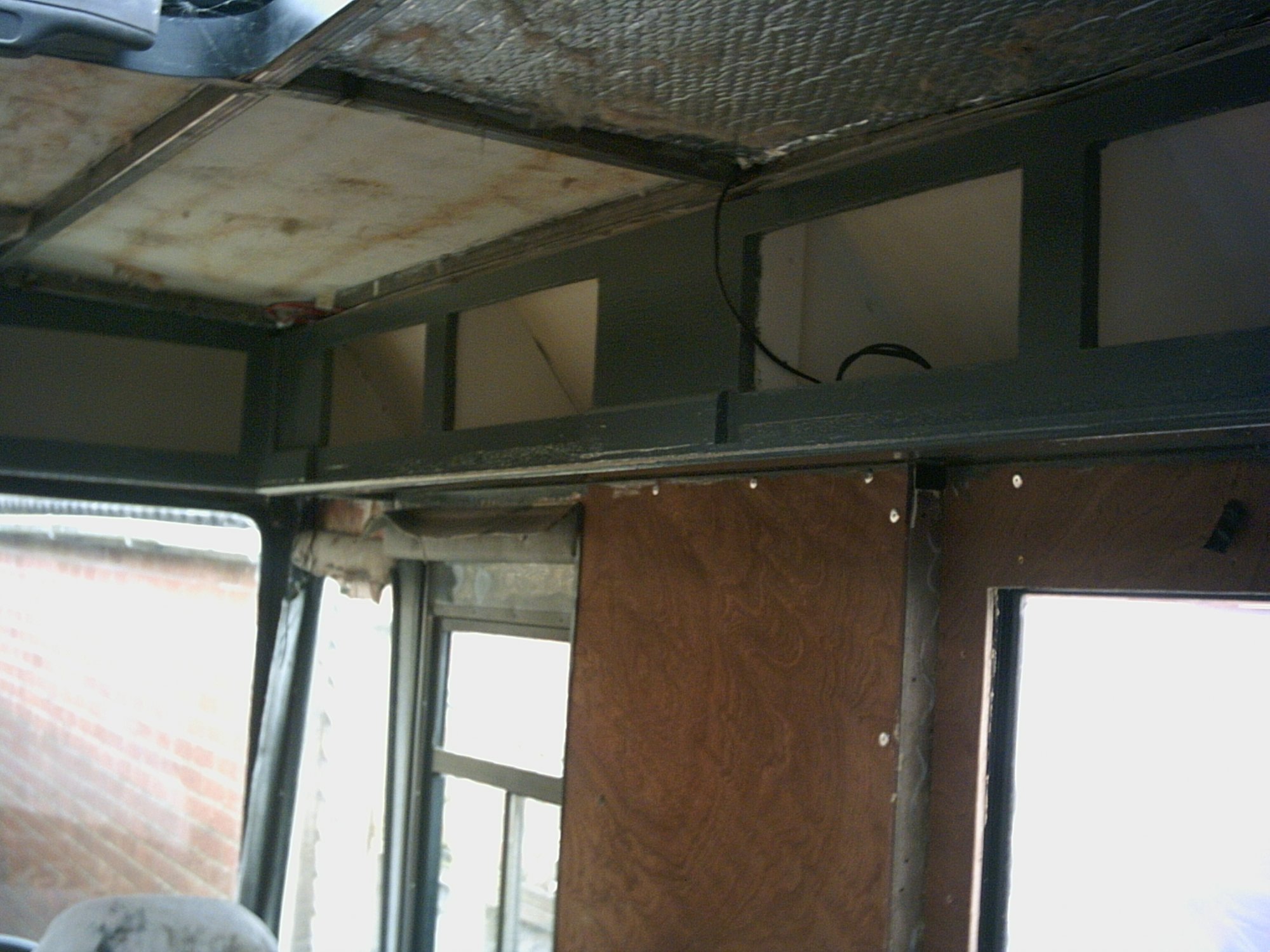

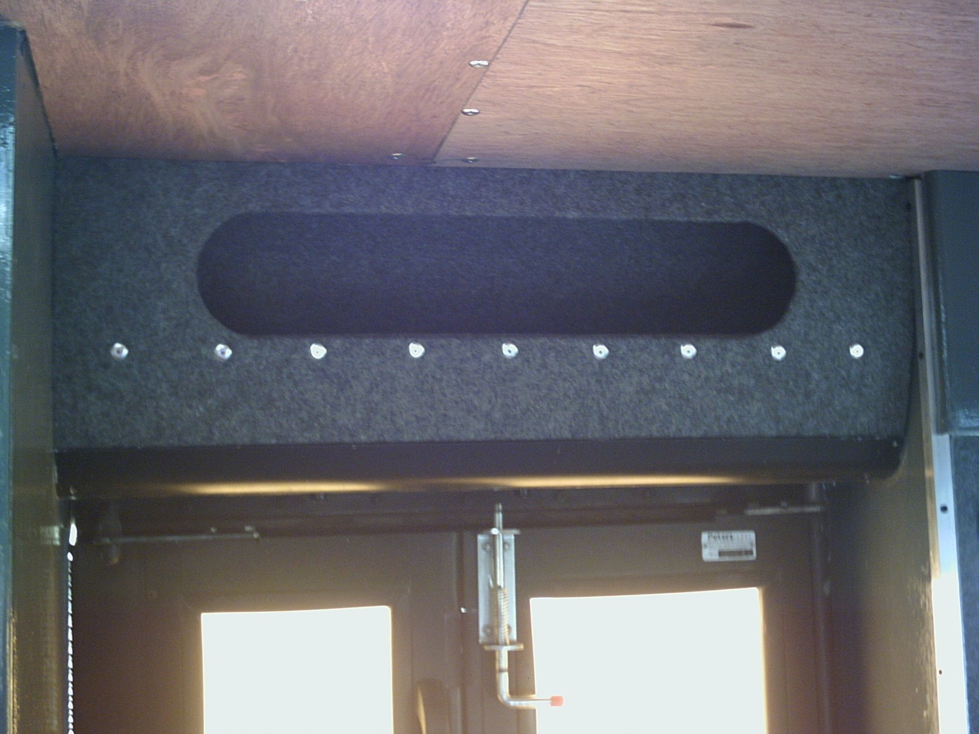

Rob you only require th spray the panel its going on, tape of/mask with paper around where you spray, lay the carpet on from top centre and using a dry paint roller smooth out down and to edges, any small areas dab with a dry paint brush, try doing a roof, been there had the ticket.

The videos I've watched say to spray both the carpet and the surface Trev?
Its a barstewart if you do but can be done and prob better, do the walls as i discribe, then carpet outside the van and bring in to hang, good luck rob.
