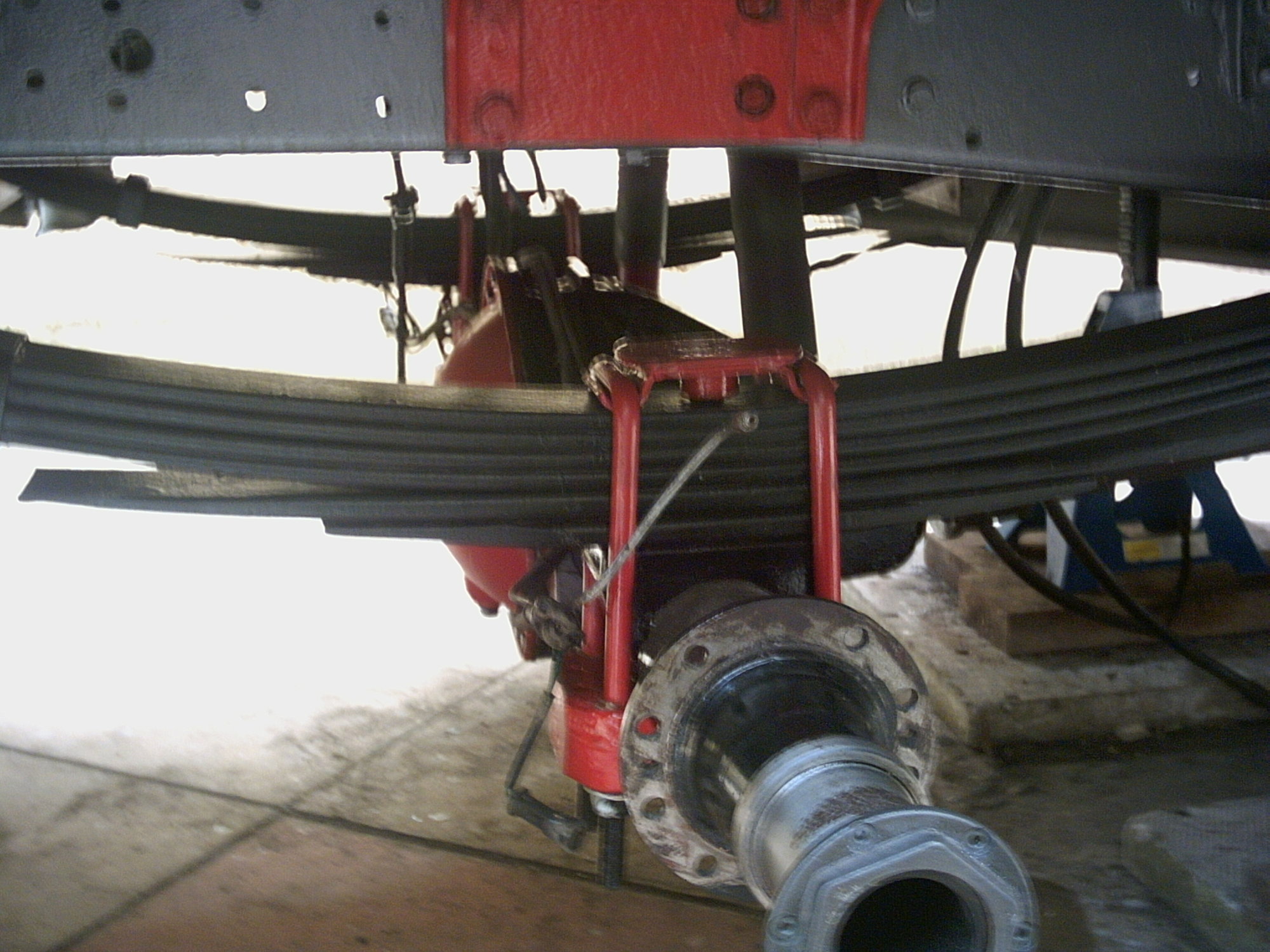

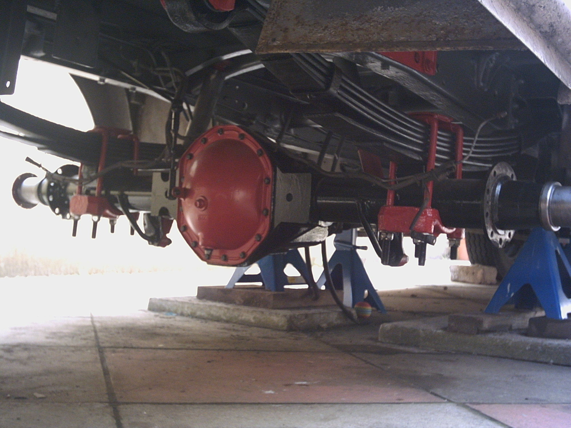

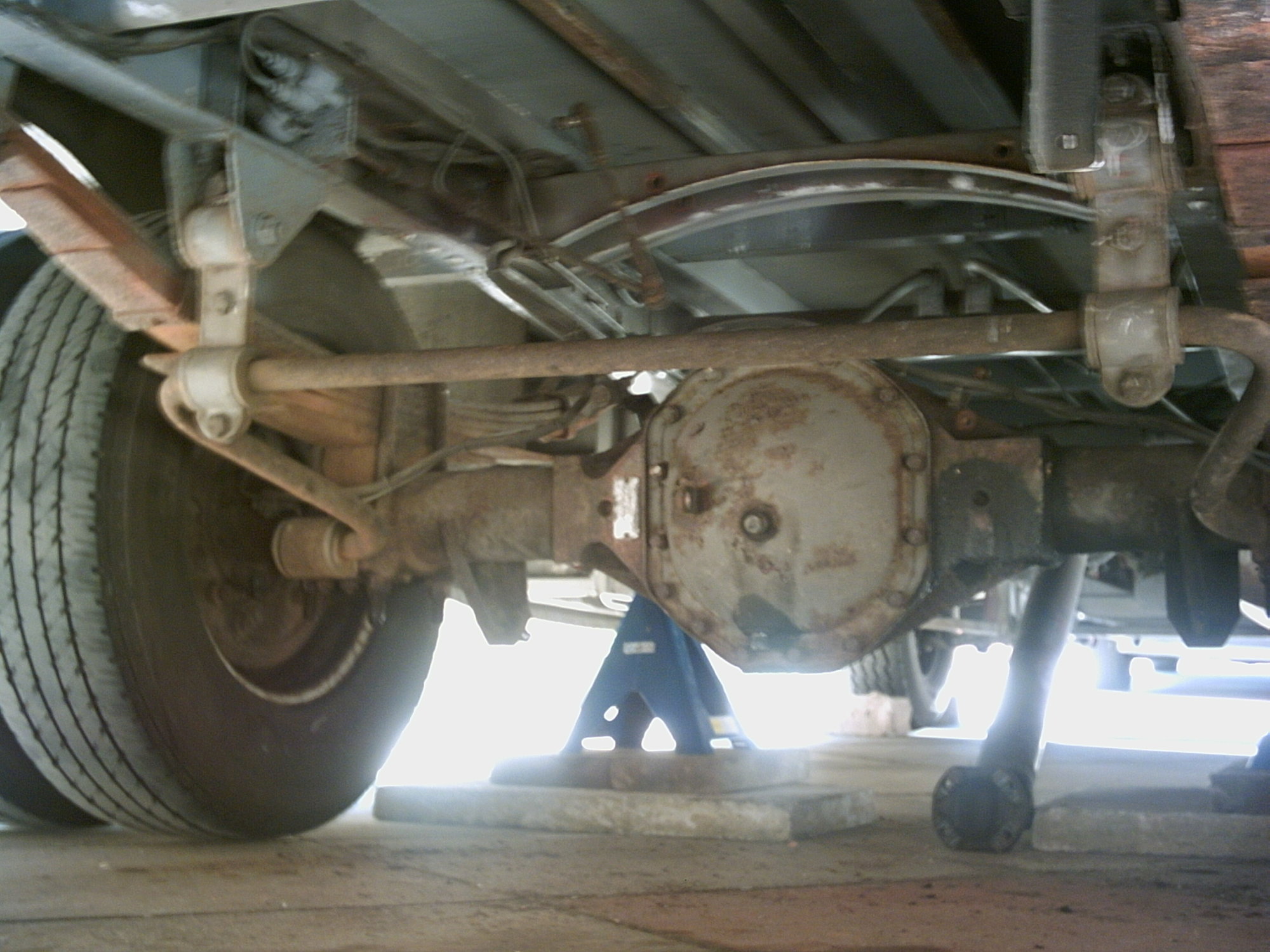

Yes i had to change the back axle as it was running 8/41 up to a 11/43 which dropped 1000rpm so i can now cruse at 56mph at 2500rpm

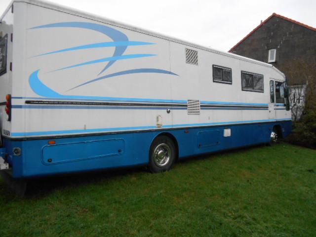

If I could cut a metre out of both of mine easily I would. Maybe we go places we shouldn't, but you do have to watch your bum swing down narrow lanes with stone walls. We have found some European campsite won't accept 8 metres or over.

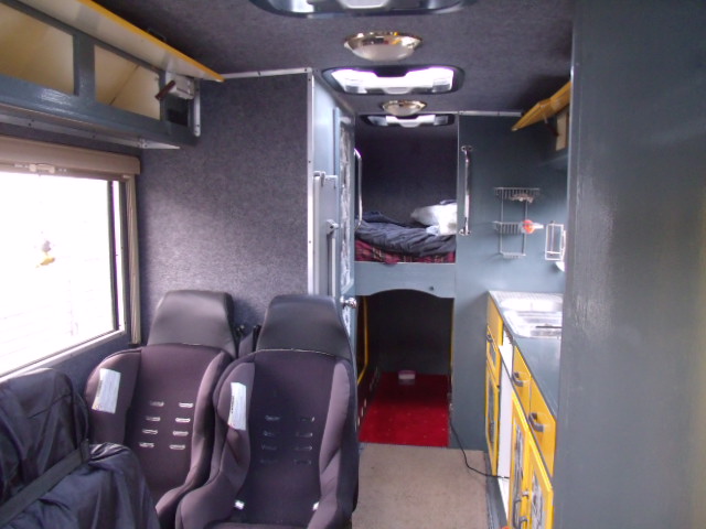

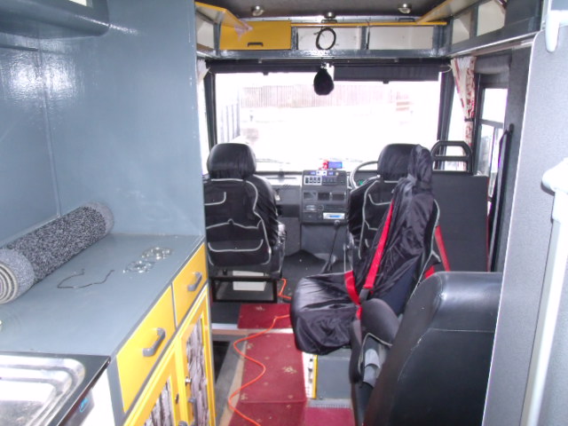

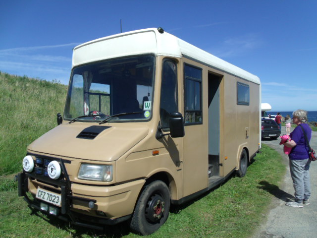

The last picture Trev posted is my Iveco in the early stages of conversion. 8m long 2.4m wide.
