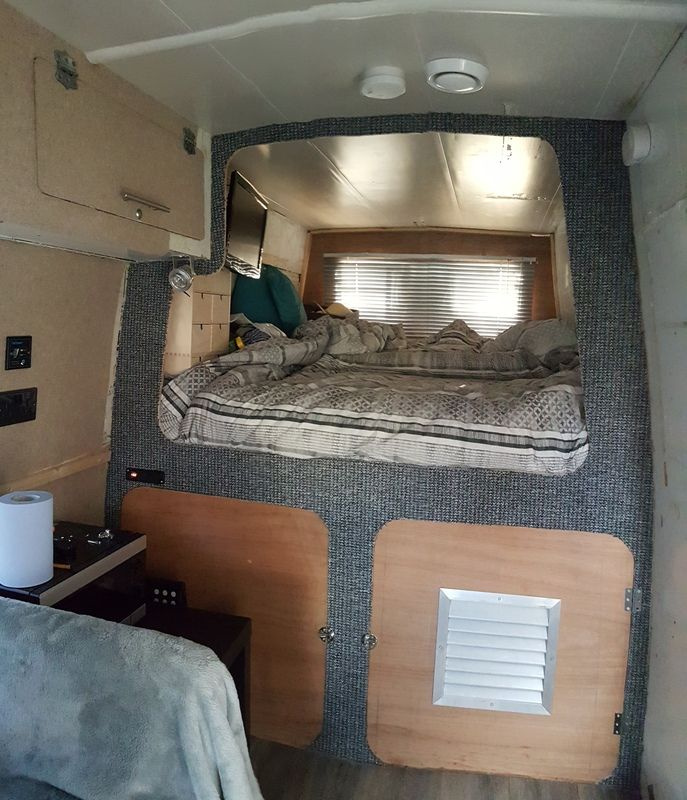

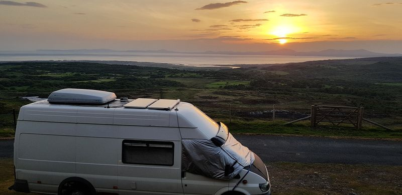

We spent about 3500 including buying the transit Jumbo....
Self sufficient power wise (solar/split charge inverter etc) and raised double bed at rear with storage under....
Worked for us as a very comfortouble tin tent....
Now changed to a Motorhome so transit will be up for grabs shortly....
Now changed to a Motorhome so transit will be up for grabs shortly.... View attachment 201195View attachment 201196View attachment 201197
