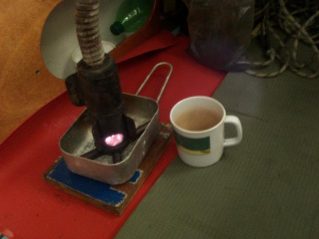

Here is a home made charcoal heater from a boaty forum. He uses an old spoon as a charcoal shovle to fuel it, and it has a chimney, part of which is made from a vacuum cleaner wand, to carry the fumes (& any CO if it isn't burning right). I reckon you could soak a couple of blocks of charcoal in Bio-ethanol to make it easy starting.
This pic was taken while the boat was on its trailer, it is normally well fastened in at sea. But a mini-charcoal burner offers many advantages for a small van or boat.
