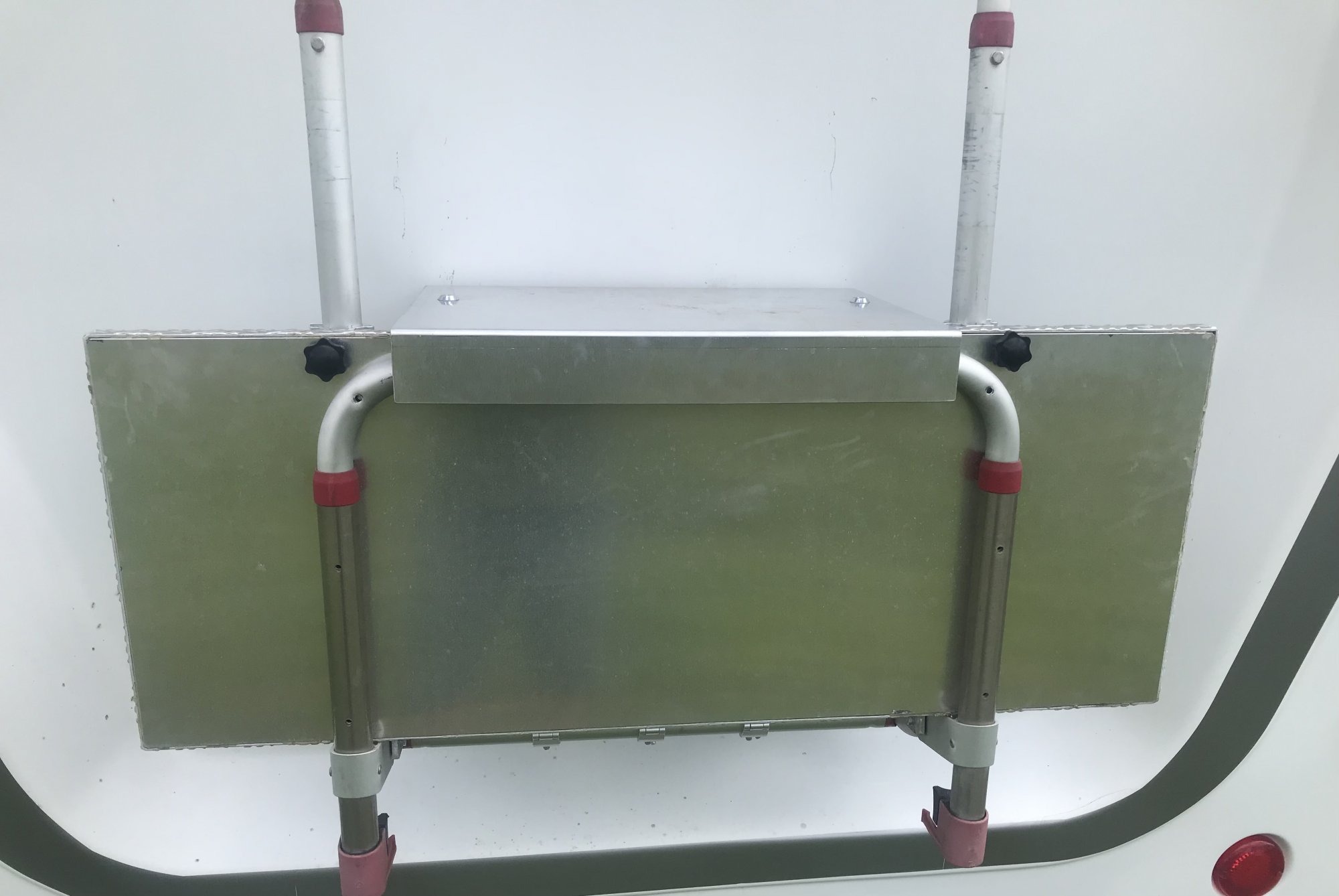

So it looks like I’m going to be doing a lot of wild camping, therefore I’ve bought a Honda 1kw generator, it’s mainly as a back up and I don’t want to keep moving it in and out, therefore my aim is to mount it permanently on the cycle rack.
I’ve already modified the rack to act as a fold down table to take a Cobb bbq etc, and today I’ve been sorting a design that allows the generator to be mounted behind the bike rack very close to the back of the MH with a heat shield and air gap.
The fold down table closes off the generator and locks, in addition the generator is firmly bolted in place and has a apple air tag within it and what we used to call an shot alarm back in my long distance driving days (don't ask please as I’ll just lie) which will stop any would be thief.
I’ve checked out the cycle racks capacity and checked that the fold down table and generator are well within its limits, but (this is where you guys come in) the rack is rated at 60kgs, the weight on it will be 42kgs, and most of that will be behind the rack so less leverage

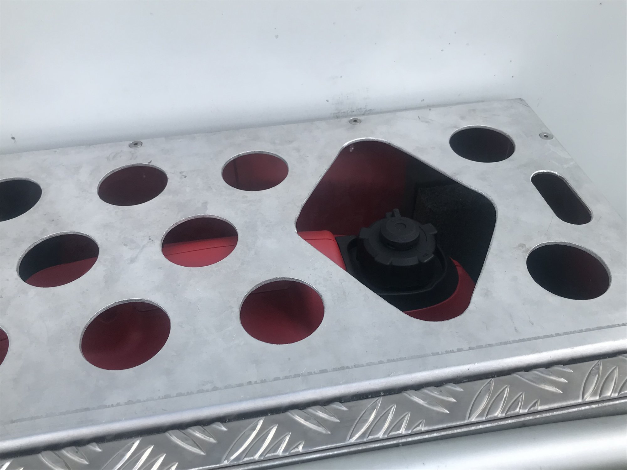

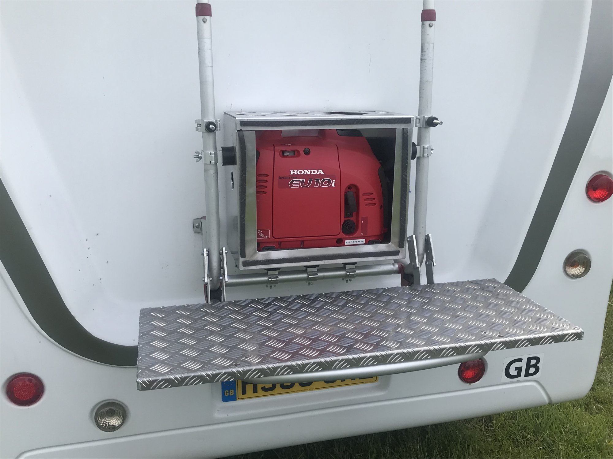

Sorted the vibration and sound issues today, box holding the generator mounted via cell clamps with anti vibration mounts, box has insulation panels with air vents and the exhaust is vented into a pipe with an exhaust box.

At Oulton Park this weekend and no hook up, managed to get the new Ginny box done in time and it works a treat, no vibration and almost no noise (there is some noise behind the MH, but no real issue, as my intended use is wild camping, and here you just run it during races which are much louder)
