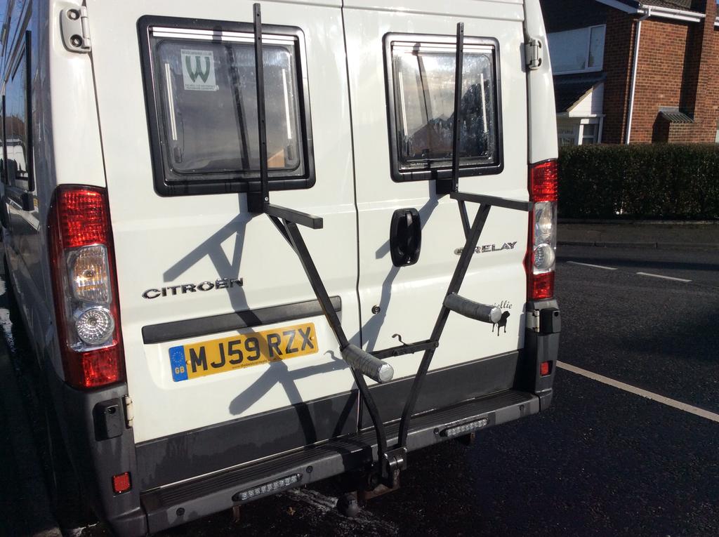

On the rear o/s door of my Fiat Ducato PCV motorhome. From now on known as Demi. I have a Fiamma bike rack. During one of this weeks torrential down pours, I noticed a damp area on the fixed bed. Off side, same side as the bike rack. The bike was on the rack.
I'm wondering if the weight of the bike is twisting the top corner of the door away from it's seal, causing the leak. There did look like there was evidence of that's were the water was getting through. I'm not convinced this is the best type of rack, although it's a bit of a looker.

Saw a French guy in Portugal with the Fiamma DJ rack that I used to have. One back door had visibly peeled away from the back of his brand new Ducato based PVC.
He was a racing snake with a small light bike on the rack but it was enough to cause this very expensive damage.
In my view they are not suitable for fitting to rear doors.

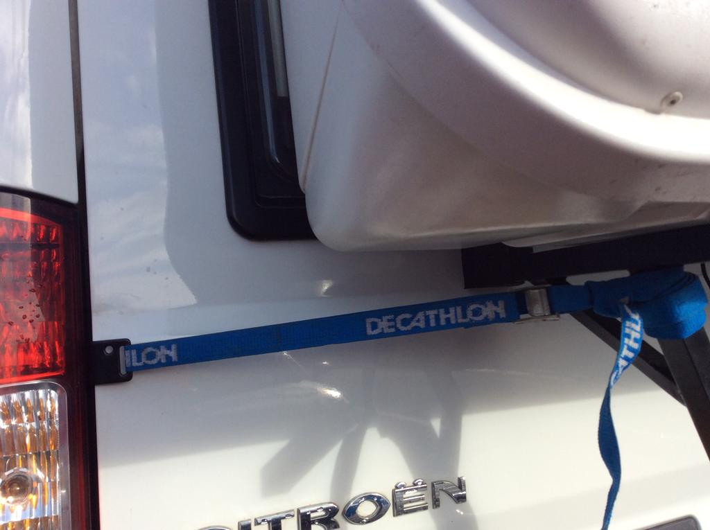

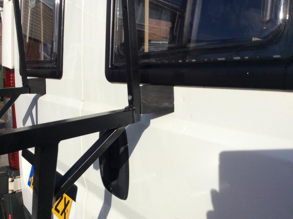

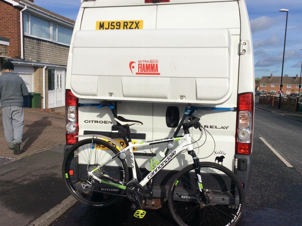

My bike rack fits on tow ball but I want to carry the back box as well so I got a mate to extend the rack to take the back box as well .I put rubber block between the rack and back doors then used straps to pull the rack against the doors keeping everything in place.C33E82B1-095D-41F5-8A87-CEC0985AEB85.jpgCBCEBA9E-D79D-4788-9536-63789205C23F.jpg1B3A6992-5C28-409B-B606-C500EC69DAE1.jpg4076966E-C104-4ABA-9FB1-C83562446128.jpgnothing has fell off so far lolol.
My bike rack fits on tow ball but I want to carry the back box as well so I got a mate to extend the rack to take the back box as well .I put rubber block between the rack and back doors then used straps to pull the rack against the doors keeping everything in place.View attachment 67582View attachment 67583View attachment 67584View attachment 67585nothing has fell off so far lolol.
Yes I found with 3 adult bikes the towbar bike carrier wanted to flex, and I used a strap back to the car to support it.
