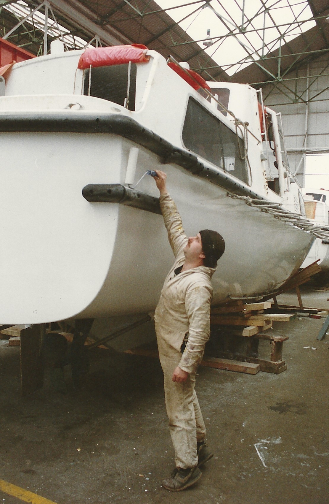

HA you want to try doing 12 of these babies never mind cars.View attachment 83147
Best option i think - used to work on lancing industrial estate late 70s early 80s firm built and sprayed lorry bodies used to be synthetic paint very dirty job paint went everywhere - taped overall wrists and legs up still got through - oh and vaseline on your face to remove overspray = pay was good though with the bonus double your wages some weeks
No air feed mask, vaseline very mucky,yep truck painters used single pack synth,dont know why as two pack would be better and fast dry.(y)
