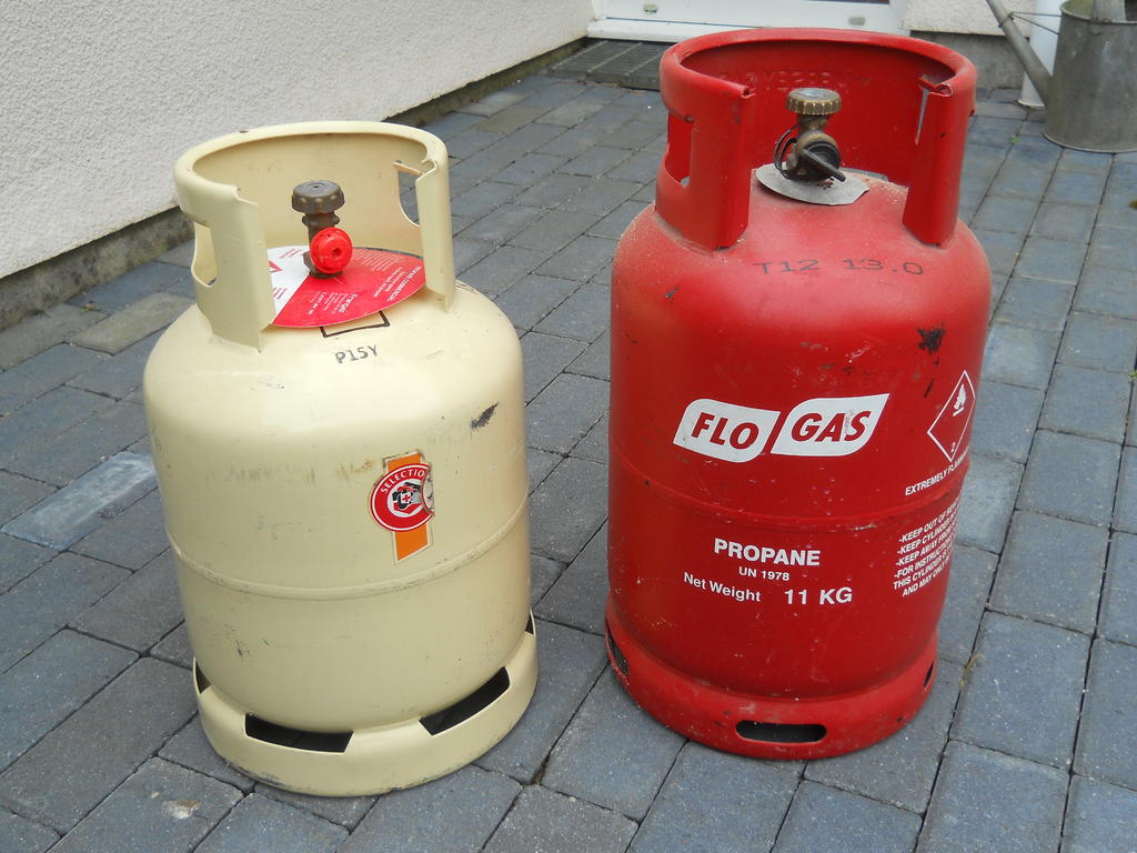

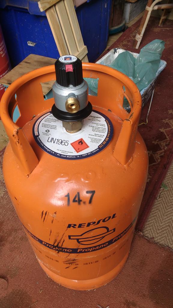

Intermarche a super market chain are charging a whoping 1€ deposit you,ll need to change your pigtail if you,ve a bulk head regulator picture is of French 10kg bottle with English Flogas to compare sizes other is a Spanish Repsol bottle with the adaptor required it fits the French pigtail you'll have to get for French bottles from memory a Spanish bottle was approx 10€ deposit Links to Hose and Spanish Adapter

Thanks for that for some reason i thought cost was prohibitive, we left with full 13 kg and 11kg bottles in the gas cupboard and a 6kg in the wardrobe not knowing how much we would need, very pleased to return having used maybe 10 in total
