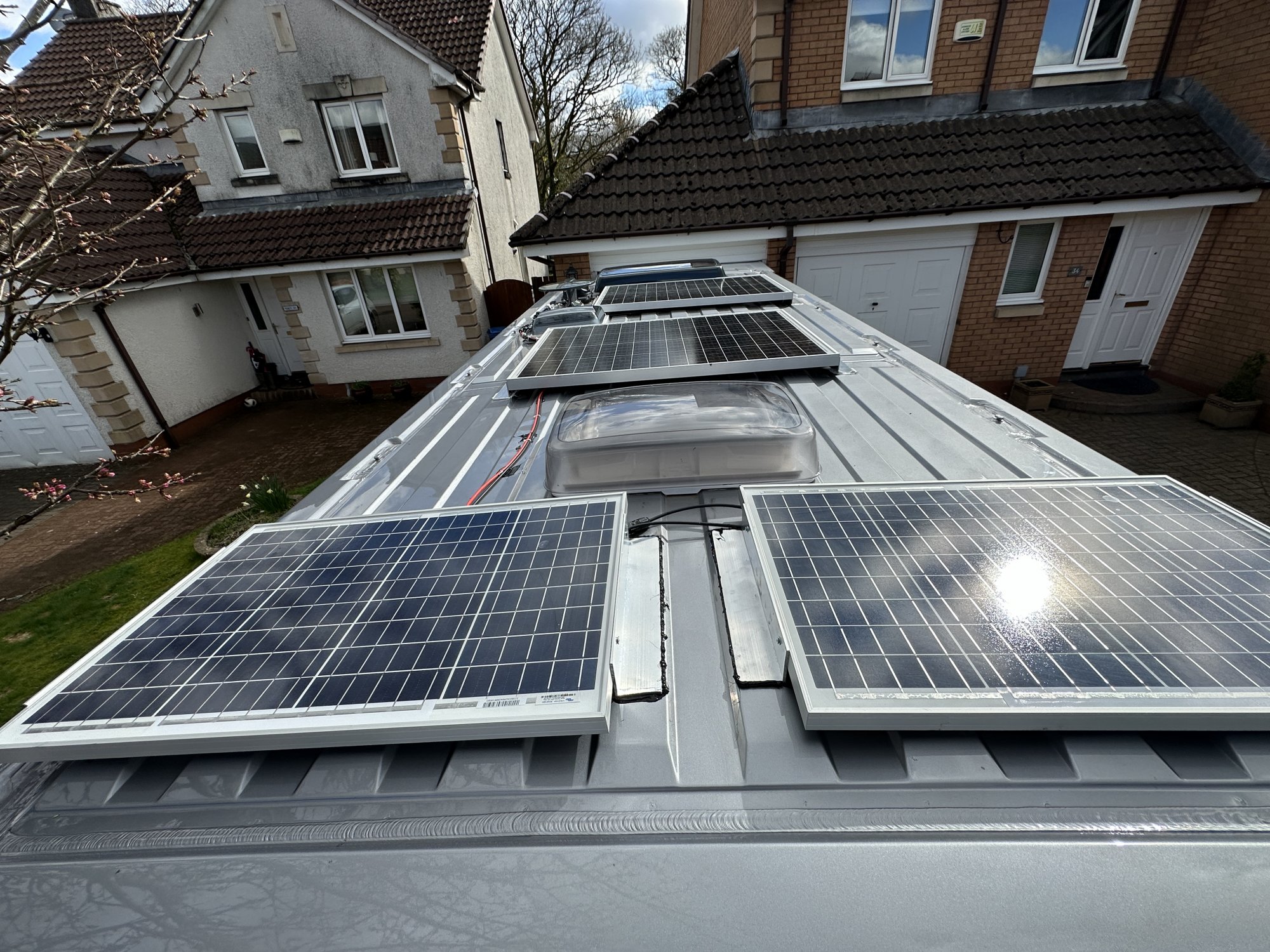

Here’s mine 2 ecoworthy 120w panels, with two victron 45w panels at the rear.

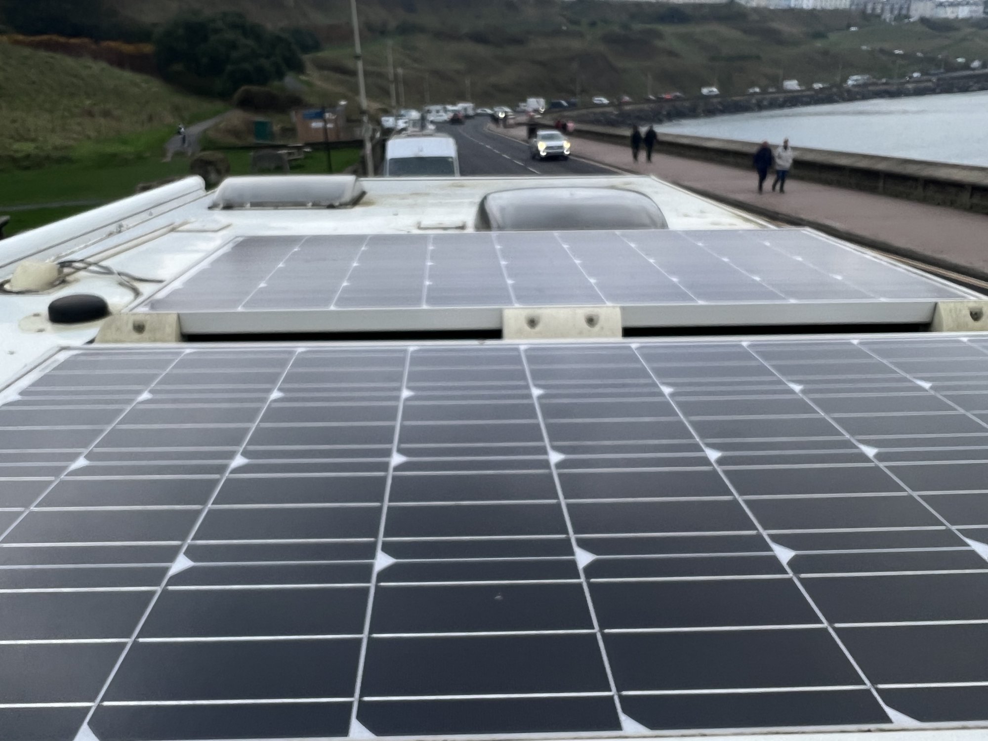

I believe there are different plastic mounts, the ones I used are solid so quite a bid contact area. On my 150W panels I used 4 plastic corner mounts plus two plastic centre mount on each panel and the Sikaflex that Sika Tech dept advised after I told them what the van construction was (I think it was 521 Architectural but too long ago for me to remember, it was £24 a tube back then though :( )
Sounds similar to this Burstner? Used a mix of Corner and Centres depending on what fitted.
Additional 120W PV Panel by David, on Flickr
