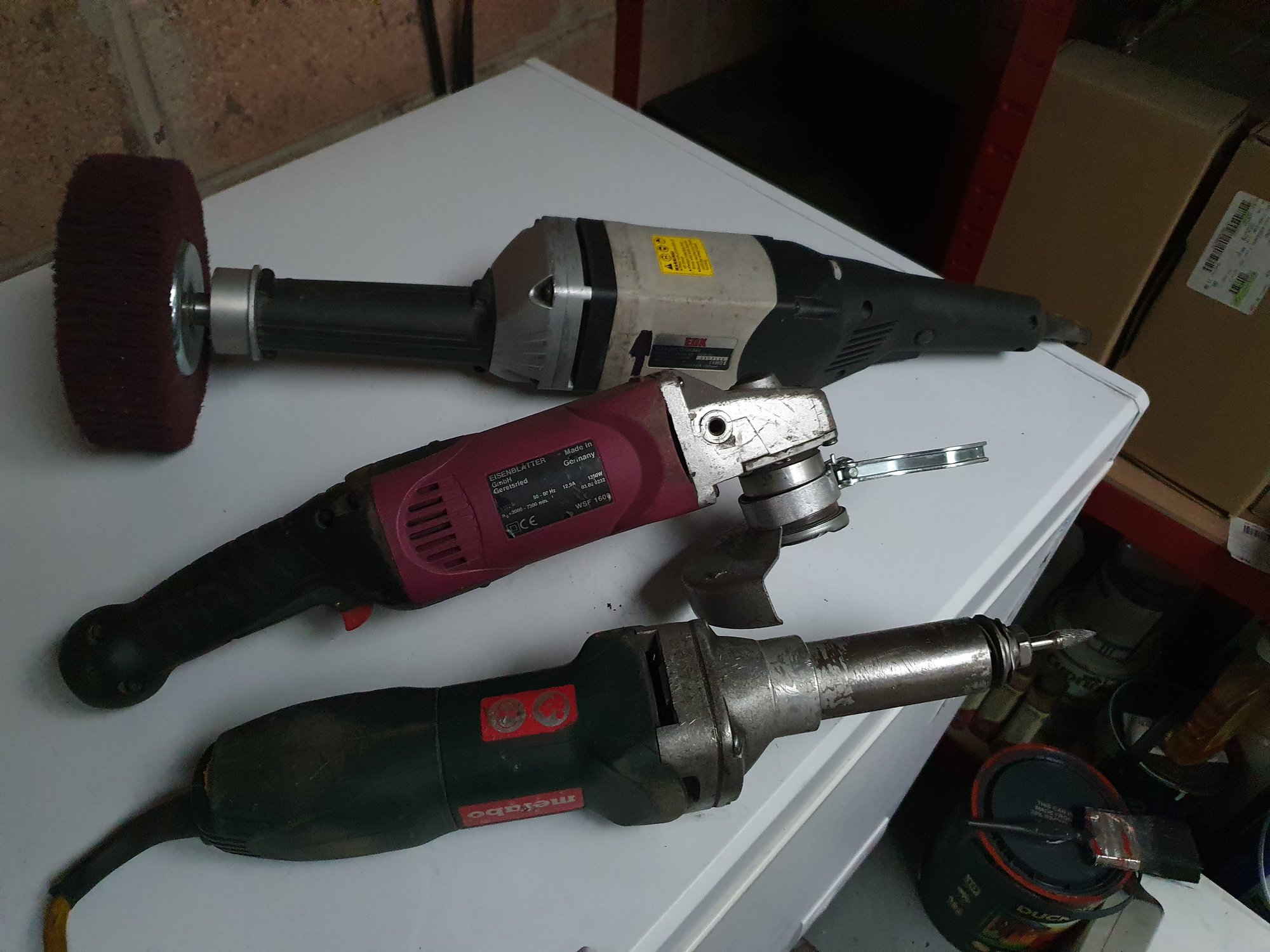

When you go into the finer finish most are vari speed.
