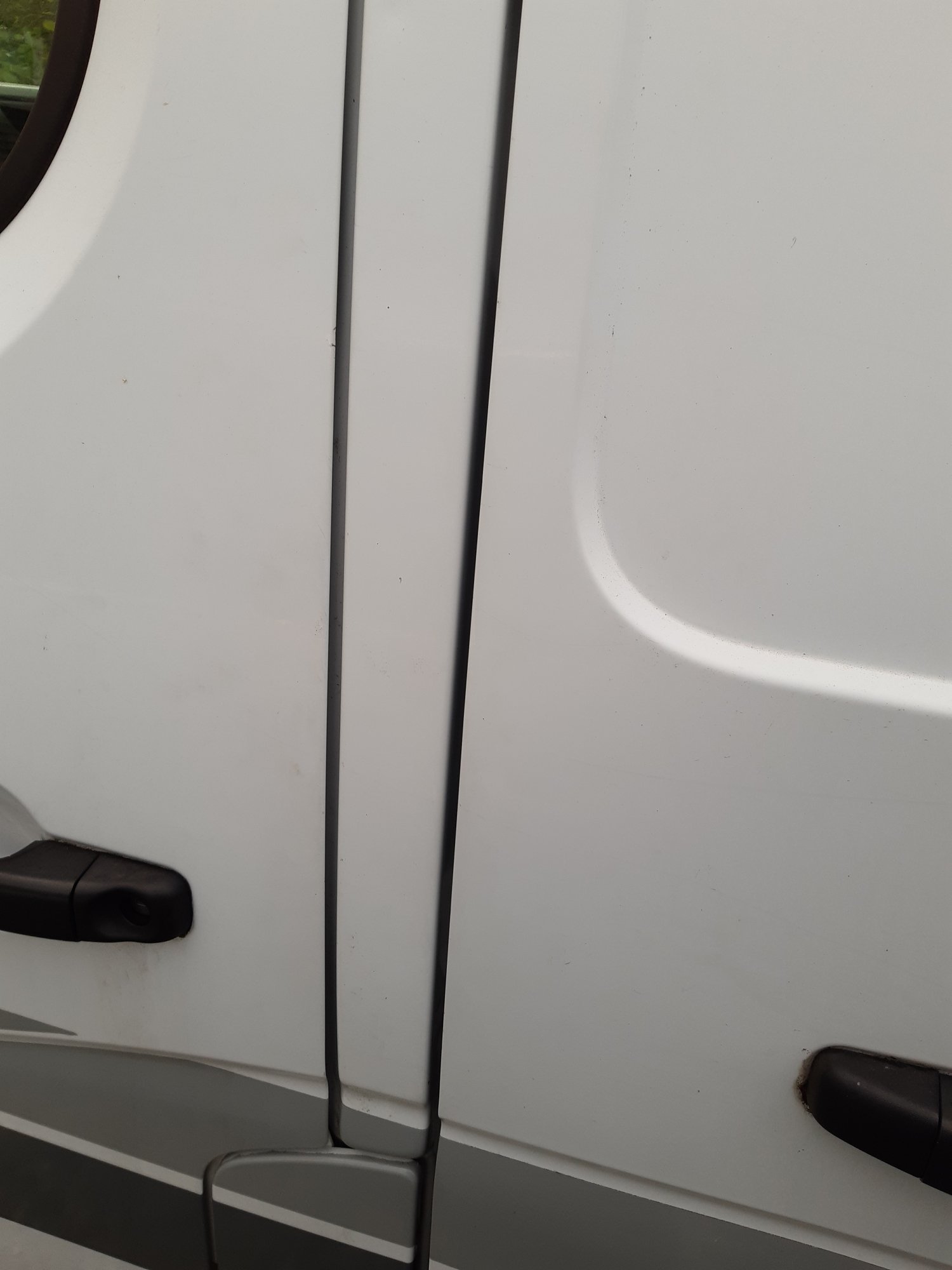

I have some awning brackets which I want to fit to the side of the van so the feet on the legs go to the van rather than the ground.
This gives me a problem in that the left hand one can only go in one place which is on a thin metal pillar between the passenger door and the sliding door (2012 Renault Master 2.3 DCI). The problem being that if I drill into this pillar, I can't tell if there are any electrical wires inside which would be a major headache if I damaged them with the drill/screws.
The other option would be to Tiger Seal the left hand bracket onto the van which I think would be strong enough providing the paint holds out?
Any suggestions gratefully received.

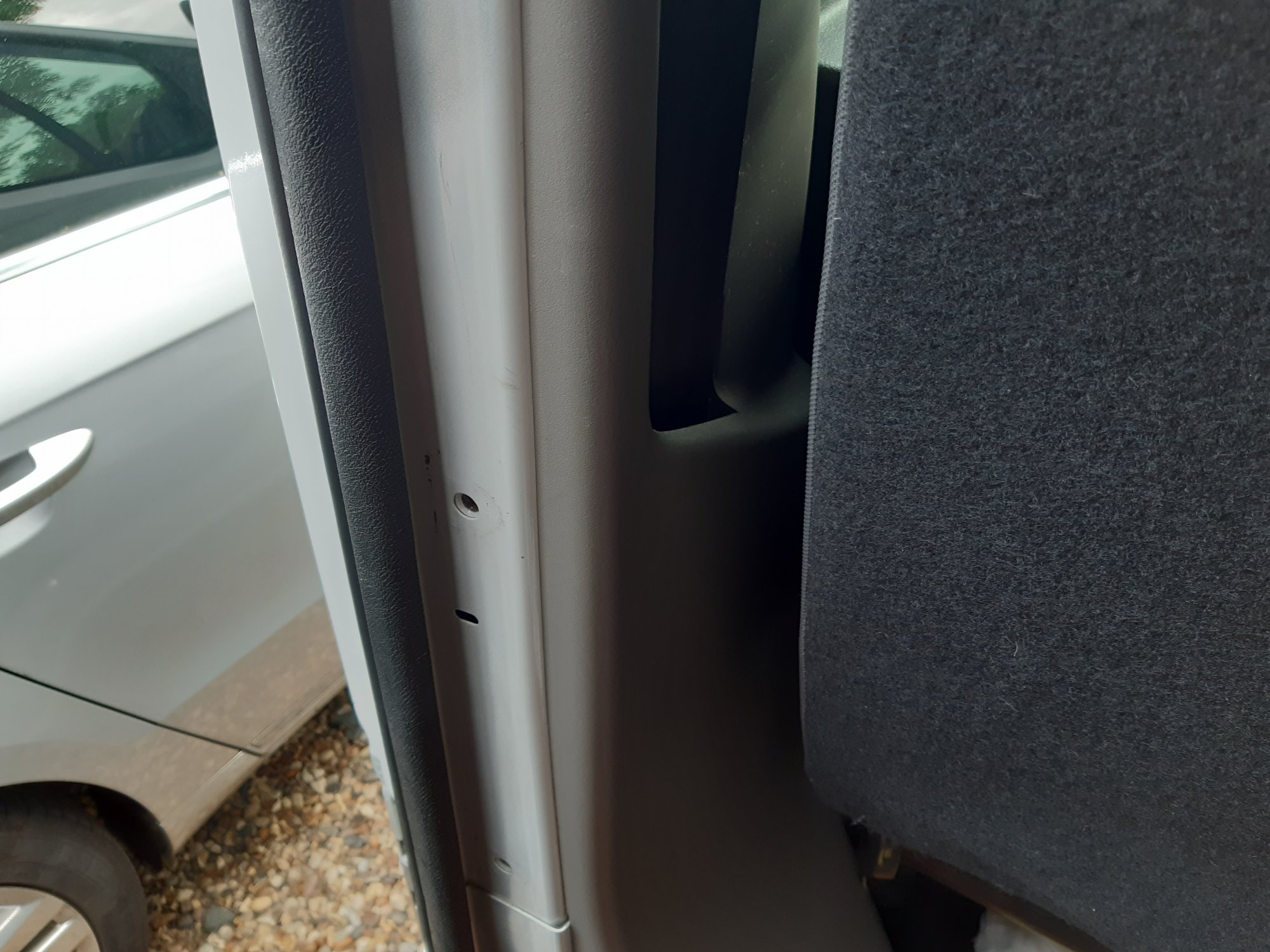

Just checked though and the seat belt appears to run into a plastic moulding inside the van rather than in the pillar itself which I think would be too narrow for the belt.
Not sure if this photo makes it clear;
The B Pillar is quite a void. I am not familar with the Master's wiring, but what I CAN say is that the passenger (on RHD) B Pillar on a VW T5/T6 houses a major part of the wiring loom. and there are countless wires going down and up it, bundled together. Other vans/brands could be similar?
I would have thought adhesive would be good though (never used Tiger Seal - I am a "CT1" person - but heard it is very good) and I guess you could use a very short self-tapper (to avoid a drill bit going right into the area) into the pillar for extra mechanical security?
