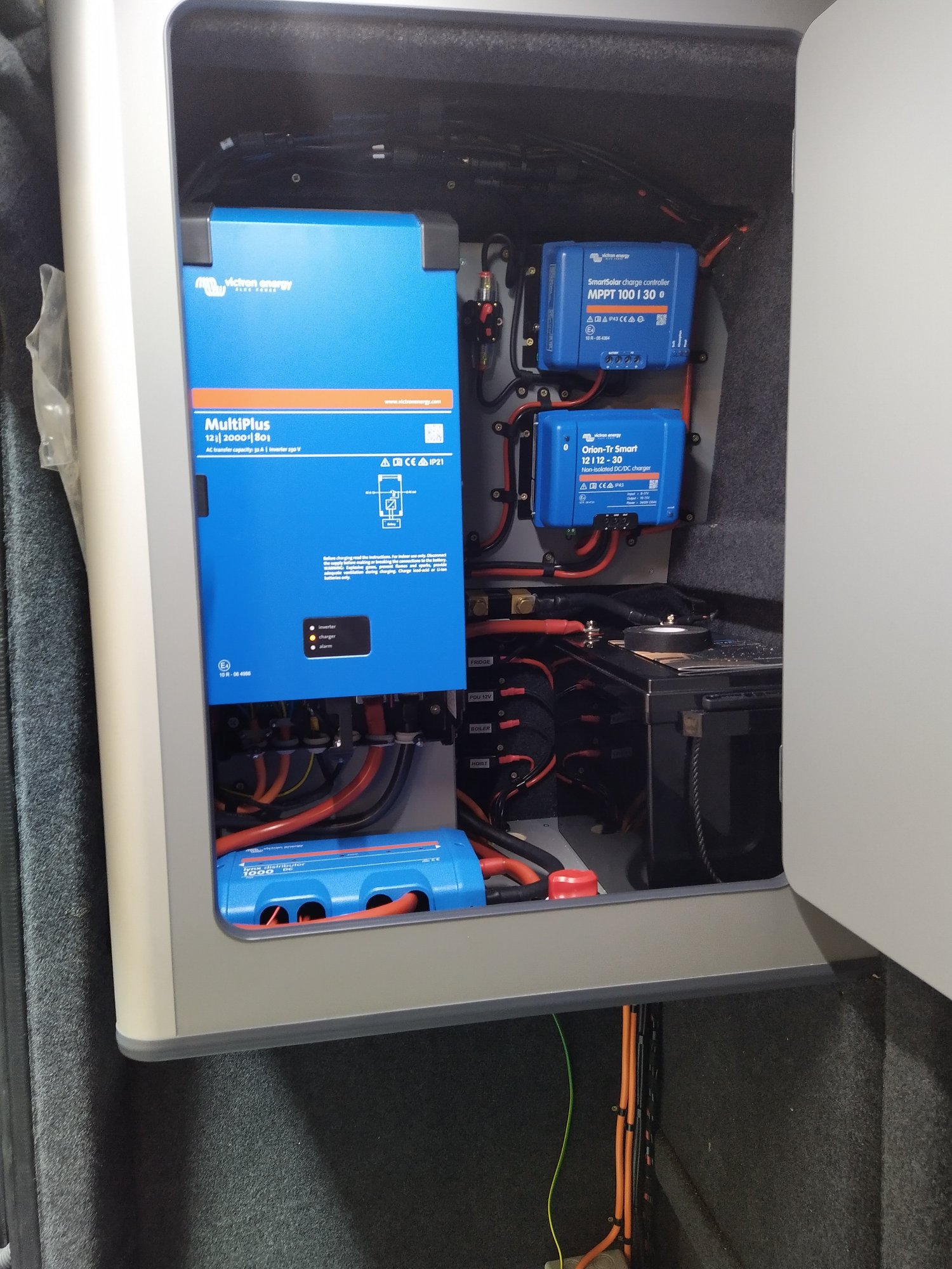

I can personally recommend this firm, after some enthusiastic and failed electrical work, these were recommended to us and the chap was brilliant and everything in the oppy tin tent works wonderfully
