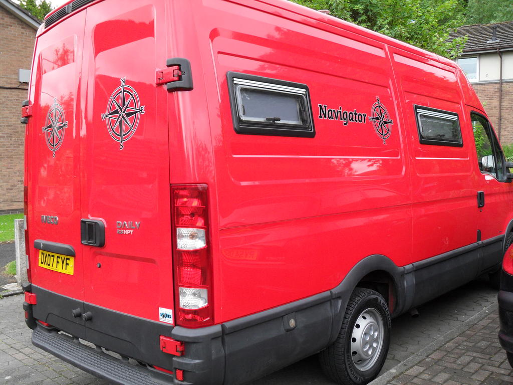

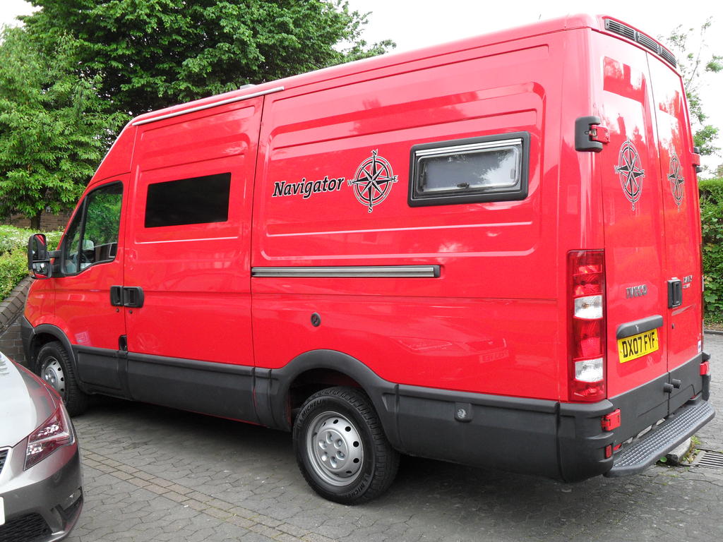

Nice windows
Hi I like the windows, what size are they as I am still trying to decide what size to get so as not to let to much heat out

The windows are Seitz S4, the two at the back are 300x650 and the other one is 300x900, sorry it took a while, not been too good, fighting fit now.:dance:

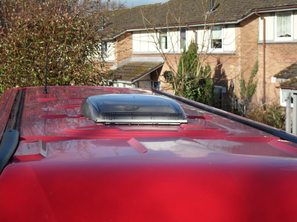

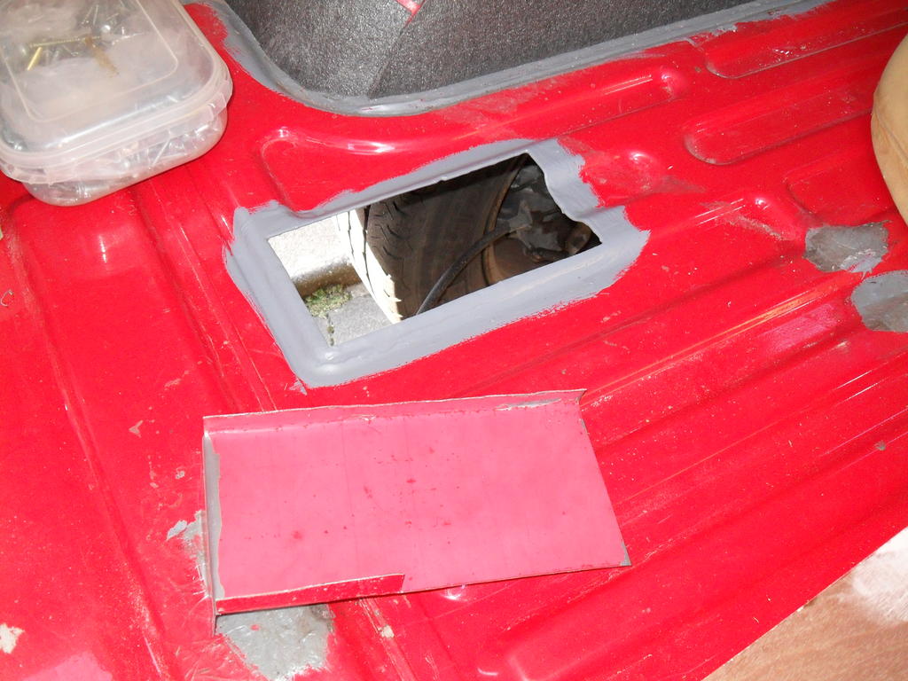

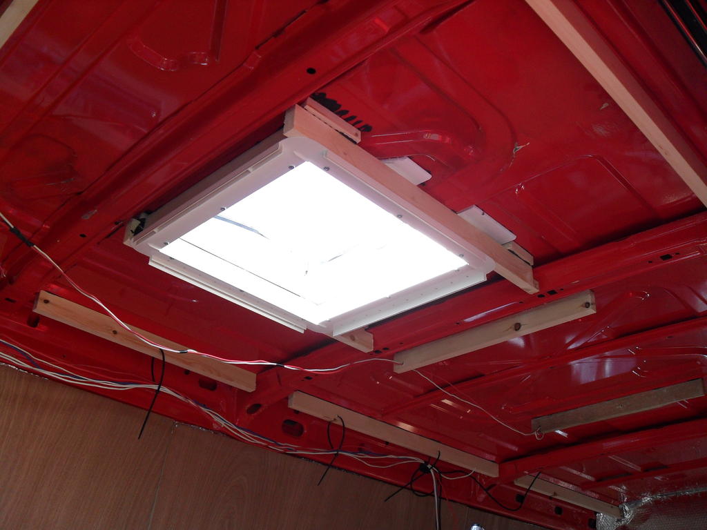

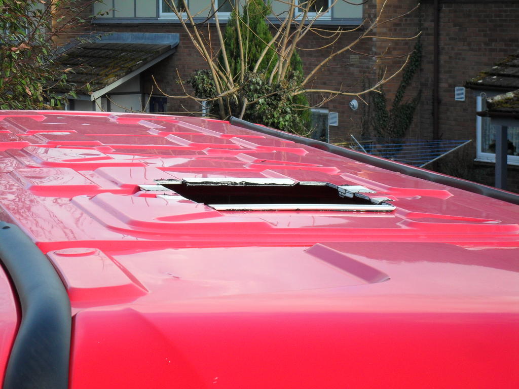

I always rename my pics, but by removing the .JPG it becomes an invalid file, deerrr. So, lesson learned. Onward - have installed a new aerial at the back for new radio, then started on the hole in the roof for the mini-heki. Three levels had to be dealt with, but I had previously been to a local double glazing firm, who let me have a ratch in their scrap pile for some plastic strips. Fairly straight forward, but time consuming job and eventually got the heki installed. The hole in the floor is for the Trumatic heater, and I will make a shield, part of which is next to the hole, this is to prevent all the crap off the wheel getting in the air intake. Starting to lay the rest of the floor and putting in the electrics.:hammer:

I was annoyed on Friday as I discovered my Mini-Heki had developed a mini-leak!:mad1: So I stripped the whole thing, cleaned it up and re-instated it, I did find the leak, and it was TINY, but that's all it takes, job done. Have made the floor fitting for the Trumatic heater, alumium would have been easier, but I used one of the window cut-outs. Today was all about tackling the over-cab space, which is nearly done, the struts are there till the Stixall cures, and it seems the flash didn't fire for the picture :confused:
