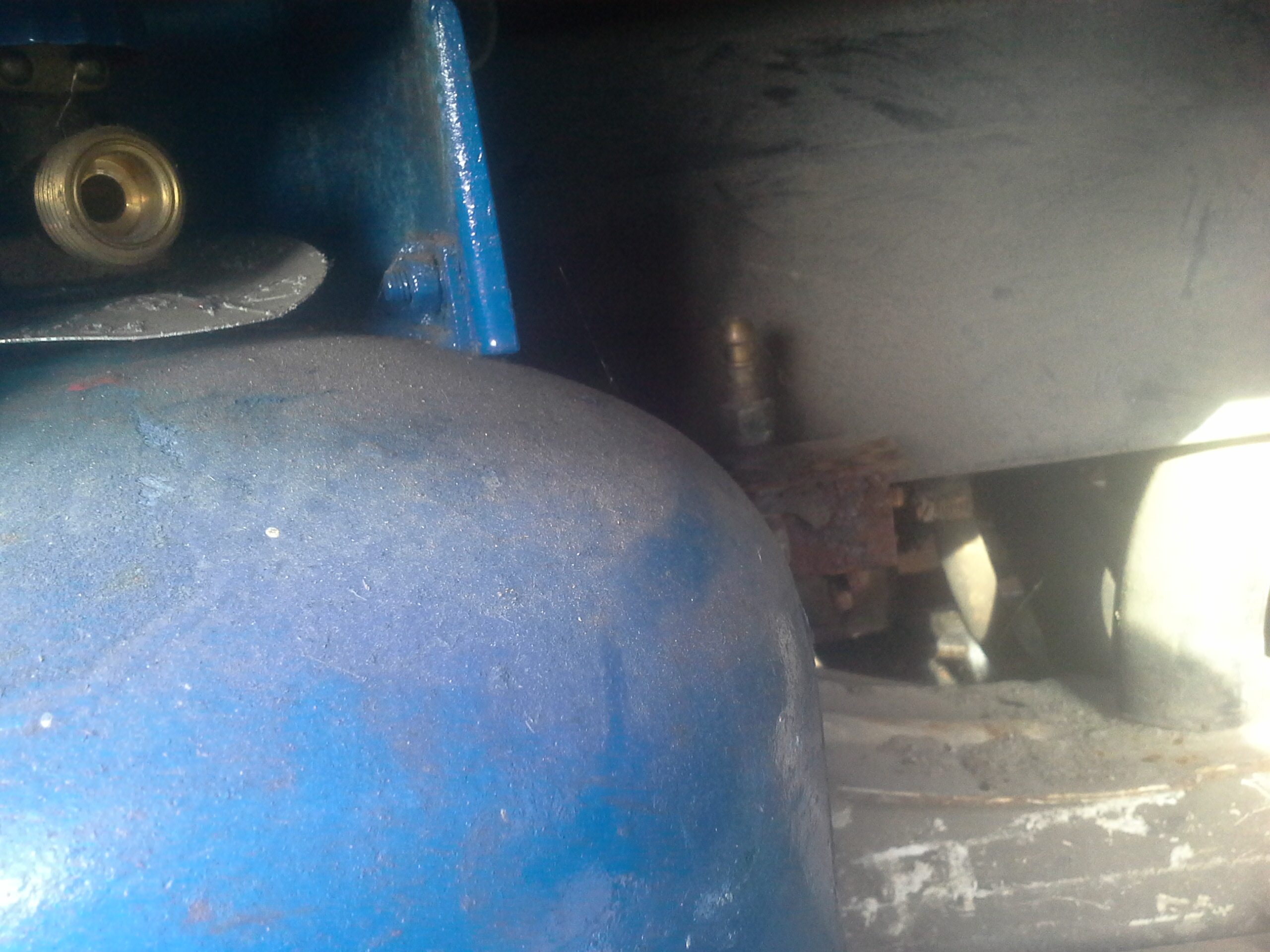

Disconnected at bottal/ cylinder by hand.. In the new van not needed ! but the old vans left on unless in storage bambi 1988 still connected as ive lost 5kg spanner. if I remembered right. Ill go and look ?
Thanks ive removed orange pipe too.
So mines all good.
