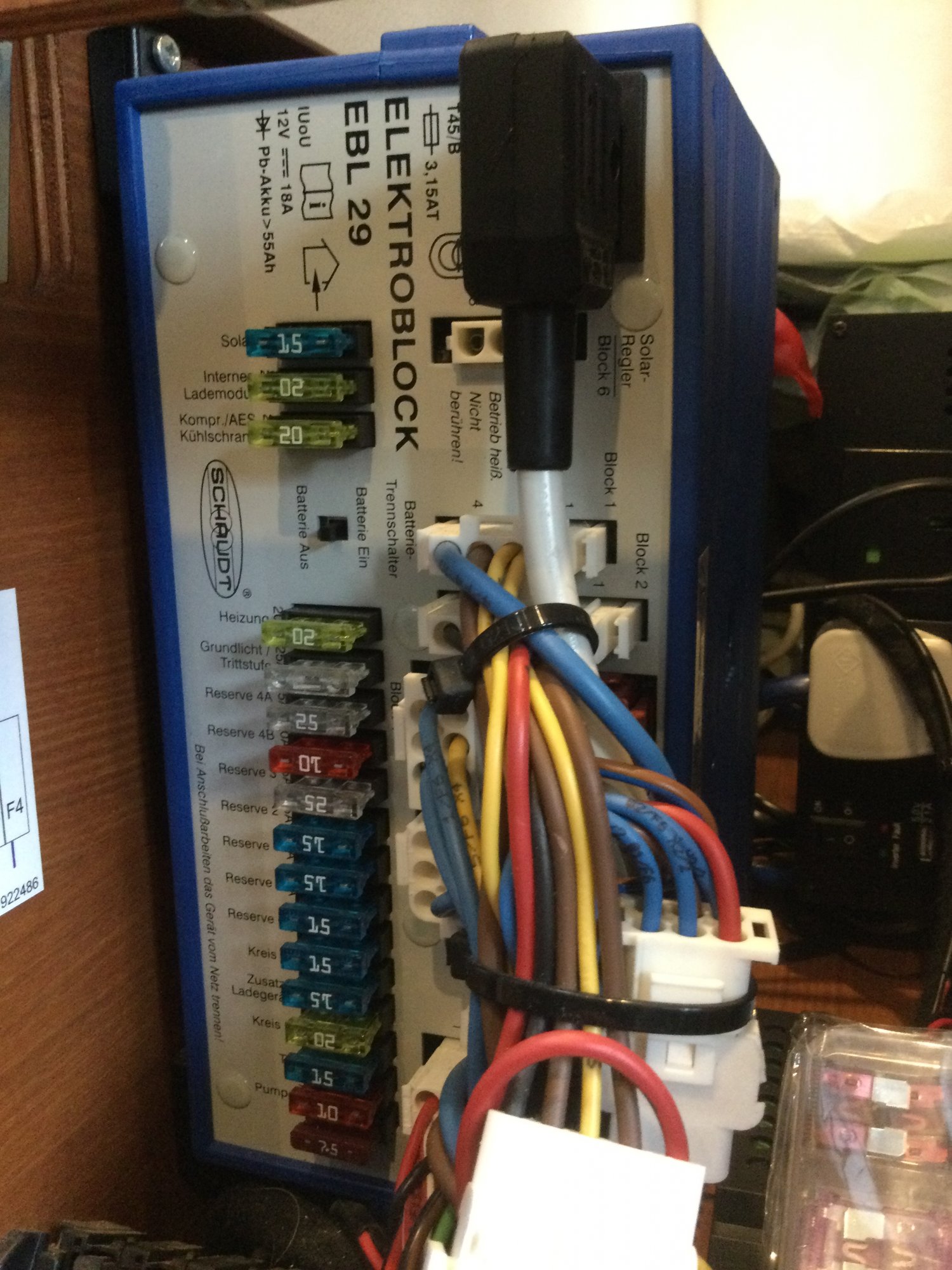

The wiring from the Solar panels to the batteries is currently through the Elektroblock, but this is being changed in February to a stand alone Voltronic mppt unit by my local Motorhome service center. They (A&E Leisur) checked the current set up and and said it was working well? I hope the alteration to the controller will help.

What year is van? Does it have a smart alternator and B2B charger?
The van is a 2014 model B534 on a standard Fiat 2.3td chassis. I am not sure, it’s not showing in the handbook as it’s showing that everything electrical goes through the elektroblock system. Is there an easy way to check?

If the charging only goes through the Electroblok then that will be your limiting factor, you don't say which model, but typically they only output 18amp, so fitting a larger alternator will make no differance.
The block is an EBL 29 but I appreciate the output won’t change so I will be interested in the change in February when it goes through the mppt controller only. Thanks 😊
