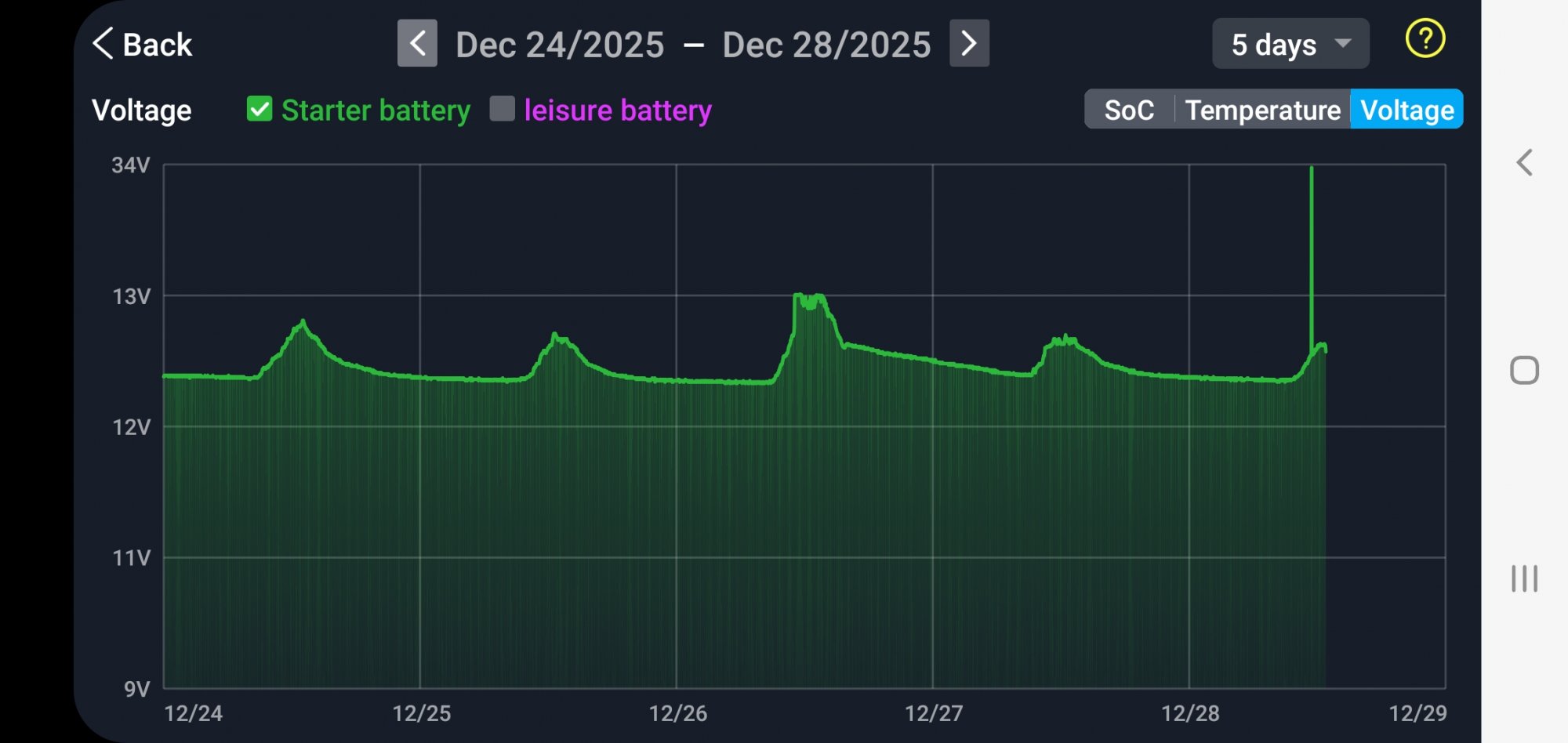

Thanks for the reply, the Leisure is charged by solar but the starter isn't, at first glance this morning the van EC board suggested the power was down on the starter but a multimeter measured 12.7V which dropped to 11.4v when the ignition was switched on. So I made sure it had a charge before any attempt to start it.

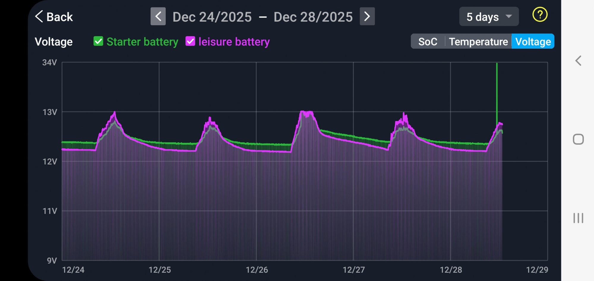

What is puzzling me right now is the LB new a few months ago is dropping lower than I expected in relation to the VB.
I think that the leisure battery has always dropped slightly lower than the starter battery overnight Kev? Different battery type ( AGM) and there's a slight load on it overnight from the solar controller and the vans PDU electrical system. Not much for either but it looks like it's significant in your case this time of year. I think you should switch on the EHU, then by looking the new graphs we can see just how low the batteries are currently dropping and therefore if you've got enough solar at the moment.
Those figures don't appear to be too bad actually assuming that when you turned on the ignition it was powering the glow plugs? (Light on the dash that goes out after a few seconds).
If you've got a couple of hundred watts of solar or more then you'll probably be able to keep both batteries topped up over winter without using the EHU. You'll need to have a decent battery maintainer fitted, something like the Ablemail AMT12 that Steve mentioned above. Alternatively if you're DIY inclined here's the link to the Gizmott unit. It actually maintains the starter battery better than any other commercial device and the parts cost about a tenner.
