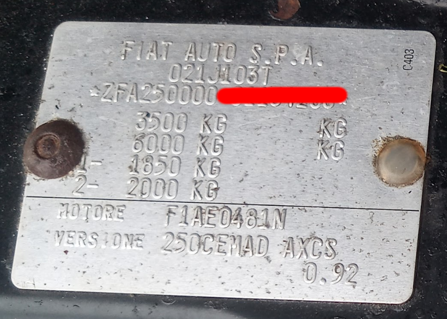

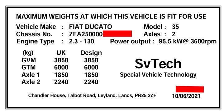

Something that might be important to you or to consider .... My Fiat Ducato original plate had a GVW of 3500 with a second weight (i.e. the GTW) of 6000. So in other words a towing limit of 2500Kg.
When SV Tech did my new plate (with GVW raised to 3850), they significantly reduced the towing limit down to 1040Kg. This was incorrect (and in fact would have likely prevented me from getting a 'toed' car should I have wanted to).
The issue was I think a combination of a typo on a Autotrail Brochure and SV Tech not fully (IMO) researching the vehicle details. To resolve this, I (the customer) had to check the technical details with the vehicle supplier in order to ensure the new VIN Plate had the correct numbers on. While all ok at the end, it shows the importance of knowing your own details and making sure others are aware also and not just accept what is given.
If you are interested how the VIN Plate would look/differ post upgrade, here is my example (old then new, (issued after corrections applied)).

View attachment 147795 View attachment 147796
Thanks. Looks like I'll have to be on the ball.
