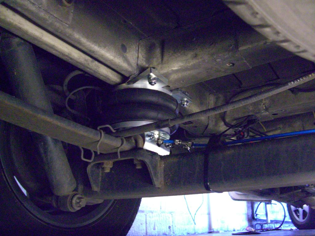

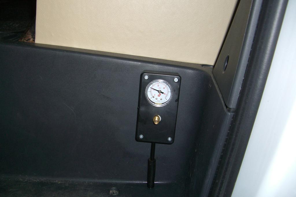

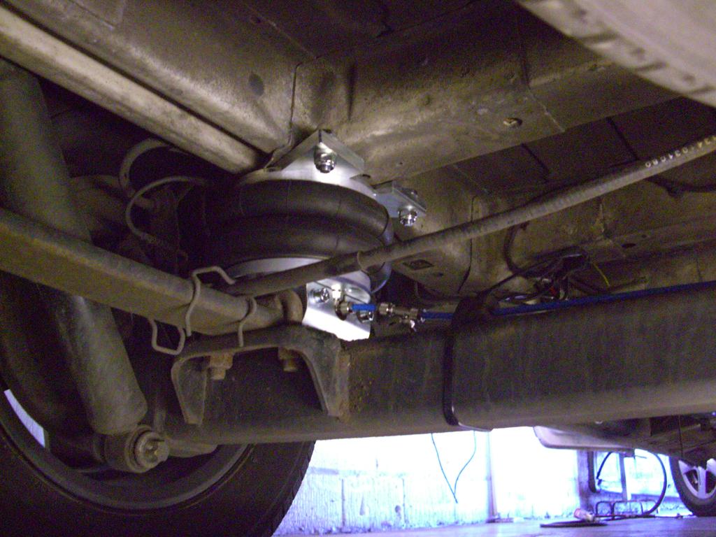

I've got a fiat based hymer b544 with air suspension fitted ,find it great ,take the body roll away but I've also fitted new rear shockers.remember the shocks reduce the body roll so make sure your shocks are ok or it would be a waste of time and money to fit air ride

I found it certainly does stiffen the ride, roundabouts and those log sweeping exit bends from motorways, it's almost as if I'm rails now. It does also change the ride height, in my case about 80 mm difference at the rear but I think that varies depending on make/model and type of air suspension fitted. I have the Dunlop system.
