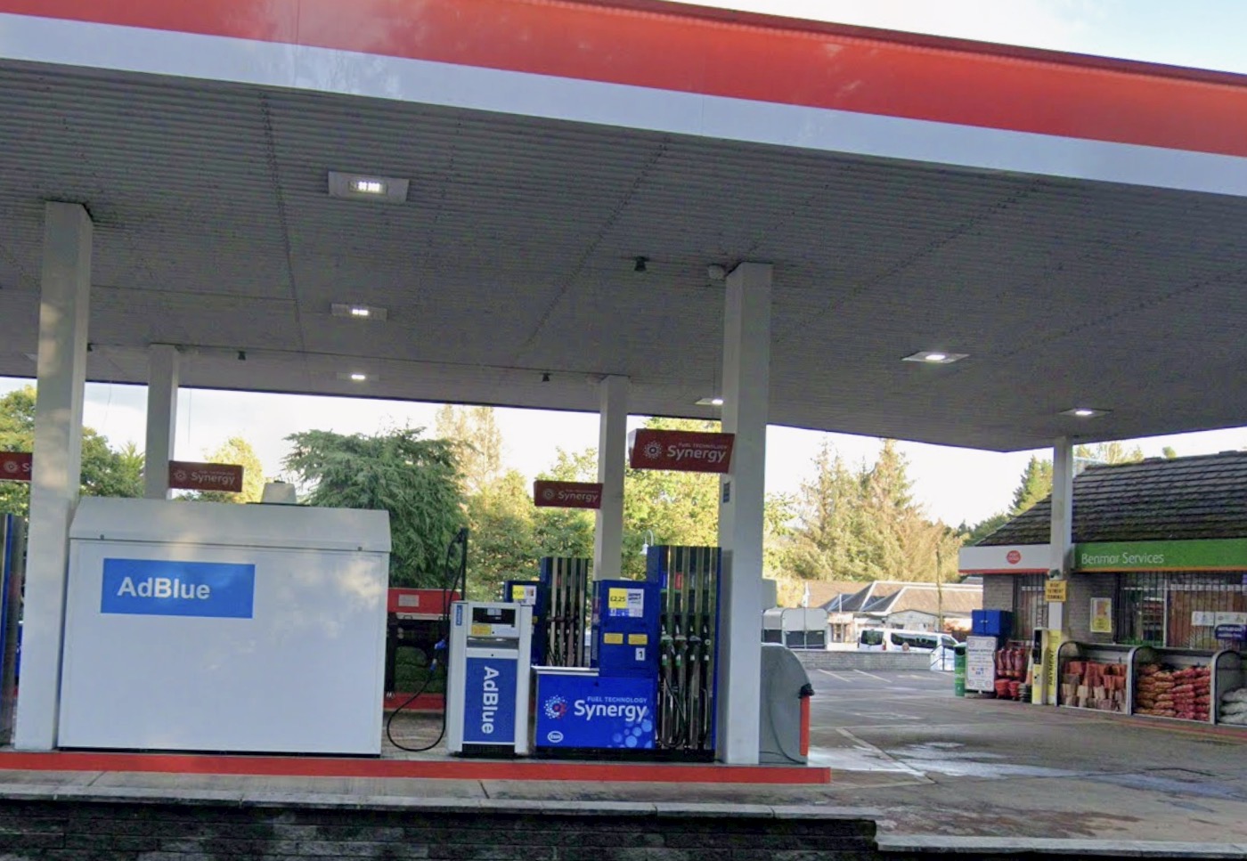

For last few years have used the pumps usually found along truck pumps at service stations.

Some forecourts have smaller vehicle AdBlue pumps and I top up when I see one, easier than getting tangled up with the HGVs.
