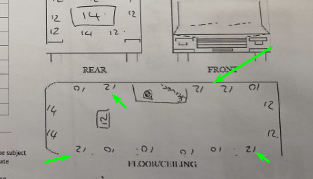

Ok so I am close to getting a new(er) van. Yesterday I spent two hours looking at one. A swift Esprit 496 with a luton cab of 2014 vintage. I struck kind of lucky as I am in contact with the previous owner (Van is at a dealers where he part ex'd it) so he has given me loads of impartial info. I think they were built with one shell so hopefully damp wont be too much of an issue. I will insist on a current hab check and damp test of course before parting with any cash. when looking at the van I came across the most recent hab check damp test from 2020. I googled the readings and nearly all of them are within acceptable good limits but there are one or two as far as I can make out are reading 21. Just wondered what peoples thoughts were on this.
The diagram at the bottom was the one I was concerned with but I cant really make out which parts of the van they are. According to the Caravan and Motorhome club site here https://www.caravanclub.co.uk/club-...l-tips-advice/motorhomes/damp-meter-readings/

Give me clue, where are the 21 readings ? My corncern apart from it’s a Swift would be it’s been very dry over the last 2 months with little rain so I would be concerned about any readings in the twenties.
That bottom diagram (see expanded pic below). That hab check was in the paperwork and as said was from two years ago.

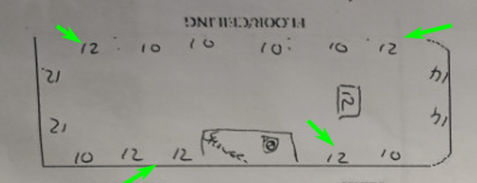

I think that the "21"s are actually "12"s upside down.
The clue is the word "shower"
Ah haaaaa! Spot the wildcamping genius that hasnt got a hangover like me today! :D
Well spotted. What I will do then is insist on a new check which I think they do before it goes out anyway. Six months warranty with this and I have a feeling there is a ten year Swift warranty possibly. Must look into that.
