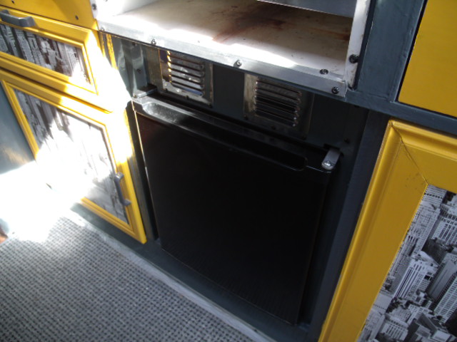

3 way old gas fridges are old hat, go small electric if you have solar and 200ah battery bank, mine works easy over 24 hrs without sunlight, never flattened a battery bank all year round, except lowish nov/dec and early jan.
