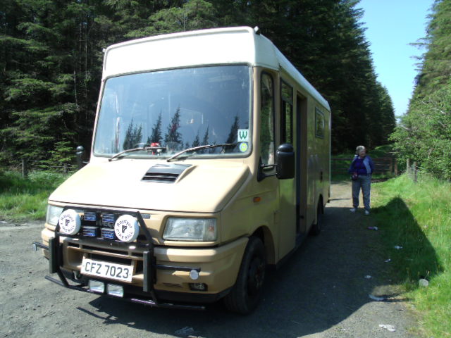

Best is fit a bull bar and load up big time. ;)

Best is fit a bull bar and load up big time. ;) View attachment 141131
