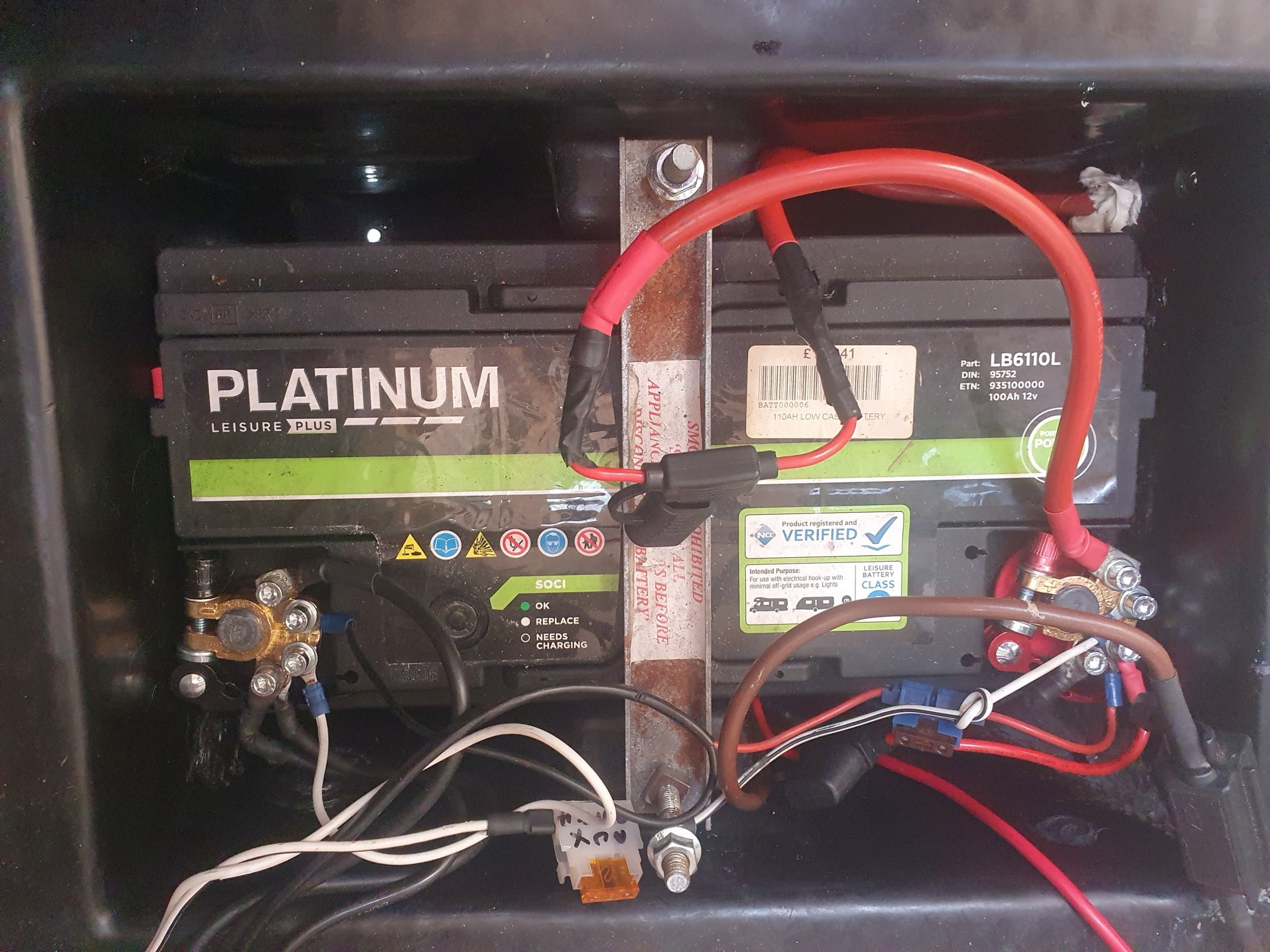

Thanks Trev, don't know how you managed to see it, 'cos I haven't posted any pics. Your probably right, though. But it wasn't a 5 year old, it was a 81 year old, who started rewiring motorbikes, in 1957.
The wireing job looks like a 5 year old did it, sorry but i have to say as i see.

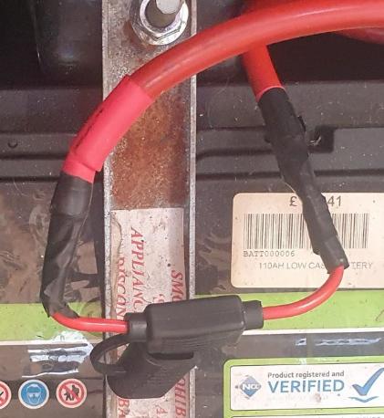

That was Kev's battery actually Trev and having seen it briefly I can confirm you're right, The original wiring is typical converters wiring and just OK but the later additions that Kev had done by a local team of chancers about 6 years ago was particularly poor including 16mm cable terminated with a few stands bodged into 6mm yellow crimps....and even that wasn't done properly and the terminal had fallen off😡.
Yep this bit for starters looks like a bodge.
It had to be seen to be believed, AND that was their SECOND go at it, besides not (apparently) knowing how to properly crimp wires.
Fortunately, the bloke has retired now.
