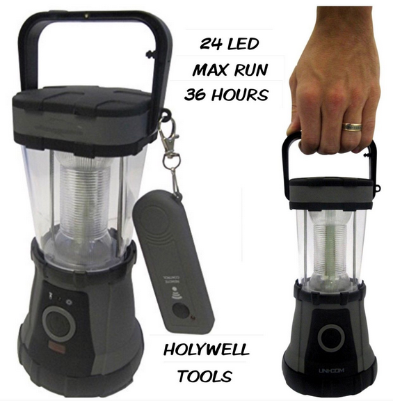

You can buy led remote control lanterns which can be charged via usb,if i could only remember where i seen them,old age creeping in.
This on ebay no 122989117848 at £13.99
