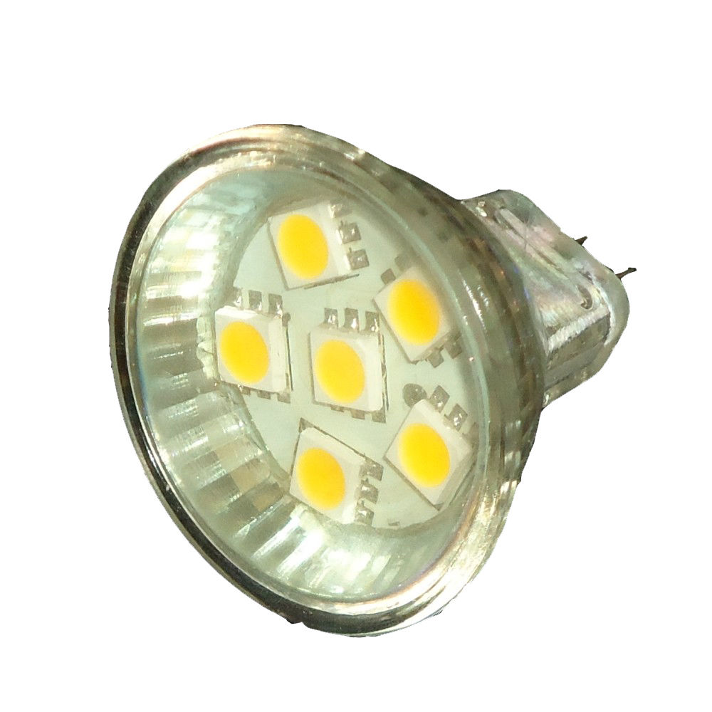

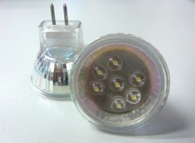

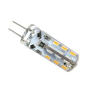

Hi all small problem,changing 4 no recessed spot lights, to led on a power saving mission.the led bulbs i need are called eye socket 35 mm across the glass end,with 2 pins at the plug in end, the face end is rather small,there the problem.i can get all sorts of bulbs with bigger faces ie the top where the light shines out.have been through my chap who services it elddis dealer,but he got the wrong ones twice.thanks for any help,or i might have to purchase complete led units there cheaper,the last try was £48 and thats just for bulbs which are wrong size anyway.an update on my plans/dreams that i posted after euro trip.easylift purchased and fitted 80kgs.scooter purchased not running or mot d yet,hope the weight not to much for elddis 115.hgv sat nav,sat,and solar will have to wait ran out of money,to many bills when we returned.anyway off to France Thursday week,for 2.5 weeks.where are we going,we dont know we just drive the house somewhere else.happy days all.micky
If you're still having trouble, try LED Bulbs 4U - Home - Led Bulbs 4 U
They're a small, father and son business who attend most motorhome shows. They've been incredibly helpful over the years at identifying awkward bulbs.

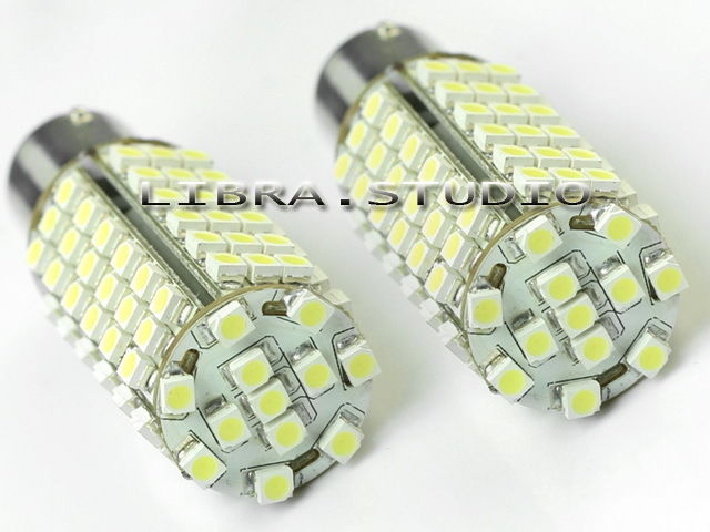

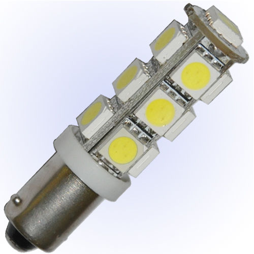

All available from ebay out of china soft or pure white,also do your tail/brake and front parking bulbs to as they use less power from alt and seldom blow

If you are buying led bulbs for a motorhome, don't buy 12v ones. The power supply is 11.5v to 14.4v. Generally, the bulbs will be getting 12.5v or more, even late into the evening. This will cause them.to fail very quickly.
It is pretty easy to get bulbs with a voltage stabiliser built in. They only cost a little extra, but last 100 times as long. They are usually sold as 8v to 30v or similar.
Alternatively, you can fit an inline voltage regulator to the lighting circuit or to the feed to each bulb, but that's a lot of hassle.
Most of the ones i got from china are rated 9v to 30v so ok for use lot.
