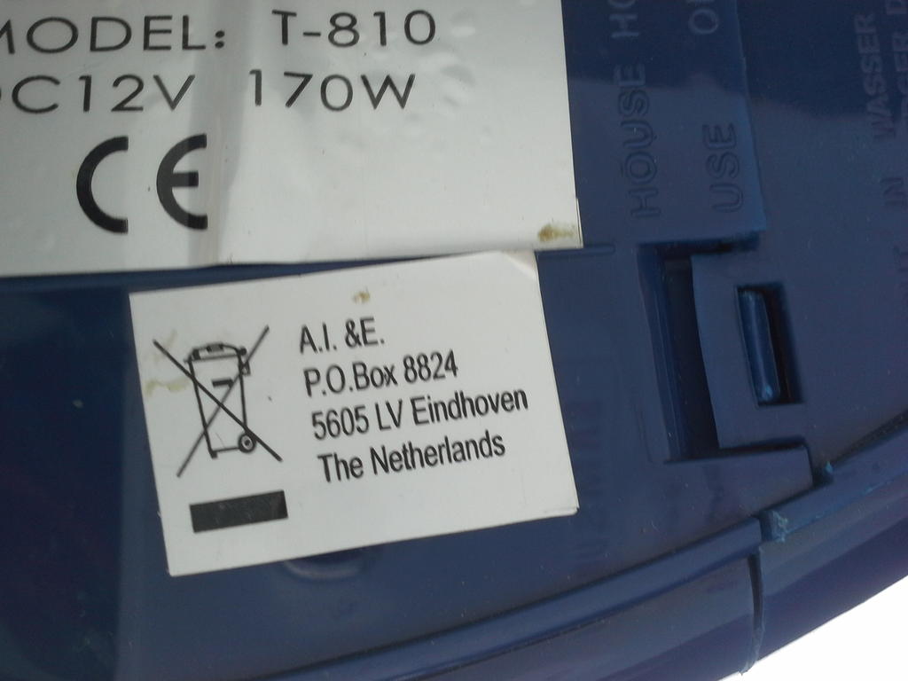

This 12 volt kettle boiling time off leisure battery 105 ah
Been on now 75 min taking 7.20 amps ( read from multimeter)
runing solar panel 100 w but it's not sunny and the battery voltage has dropped?
12.6v to 11.91
Is this right ?

Anything making heat is going to nail a battery.
Your current reading equated to around 90W, so that doesn't match the label. However, your kettle at home is to the order of 3000W, so IMO that's never going to be any good. It's probably loosing half of the heat to the surrounding air as well.
